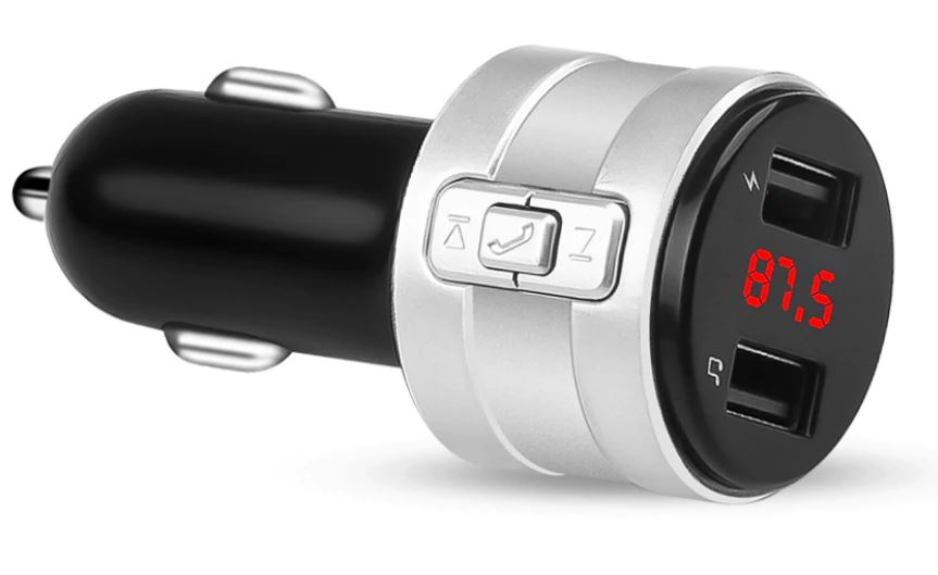

I'd rather add the little and cheap FM emitter plug in the cigaret lighter socket ...
BRs, Bernie

I personnaly find that solution is cheap and useful; does what it says (transmit music to ANY fm channel), isn't dedicated to ONE car, and even provide USB charging port !
So proposed it as a solution to the OP ... Though I must admit cost is very high: 2,19€, free delivery !!

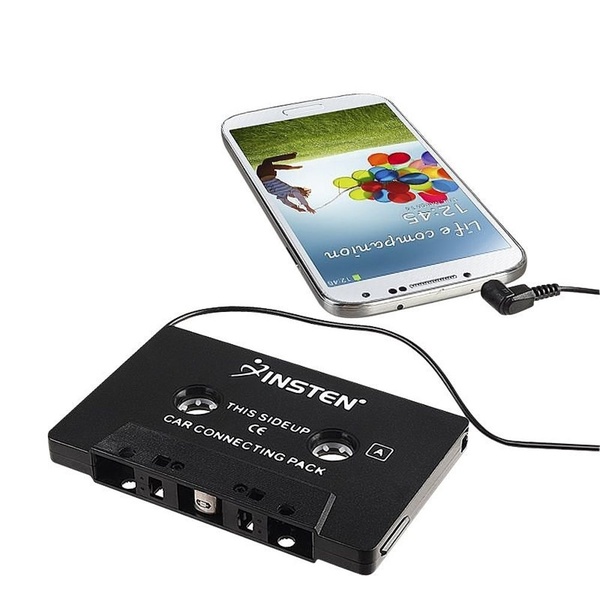

And for those who don't have a cigaret lighter plug but get an older (radio) car, here's what they'd need ...
BRs, Bernie
