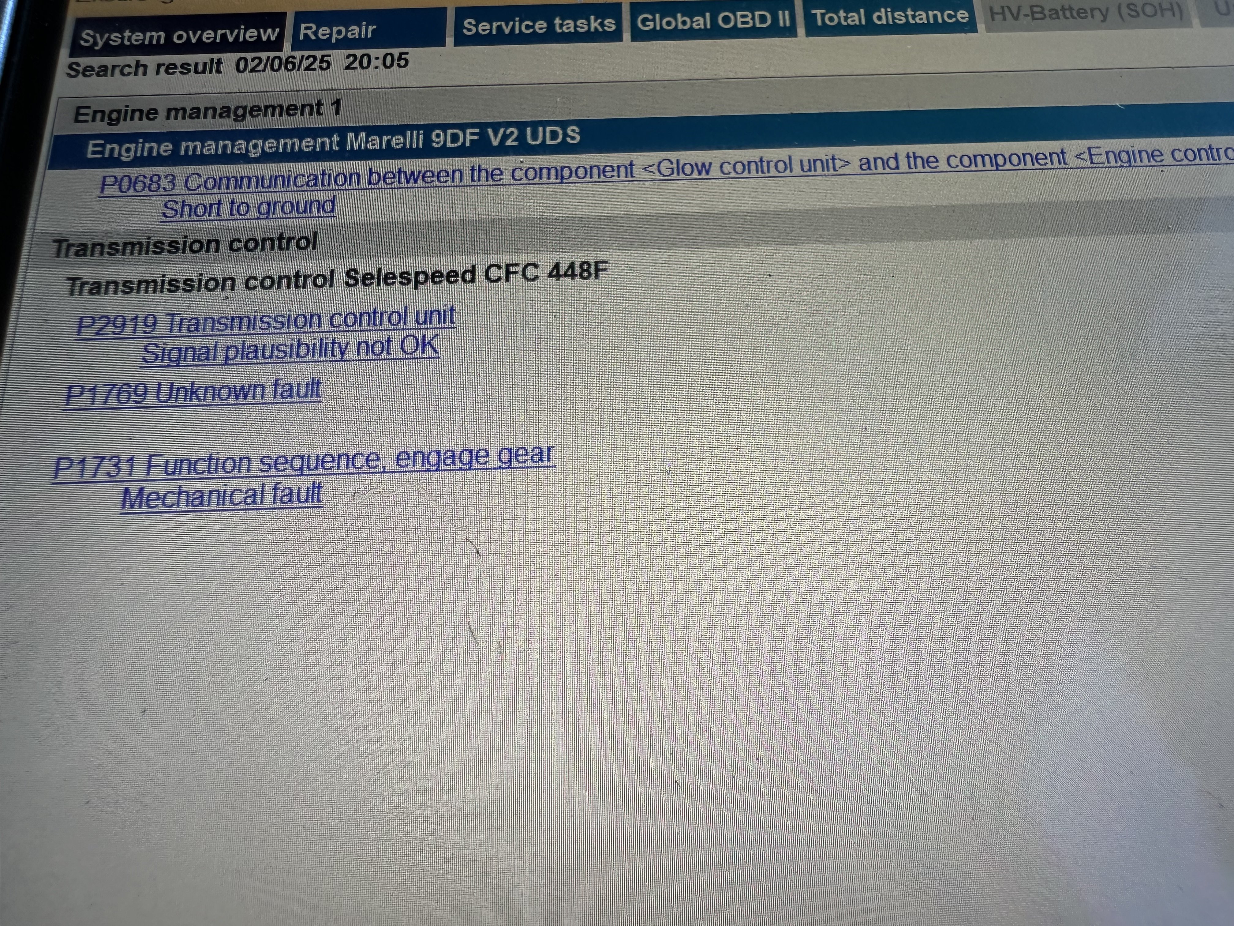

Sorry I had other issues but I think glowplugs error were from faulty wire connections when taking out the Ghost Immobiliser I never had the code before and couldn’t clear it. Ghost immobilisers I think was installed correctly and they used the Traction Control button as a key which started off giving me problems -long story hence it’s removal.

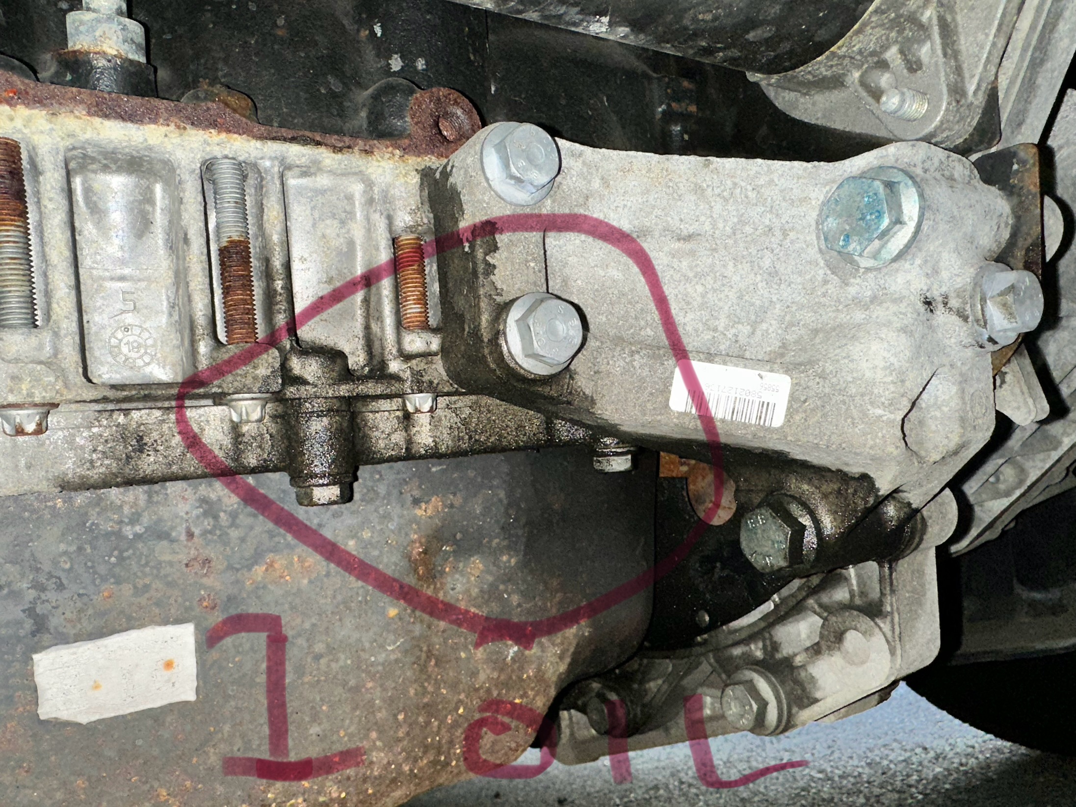

The auto box just gave up suddenly and I couldn’t select gears when starting up. Hence sad journey to Fiat. there was some fresh oil around the gearbox when you looked under the van he found whilst checking the earth cable -plus it’s very rusty too? as don’t have a middle section tray fitted either.

That's scary for a 2022 Ducato, is it the 9 speed auto, shouldn't be getting any problems like that on a 3 year old vehicle, any major problems on mine it will go bye bye, worse than owning a yacht.

Judging by your readout, that looks like a bad accumulator.
A simple test is to use one of the colored adapters for your elm327, I think the yellow one, and relearn the functions.
Id suggest using alfaobd as its much better with those control units. where multiecuscan does batch commands copied or sniffed from the very old fiat emulator software, alfaobd actually lets you do each step and confirm that it is indeed what you think it is.
multiecuscan does not allow for relearning of the clutch switch but at least you can test the capabilities of your accumulator and graph it.
