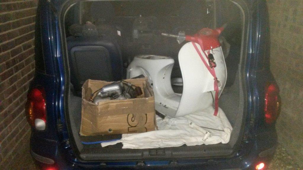

In other news, Glopsy has this week been on scooter moving duties, as my wifes 1962 Vespa VNB150 has been shipped off to where she works so that the guys in the workshop can have a go at pushing the project along.
As you can see it fitted in a treat once a couple of the seats were removed and is now tucked in a corner of the engineering workshop awaiting it's turn, although I'm in no rush as I took it to pieces over 5 years ago ;)

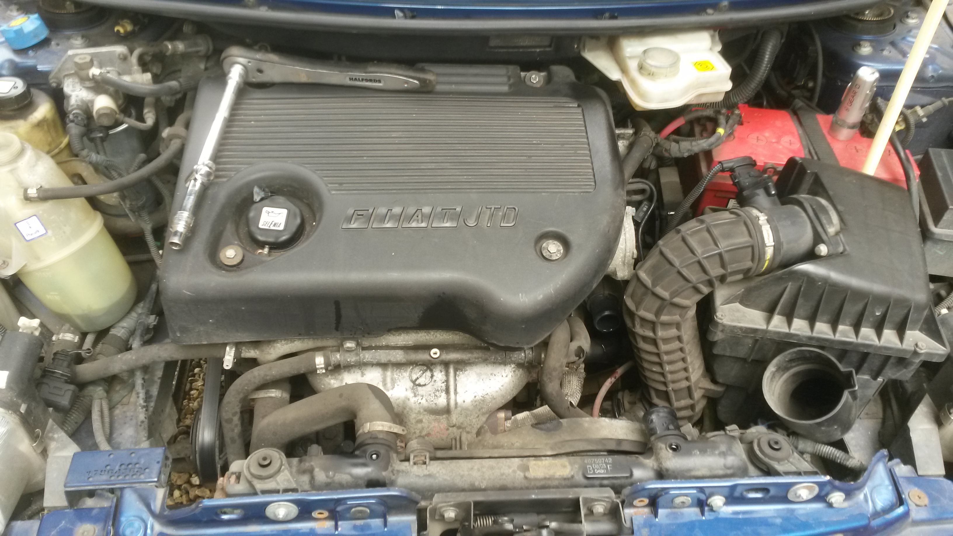

Next up was a coolant change, with the addition of an in line thermostat ( put in top rad hose) which is an old Alfa Romeo JTD bodge due to the hassle and expense of changing the stuck open thermostat.
This has resulted in Glopsy now running at the correct 4 bars and chucking out an awful lot more heat into the cabin than she ever used to manage.

Hopefully managed to get the pics to upload today. The thermostat I used was for a Renault Espace,costing less than £10 posted and was a snug fit inside the pipe.

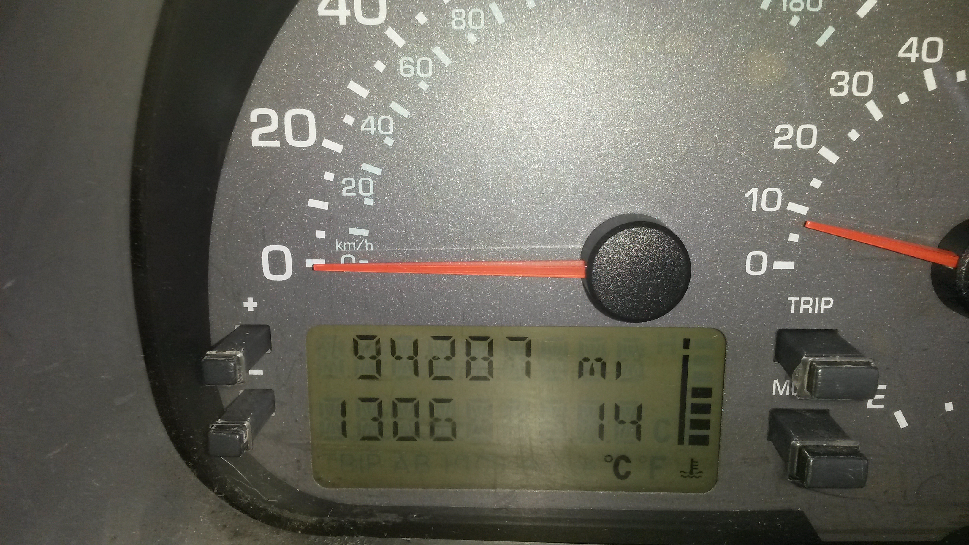

Glopsy now comes up to temp much quicker and stays on 3 or 4 bars all day.

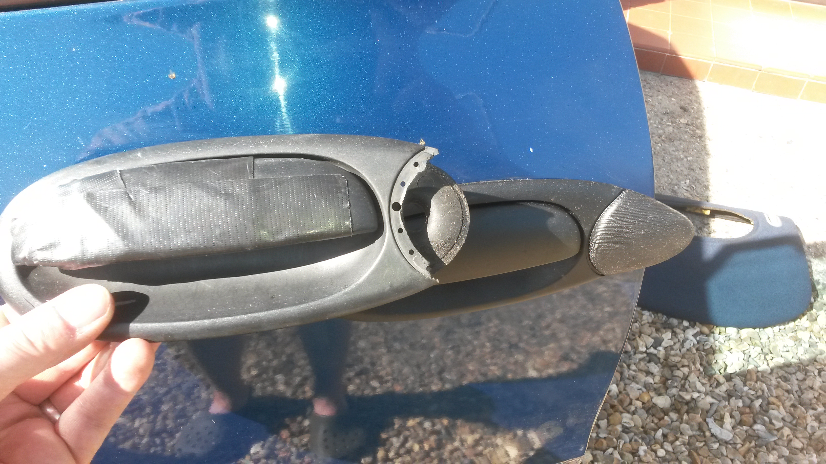

Glopsy has now done 95000 miles and to celebrate this milestone I treated her to an oil/filter change as well as new air and cabin filters. It was all going well until I reversed her of my ramps into the neighbours brick wall, breaking the n/s rear door handle ? If anyone has got one for sale,do let me know as well as any info on actually changing it.

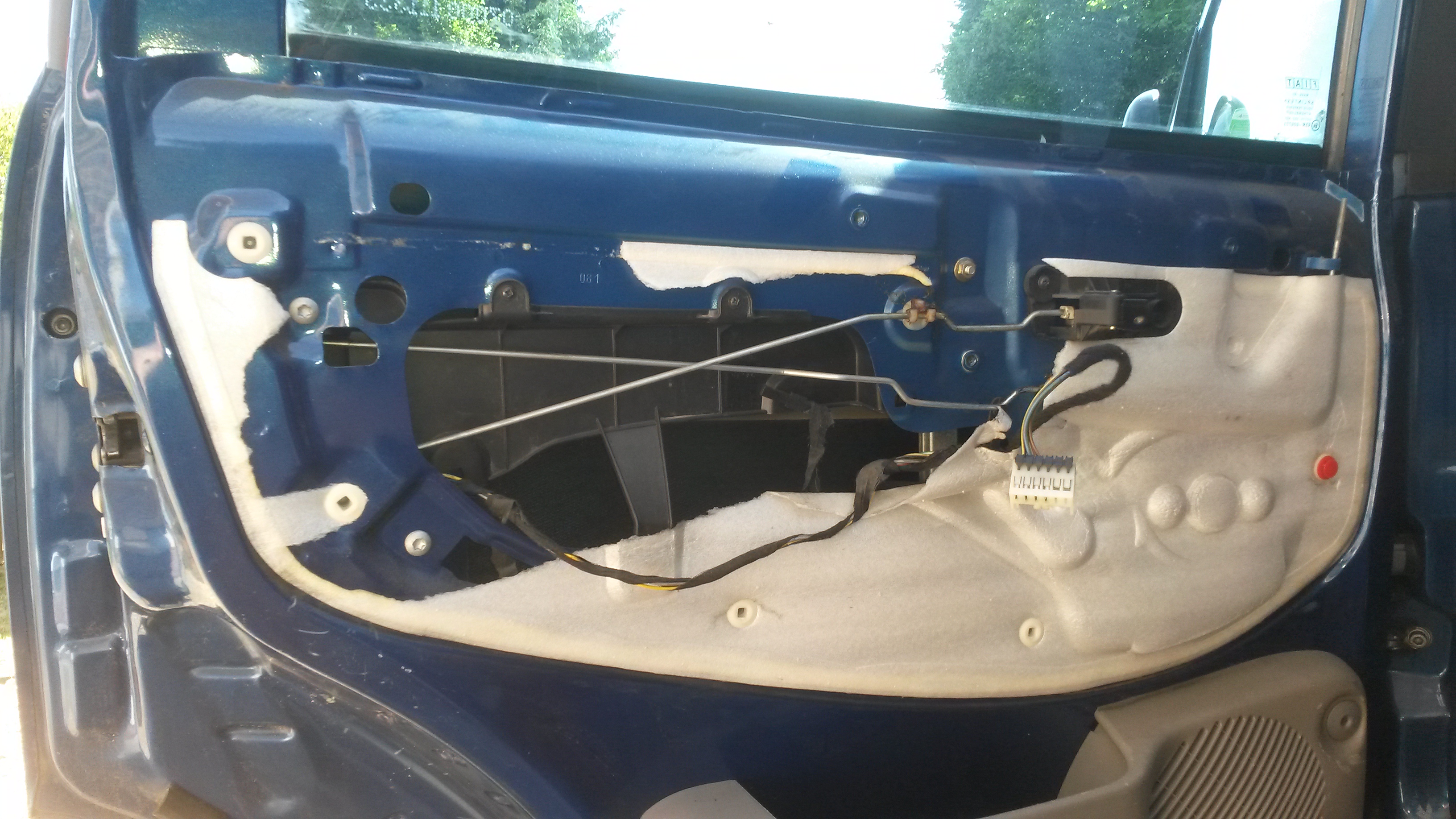

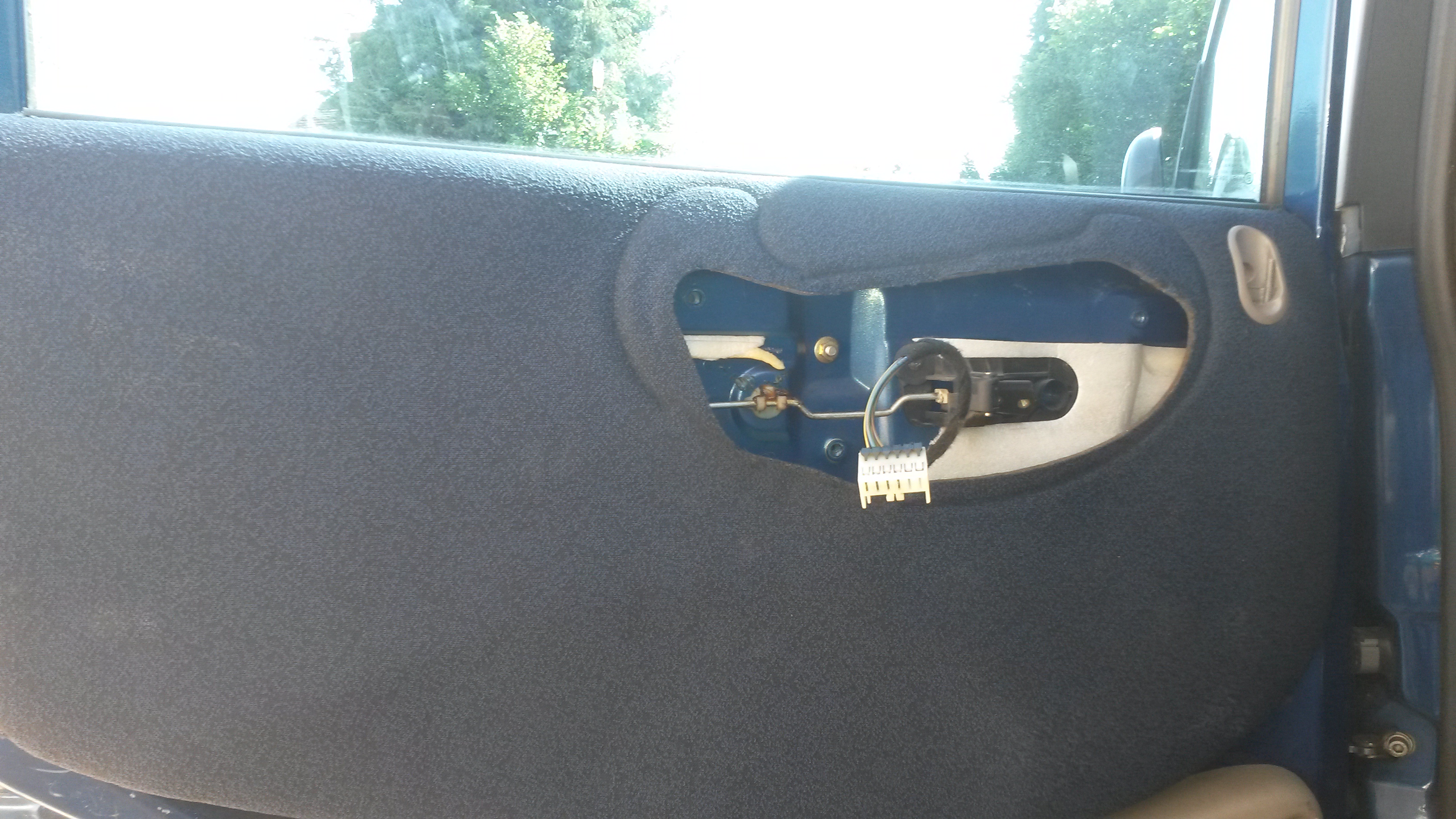

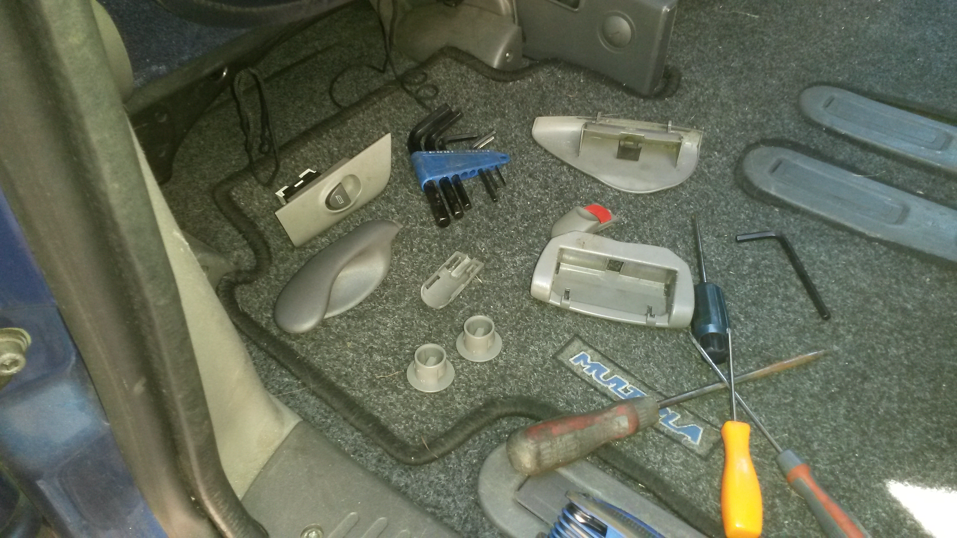

Many thanks again to Widemouthfrog for spotting a great deal on a brand new rear door handle , which duly arrived and then got fitted.
I followed the advice from WMF and Jackwhoo and even though Fiat decided that you need 4 different sizes of allen key for the job, the replacement is actually quite easy. One of the allen bolts holding the handle to the door has to be tackled blind, but access isn't too bad
Having taken the door card off it was apparent that someone in the past had been there before, as the membrane was half missing, but to be honest that just saved me the task :)
The tip for removing the door lock pull is to prise out the red bit as that's what locks the thread to the metal rod
