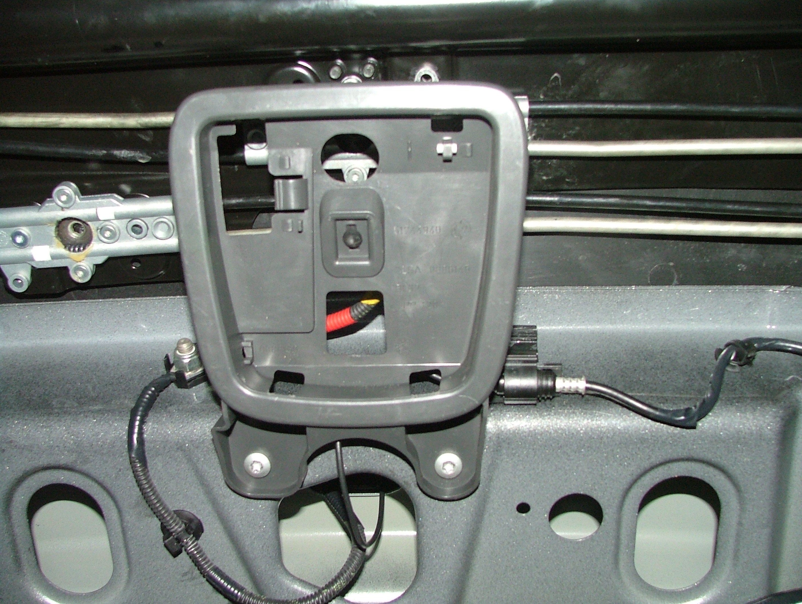

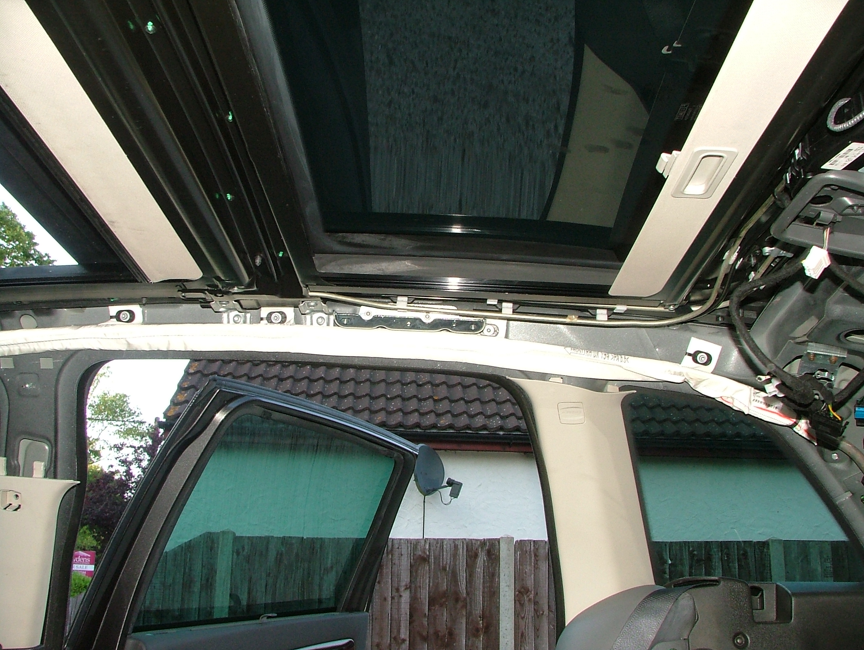

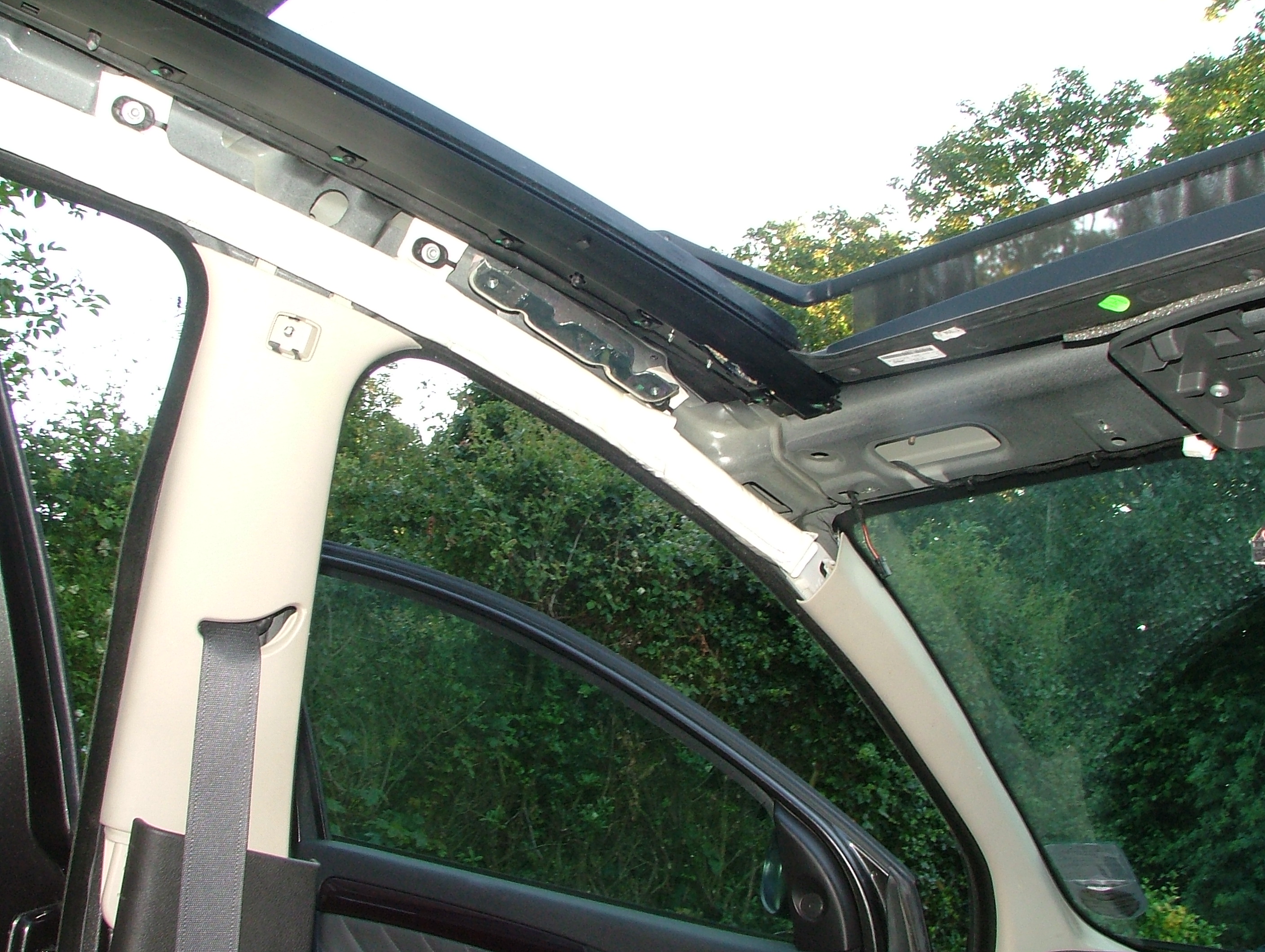

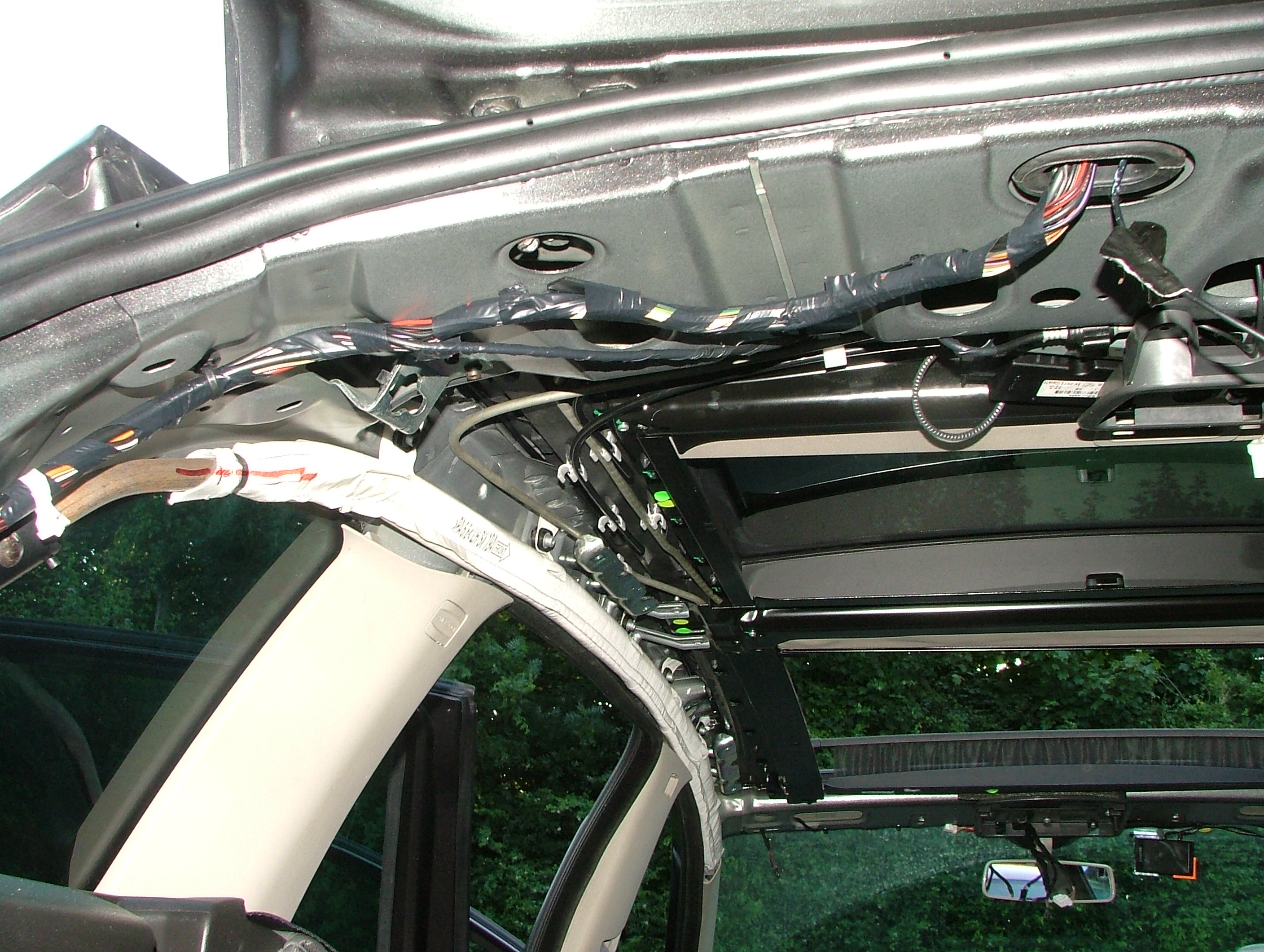

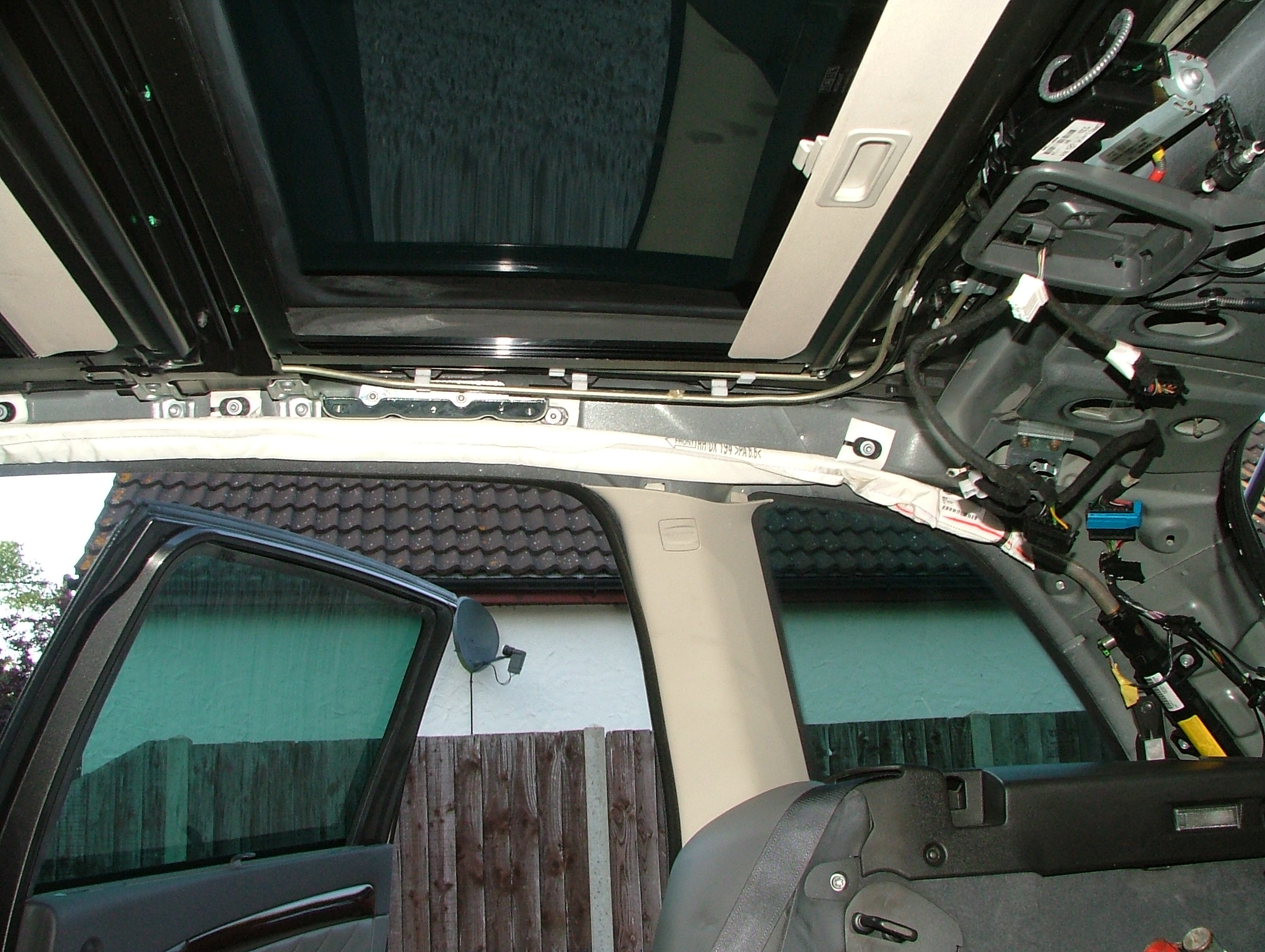

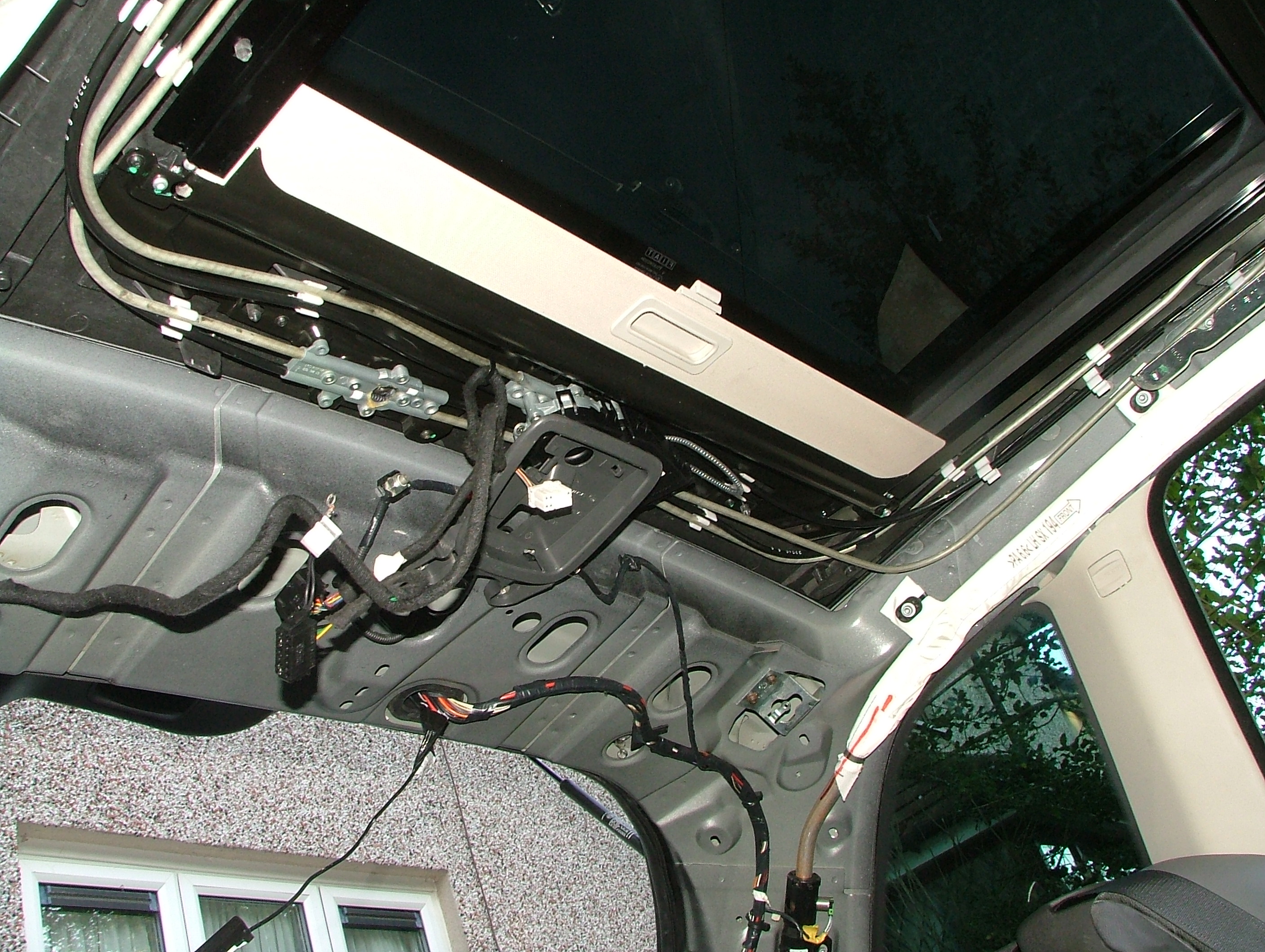

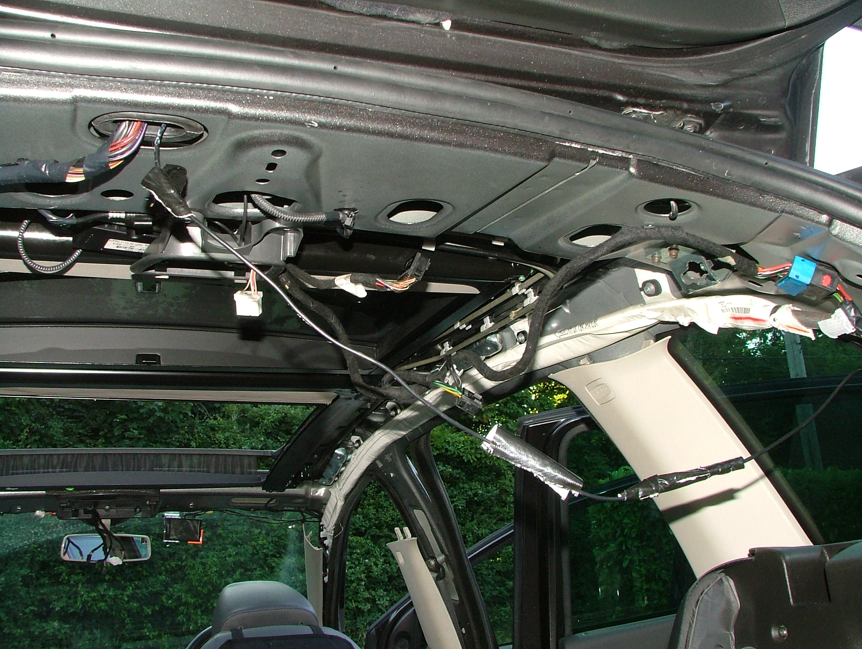

Am i going to have to remove all the roof lining? i tried with just the back hanging down and plastic behind the light removed but cant see a lot apart from 1 motor and 2 disconnected plugs

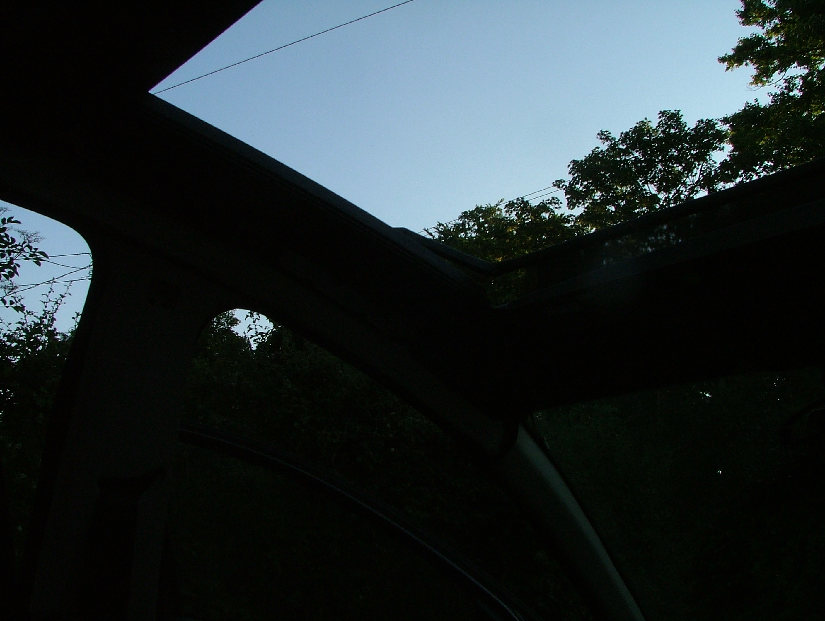

I removed roof lining removed motor that has never been connected since i got the car. (motor has webasto written on it) roof still would now push open and a little closed then got stuck, i removed the metal tubes that hold the opening and closing wire, it seemed one was twisted and wouldn't go back into its tube, so i cut it it off roof is now shut, looks like it will stay tiger sealed for ever now.
If any one is wondering what under the roof lining looks like here are some photos.
this is the plastic bit under the rear interior roof light, the motor was under that, the round hole is where the key or male hex goes to open an close manually (when the motor is in.
the bit i cut off
