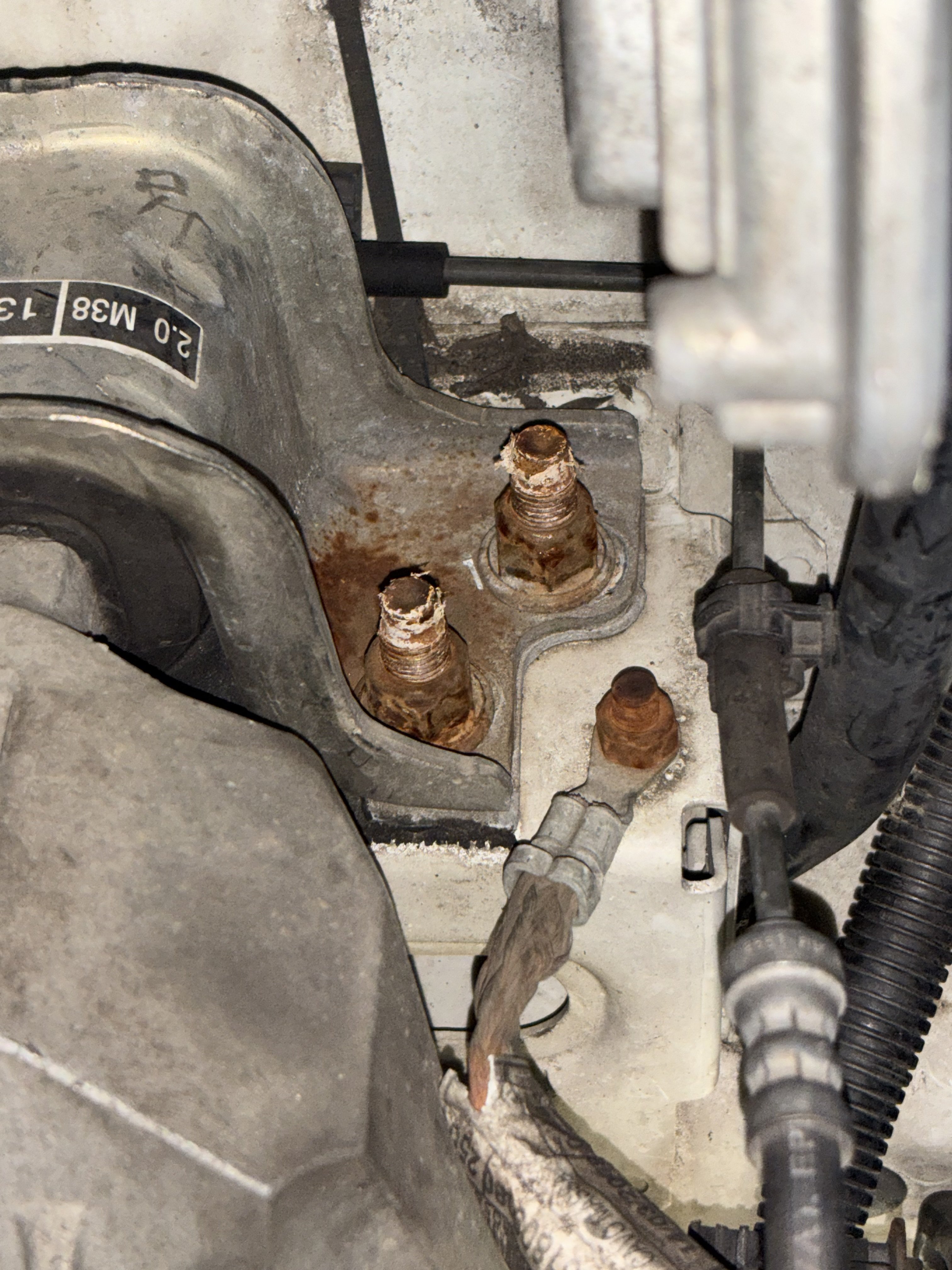

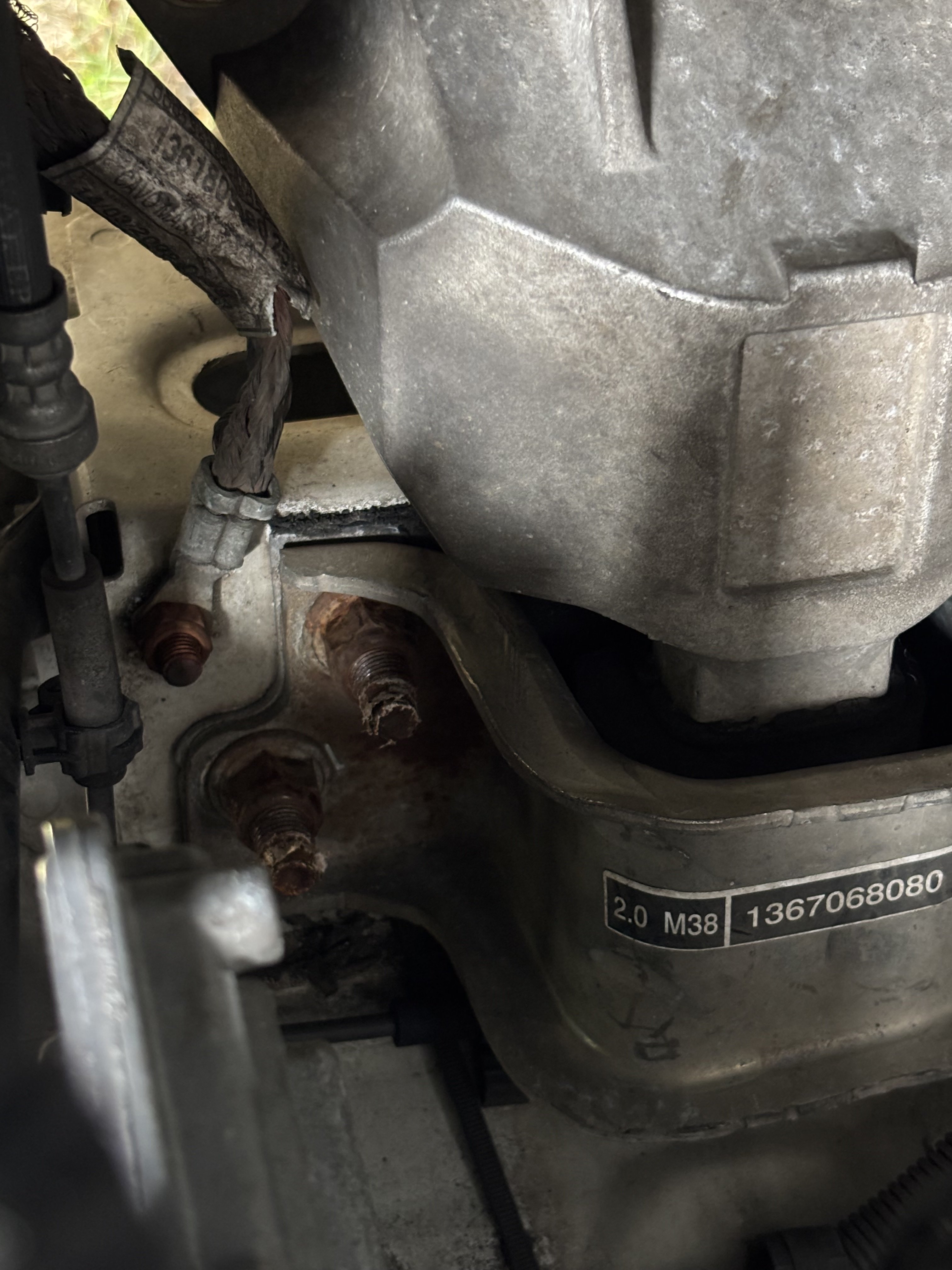

Quick update in between. Scuttle tray and pipe seems good but noticed these rusty bolts and cables. Not too experienced so maybe you guys know what this is and whether it could have cause my issues?
Drivers side, below fuse box.

Picture 1 - your under bonnet earth braided cable. All connections need cleaning back to bright metal and preferably the cable changed to something sheathed and larger in cross section if possible.
The whole current path needs to be unobstructed in its flow around the circuit otherwise the voltage and current reduces - in another term it’s like your own heart if the arteries are blocked the blood supply to the heart is insufficient…it’s the same with vehicle electrical circuits.
So this element is one portion of a circuit. Clean this then see what improvements if any. If none then move onwards through the wiring checking for corrosion at the fuse box and ecu connections, breaks in cables for the under bonnet loom.
