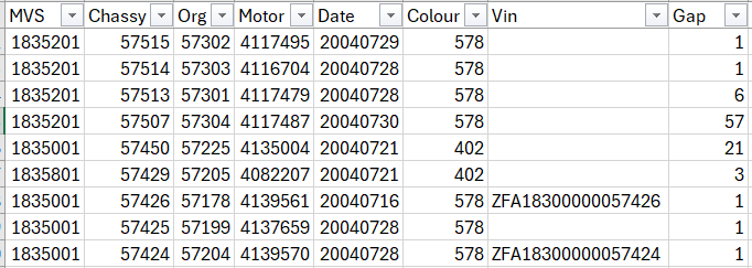

New member @AramisTG was curious as to why his, new to him, B wasn't being found in ePer. Concerned that there was a problem in openPer I dug into it and also checked official v84 ePer. Sure enough, no record of his VIN (I've seen a photo of his VIN plate - he's definitely not fibbing!). Being both bored and in possession of the underlying data I thought I'd scan to see how many gaps we have in the records of Bs working on the assumption that the VIN numbers would be used sequentially. Sure enough, they mostly go up in sequence with the odd entry missing but then we get a run between numbers 57426 and 57513 which only has three vehicles in it meaning that there are a possible 85 'ghost cars'. Without giving his VIN away the new member's car is one of these. Build dates for the vehicles close to this range are in July 2004.

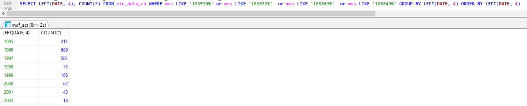

Looking at the ePer MVS table there are four models that are probably, given the name, for the Japanese market:
I then had a look at the production by year for the Japanese B's and we see that there are none recorded after 2002. Correlation may not be causation but wasn't that the year production switched from Maggiore to FIAT themselves?

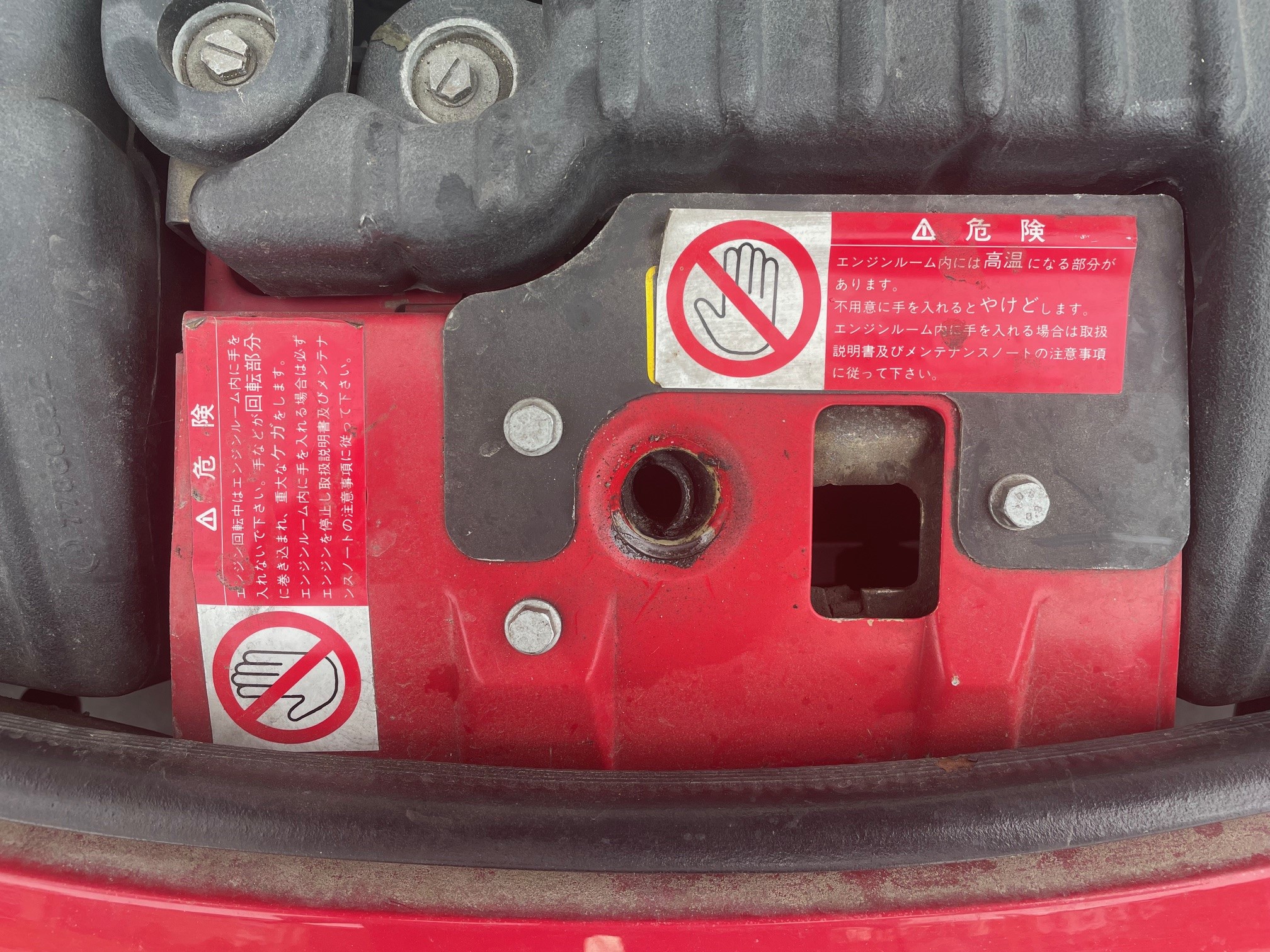

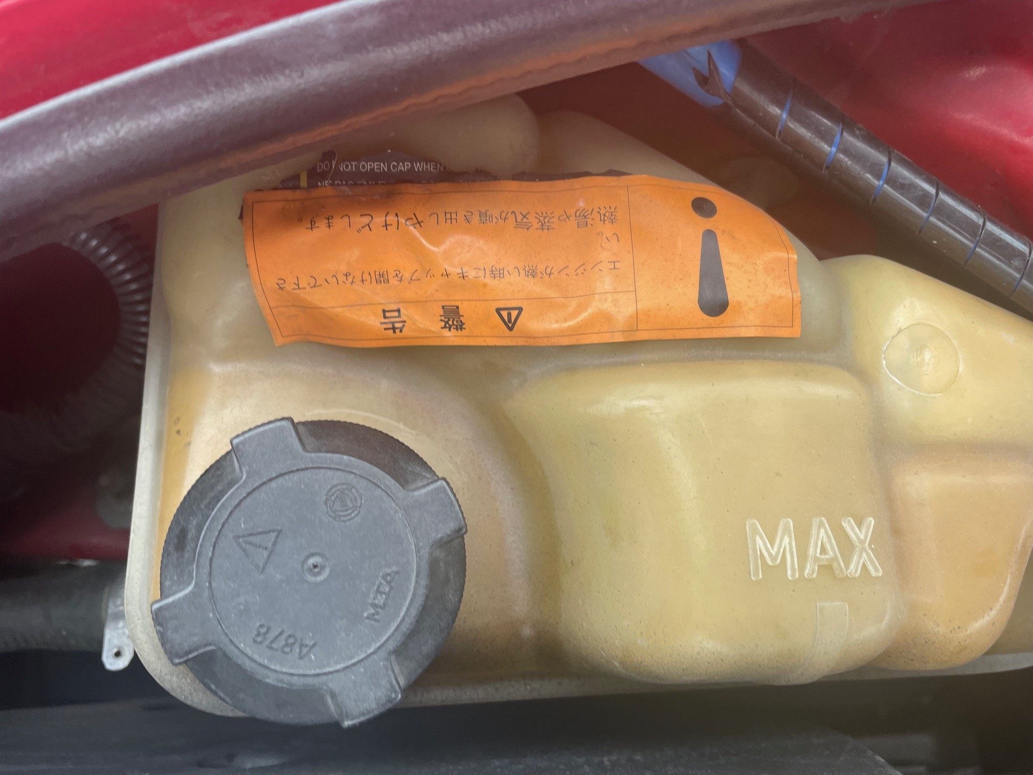

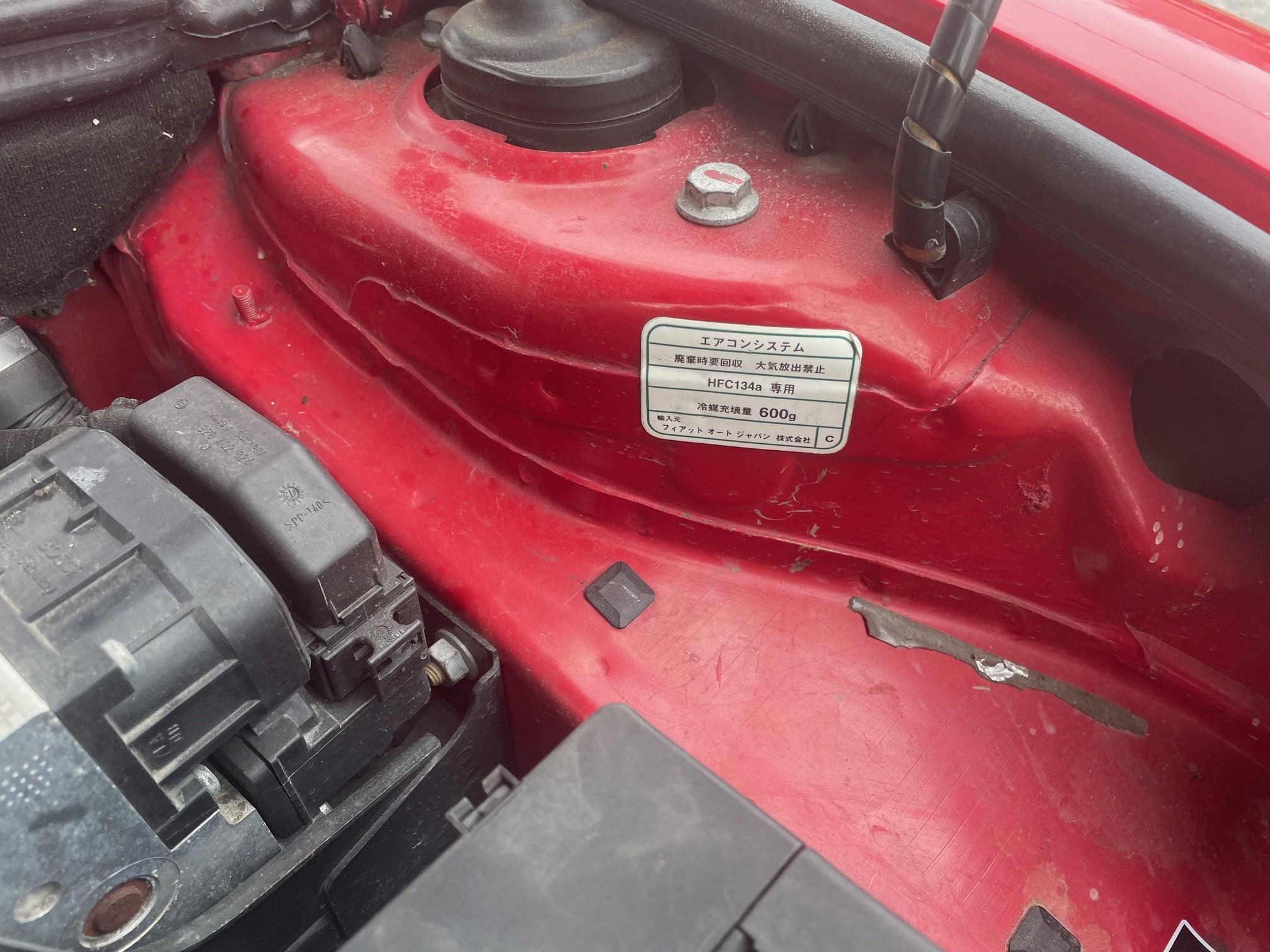

Yes, most of my engine compartment labels are in Japanese/Kanji. But not all!
See below for examples:
Front Radiator Labels:
Passenger Side Coolant Label:
Driver Side Shock Tower Label:

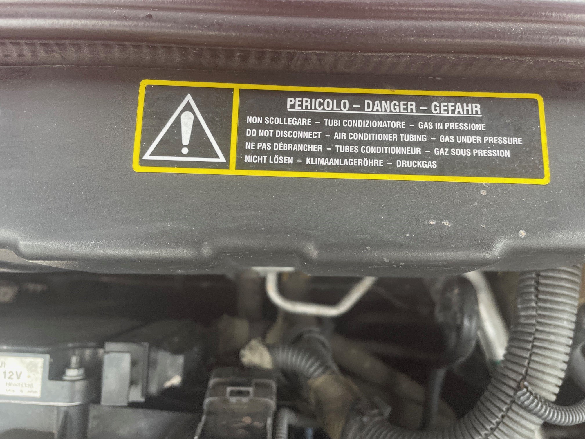

Then we get this one, which is in the 4 languages (Firewall AC Label) ... ??
I appreciate that you guys love a good puzzle and are interested enough to respond and offer insight! I'd love to get to the bottom of it eventually.

I just noticed on the Coolant label that there is English underneath it. Maybe Japanese labels were just put overtop when it hit Japan for export?

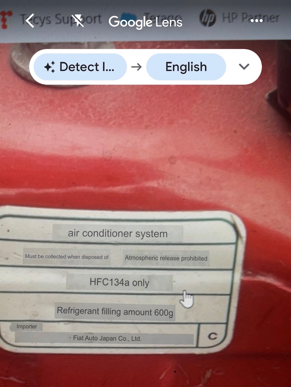

I can, in fact, confirm that Japanese/Kanji labels were placed over the original 4 language warning labels. I suspect you are correct that when the car hit the docks in Japan for export, it got 'converted' to local standards.
See below:
I'll have to get my heat gun out to warm the labels up and carefully remove them. I'd like the original labels that I can read, but also want to reattach the Japanese labels beside them. for posterity sake (a can of spray adhesive should suffice for re-attachment).
