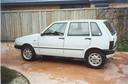

Attached is a pic of perhaps my favourite car ever, my old Uno 60 (bought on Trademe September 2000 for $11). I was 20 at the time. As you can see, I gave it a cheap respray in a rather matt white ('toothpaste white') lacquer. In the pic it is wearing Lancia Beta alloy wheels (I think they were $150 for the set) with 185/60/14 tyres.
It's important to note some decidedly-Chavish features :)
- Exhaust tip (for the extra 5bhp)
- Wipers painted metallic blue (with blue silicone blade that doesn't work as well as a rubber blade)
- Instrument cluster top painted metallic blue, shiny so that it reflects in the windscreen
- Rear light lenses painted inside with black vinyl paint - makes the lights too dim to see in the sunlight, so it's all good!
The features you don't see are perhaps more exciting:
- Worn gearbox internals (probably partly-busted synchro) meaning a strange soggy feeling with going from third to fourth
- Camshaft change to 128 Coupe cam (for a REAL extra 5bhp)
- Wire netting-and-filler repair to the 5cm hole in the left roof rail, above the door
- New piston rings - to avoid that smoky tang
-Alex
