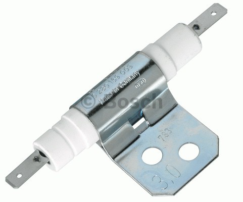

I don't have spi but my bet goes for faulty injector pre-resistor
See attached shematic, item no.23
Available from ebay (no. 23087783525)

I don't know mate - I would say do not bypass it.
Key thing is to get the idea of the resistance value of the fully working one. Big punched 3.0 number for me is the resistor value but is it 3Ohm or 3kOhm ...?
RS, Farnell or Maplin should have 3.0kOhm or 3.0 Ohn porcelein hightpower (I recon max 10W) resistors like that.
