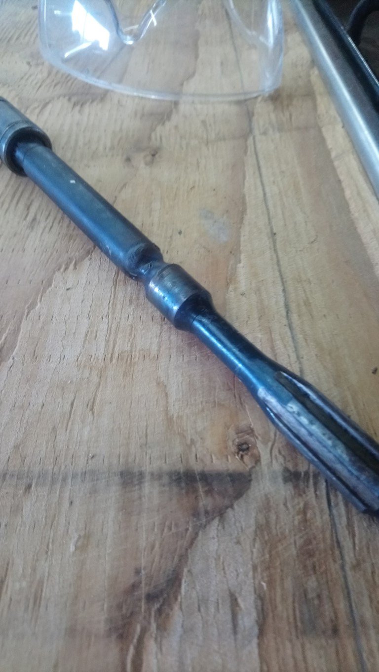

Well so we did this anyway, bored the big shaft, press(hammer) fitted the very interference shafts, used a hot/cold method, welded and annealed. So far so good. Done about 30-40km with no evidence of issues. I do actually have a lot of spares (like 3 x 2 bolt bell-housings) but they are in NZ.. feel free to arrange a trip out :)
