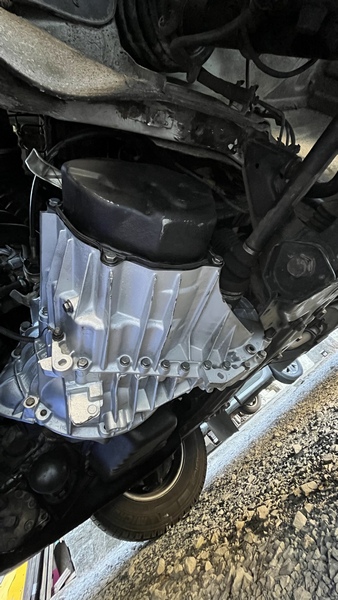

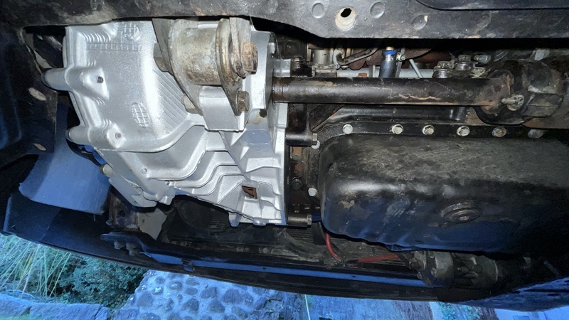

Some news of my gear box, in december the garage take off the gear box , send it to a gearbox workshop to rebuilt it "as new" then the garage refit gear box , works have two years warranty (cost was 2.2Keuros) After driving 800 km I always get the same issue with the 4th gear which not desengage 1 time on 2 ...... Next week garage will take off again the gearbox & re send it to workshop. Workshop told to the garage that this can happen on this modele of gear box & is not more surprised than that.......? But nobody told me what is the exact issue, just it come from 4th gear synchro...... Outside of crankcase is nice , but.....
In the old days when we rebuilt gearboxes, they stayed rebuilt.
That was just a normal garage, not a "gearbox specialist".
