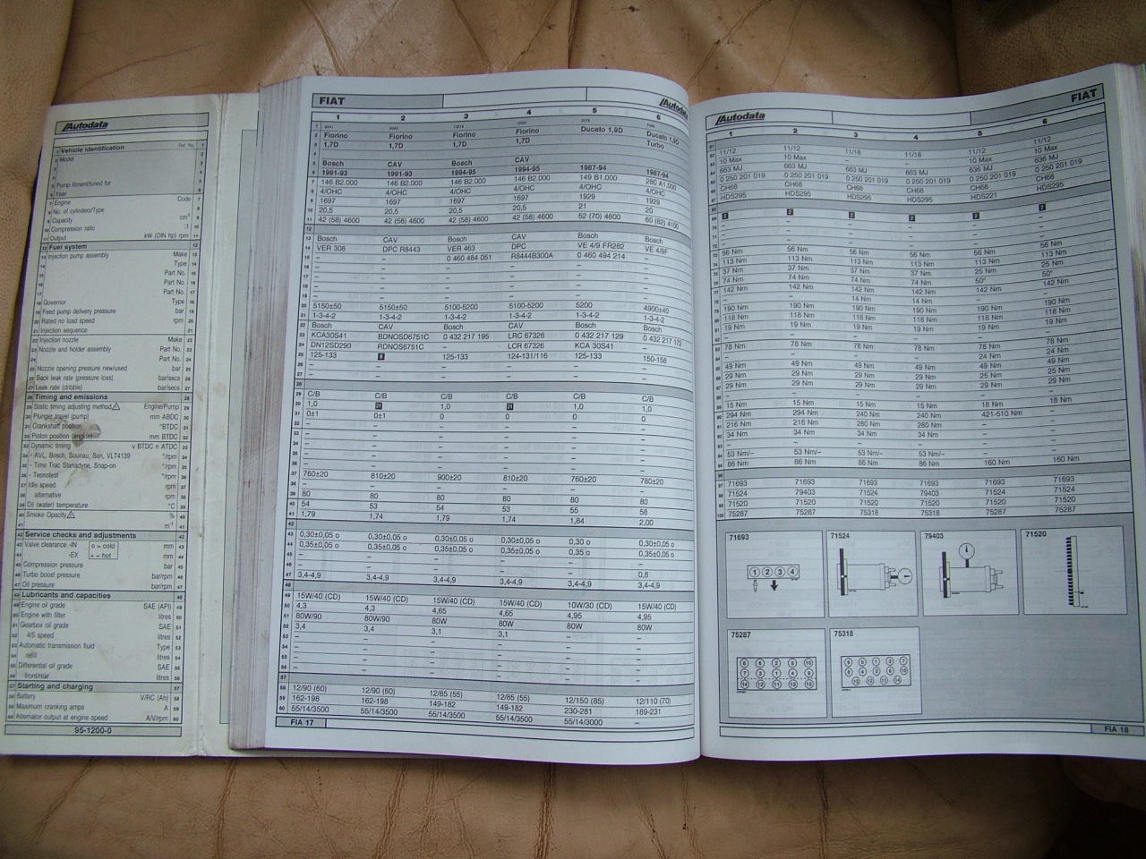

Does sound like worn syncro cones as you say, basically if change gear slowly it's OK , but "racing gear changes" it grates? Due to beating the Syncro clutches trying to match the gear speeds together.
Check this data against your engine Series, it seems to indicate 80W grade which is fairly thick anyway.
This manual is all I could find and is from 1995, but only lists the 1.9 up to 1994?
cheers bugsymike, less than 2 years ago, i had the 2nd gear syncro changed and my research, at that time, said to use 75w90 full synthetic. the garage were happy with this. now, in order to avoid great expense, i've decided to change the oil to an 80w90 mineral. i'm going to ask the garage to catch the removed oil so that i can use it again if my bodge doesn't work. the old girl is 27 years old so, maybe, a slightly thicker oil will do the trick. failing that, gearbox out and repair. cheers, ian.
