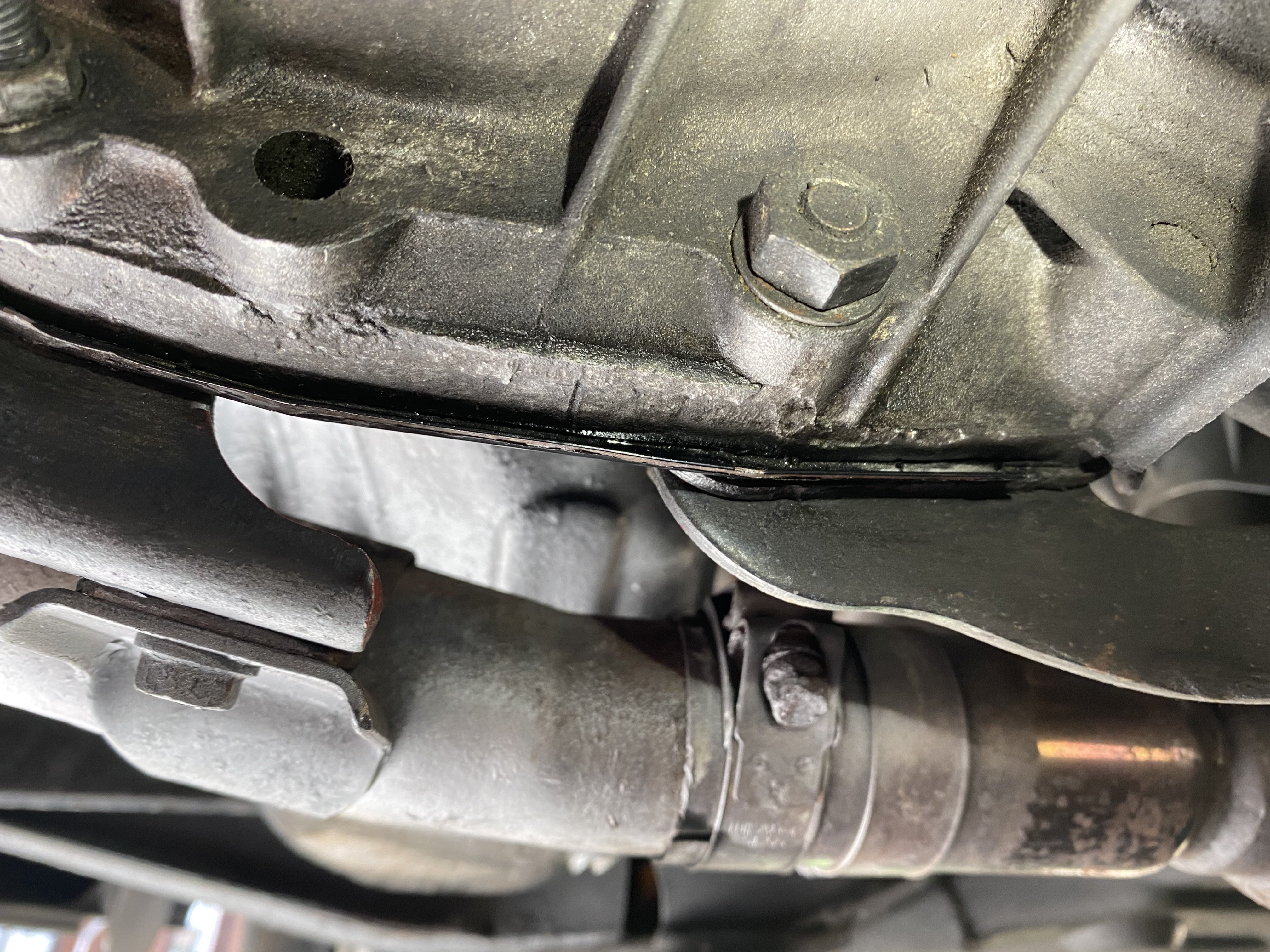

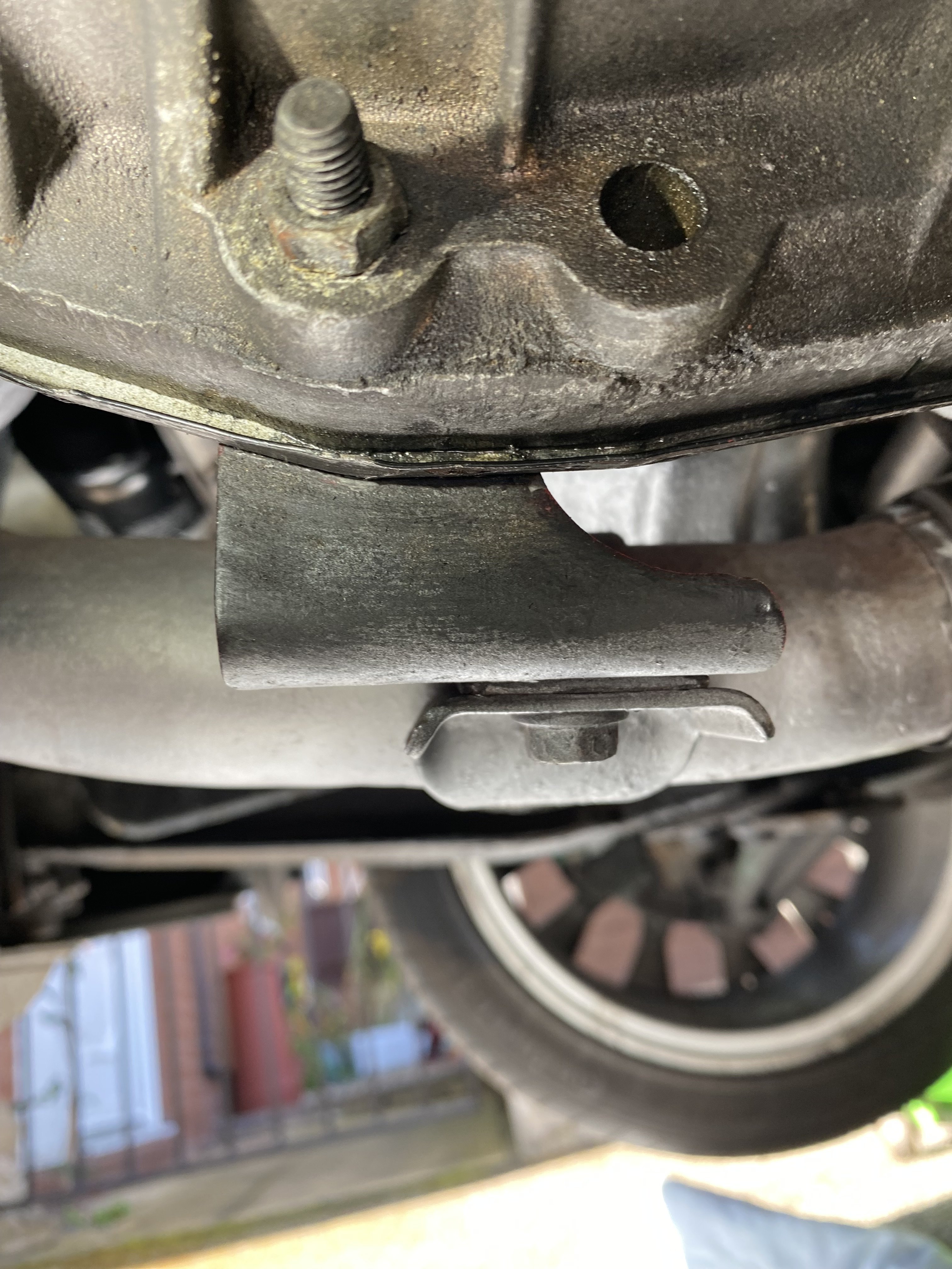

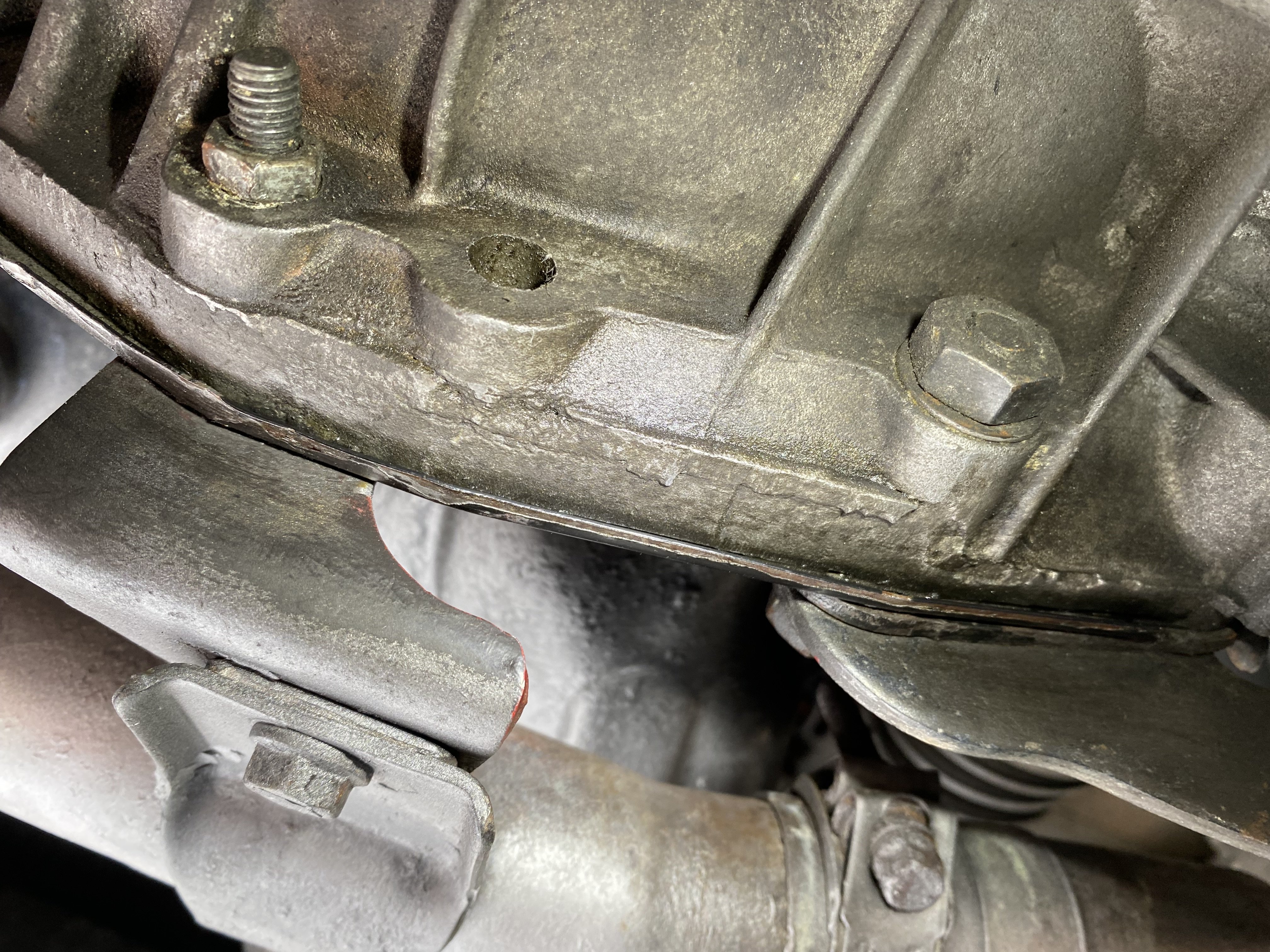

So oil change yesterday…. And I decided to change the gearbox oil too as it’s been a while
While I was under there my heart sank … I see signs of a weep .. collecting in the lip of the flywheel inspection cover right at the bottom
Gave it a good wipe was very dirty but didn’t smell like oil … stupidly I didn’t investigate further so I’m getting under the car again tomorrow…
I’ve since shone a torch in that area I can definitely see signs of glistening liquid
Do we think crankshaft oil seal!? If it turns out to be a weep of gearbox liquid it will be a recon gearbox new seal a new clutch and more new oil!
Am I missing anything? I need to gather my parts and don’t want to forget anything else!!!

Although it’s hard to see .. I did loosen the inspection cover enough to tell its oil … so it’s a gearbox out job … just bought a clutch crank seal and it will be a recon gearbox… going to replace the lower mount too … Pah going to be skint 😑

It does look to be oil. You have to identify if it's engine or gearbox. For the engine oil leakage you have to start the inspection from the upper parts of the engine, the Cylinder Head, going downwards. Because the oil is dripping and even if you identified that spot in the pictures, the source could be on top of the engine, starting with CH cover.
I can see signs of fresh engine oil from under the throttle body but it does not appear to be on the top of the bellhousing ….. will have to investigate further tomorrow…… the ch cover looks fine from what I can see!
It could be I have 2 leaks 😂 either way my clutch is contaminated……
It looks like I have a leak from the rocker the gasket has obviously failed! On the right hand side too! The plot thickens!
probably be best to change the rocker box gasket and clean everything you can see or get access to, then run her for a while and see if the problem re-occurs dont want to do a lot of work if not needed eh!.
