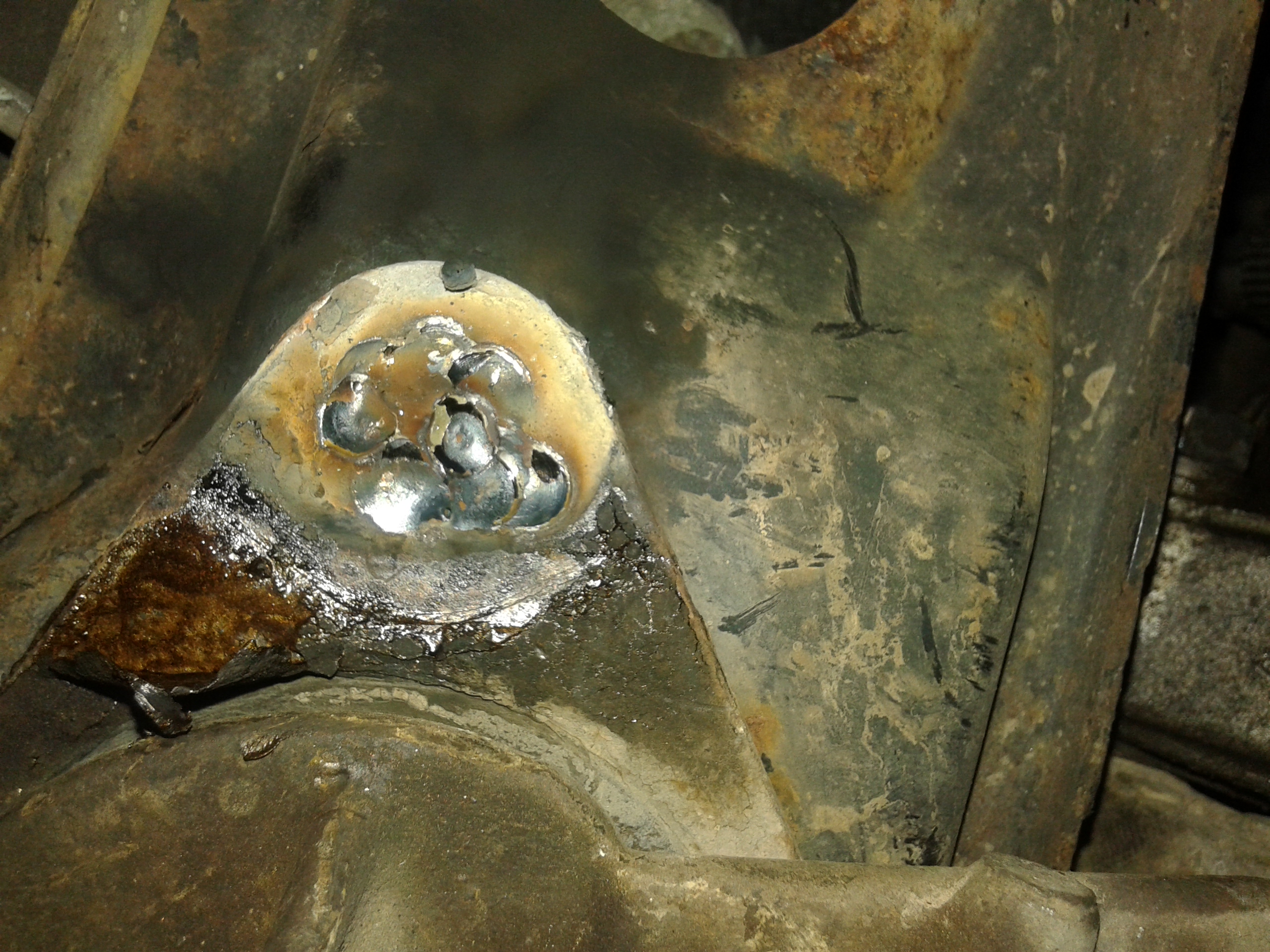

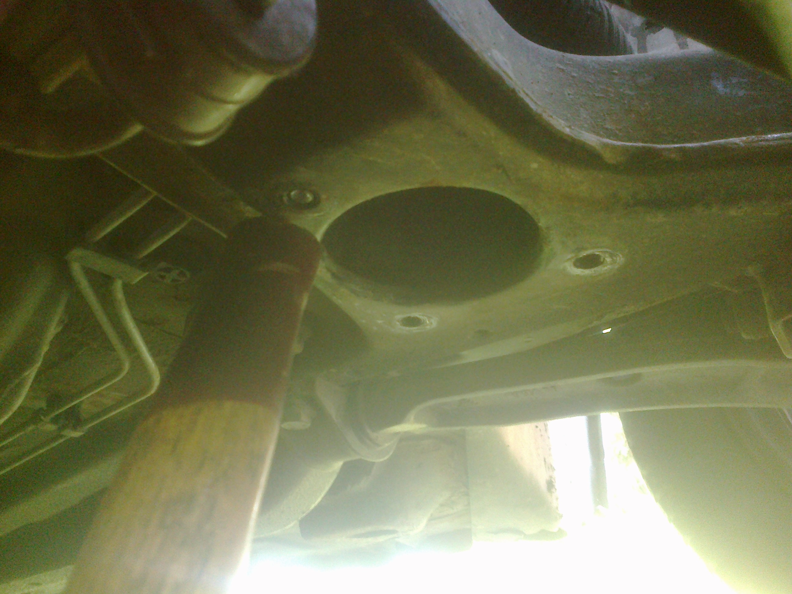

so i finally went to change my gearbox mount, its been bad ever since i changed clutch last year, clutch still holding with 19202 km behind it, and guess what happened, gearbox mount bolt snapped
everything i touch on this car breaks
advices?
weld a nut over it?
drill old one out?
weld bolt on it and remove old one?
will it hold gearbox with only 2 bolts?
The trouble is if it snapped then it's tight in the threads and that type of extractor usually snaps off in that situation and is very hard to drill out so I'd cut to the chase and just drill it out in the first place. What can work, however, is to drill it and then hammer a Torx bit in.
