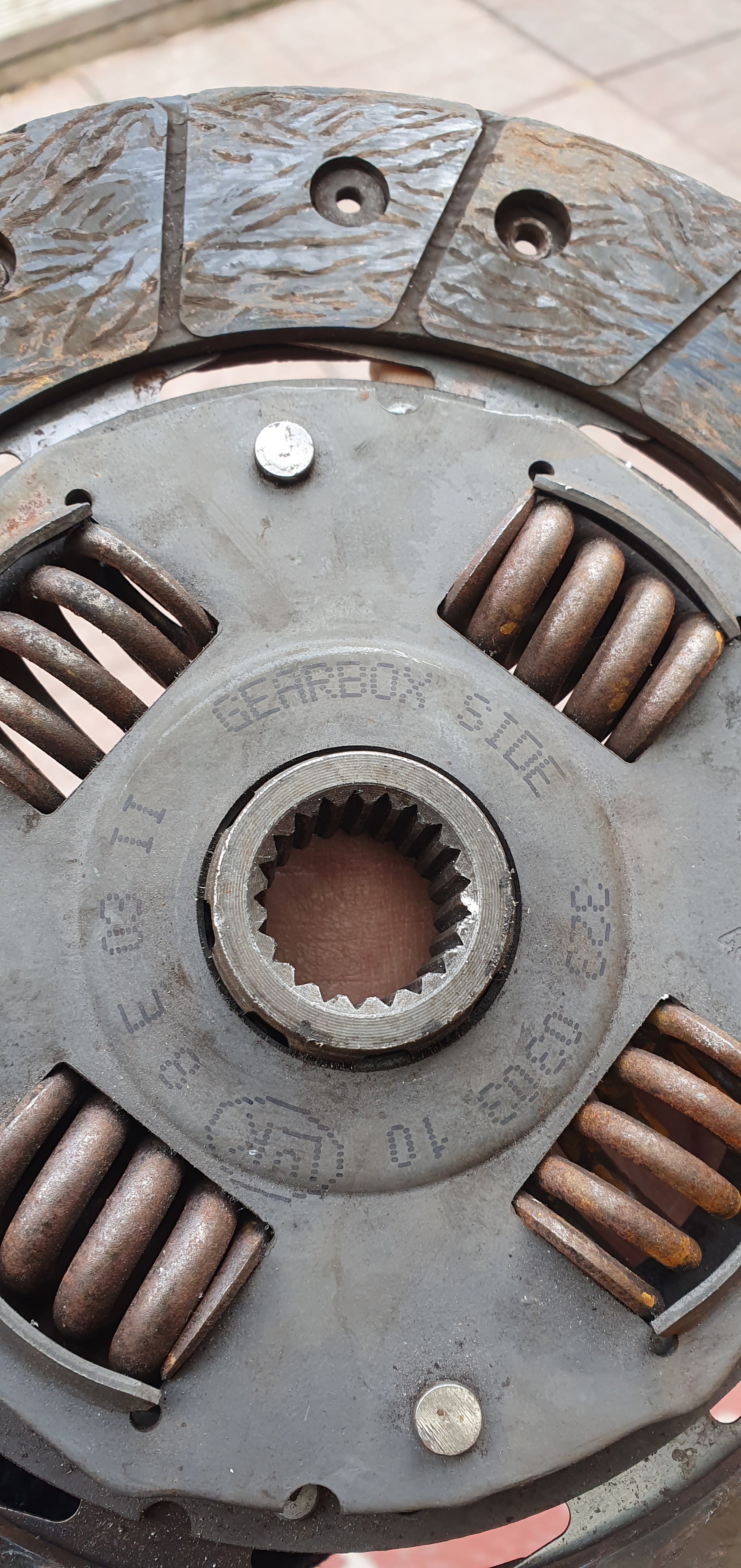

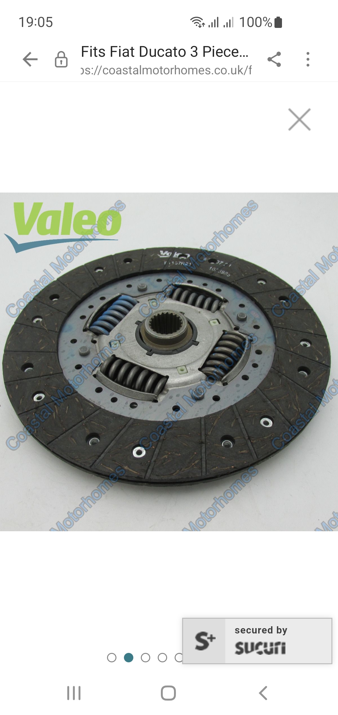

yh bearing slides on nice and easy and now got it located ,, now for clutch , on the old one it was wrote gearbox side but new one has no marking to indicate which way , can I assume it is just the same as old one so the thicker side is gearbox side have included pics off old and new plate

Yes, sometimes it is written in German, but if you offer the centre plate up to the flywheel you can often see that it is held off if it is the wrong way around, but as you say usually the thicker part sits within the clutch pressure plate.
So generally I would say that in your last photo, that side that is visible should be against the flywheel.

Great just wanted to check would be gutted to find I'd put it wrong way and had to take off again
