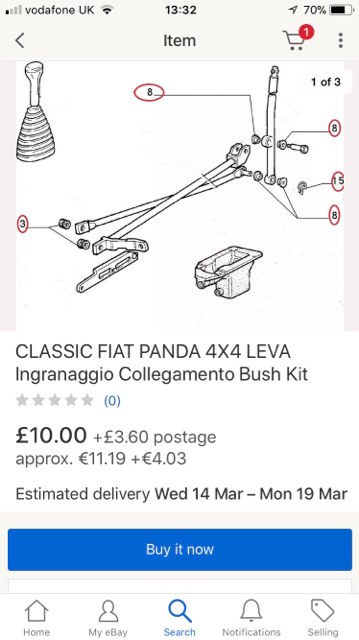

HI Guys, I need a bit of help,
I have just purchased a 1988 panda 4x4 for my boyfriends birthday. It is hidden in a garage at my parents house. Unfortunately the gear linkage has popped out.
So I think the part is the welder type gearchange link rods. its the rod at the front of the car on the right side. it looks like a ball joint has popped out. I have managed to squash in back in but it pops straight back out as the bushes are preished. I have purchase a new bush (hopefully the right one) however the part that has the ball end (not the hole end) seem to spin back and forth with ease. I seems like its not attached further up or is that how it is? Im a little lost with this as I do not know what it should be like.

This one?
Or This part of that?
Or this one
This may help?
https://www.fiatdalys.lt/en/catalog.../0/M6,M7,M8/0/GD/transmission-outer-controls-
https://www.fiatdalys.lt/en/catalog...0/0/M6,M7,M8/0/GD/transmission-outer-controls
Some are pinned and the ball joints need a pair of mole grips to pop them on.

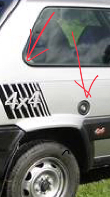

As to the 4x4 badges pinned to the rear wheel arch trim if you find any shout as I need one.

Greatbushes Ebay. It
