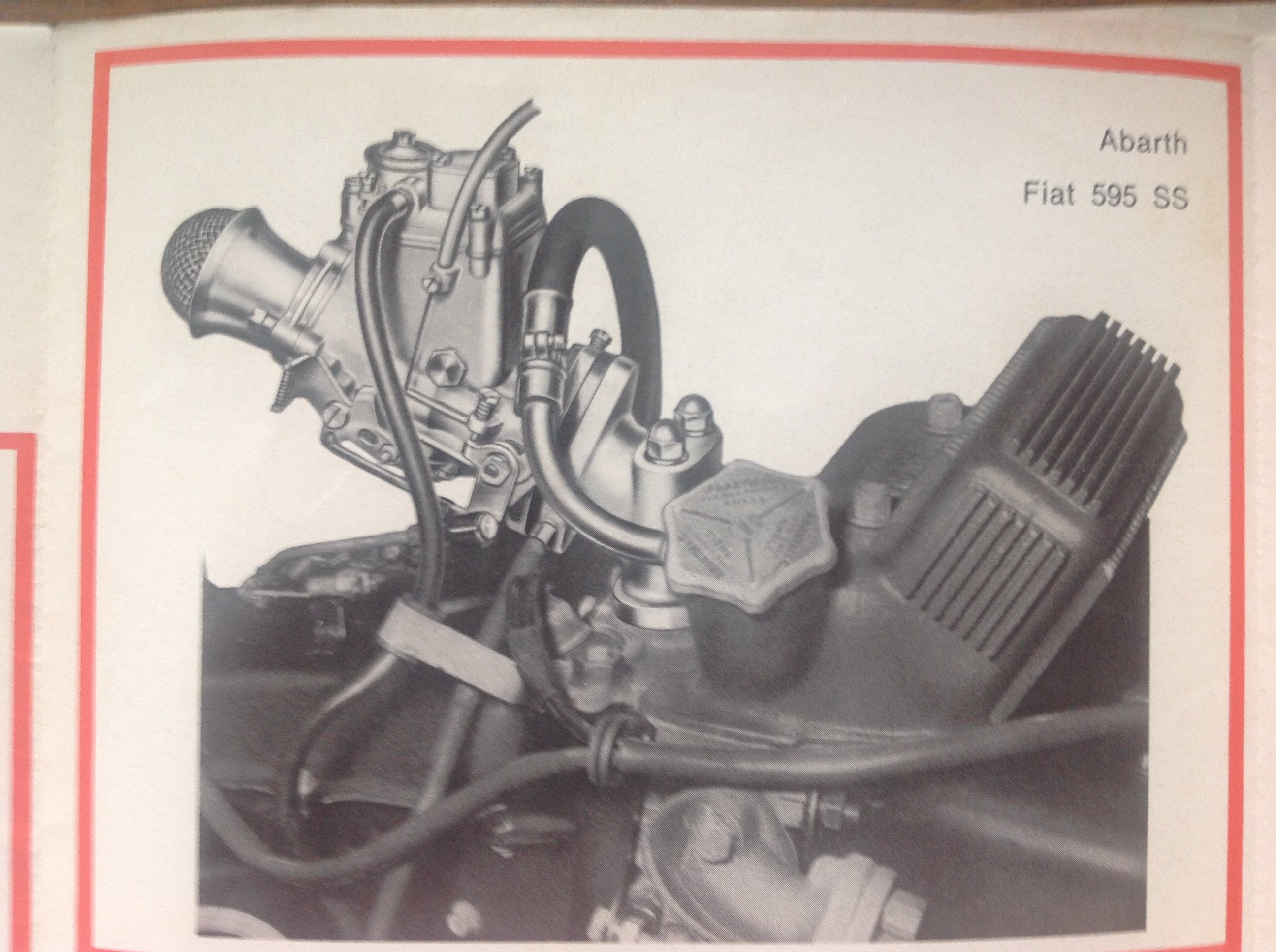

Before I return the Dellorto brochure to the file I thought that this picture of the Abarth Fiat 595 SS may be of interest
