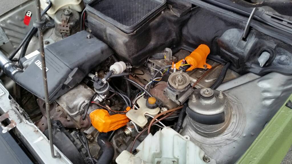

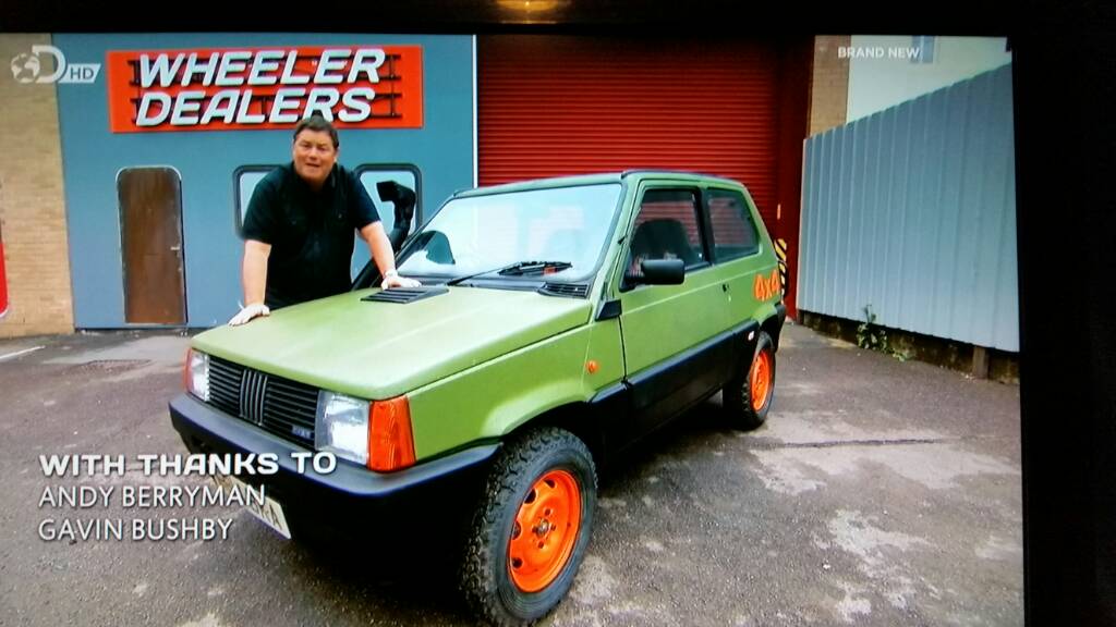

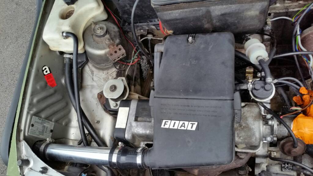

When you look closer to the engine bay and compare how it was when Mike had first look and how it looks on photos taken by Andy4x4 yesterday, there are several difference:
new master cylinder, different dizzy body and vaccum unit, hot air intake plate above ex. manifold, timming cover, rear air box section - i would bet the engine was sourced from Panda killer as well as doors.
Not to mention the tyres and cost when they have done the break down list of spendings. Corect me if i'm wrong but the list tells £200 for tyres @ £50 each, and there are actually 6 tyres with the car.
Definately this WD episode did provoke some panda4x4 discusion on other forums as well, i wonder what effect it going to have on the 4x4 scene.
Some might say it was its 2nd engine and 3rd gearbox. ;)

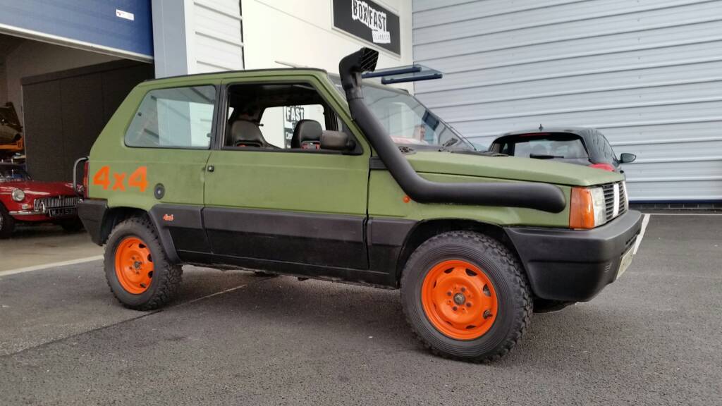

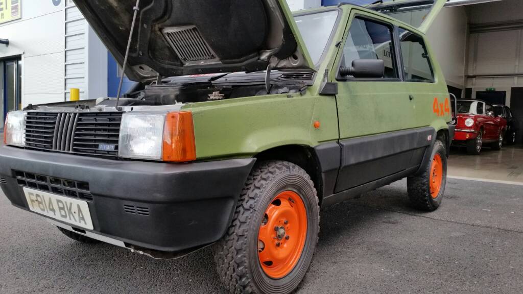

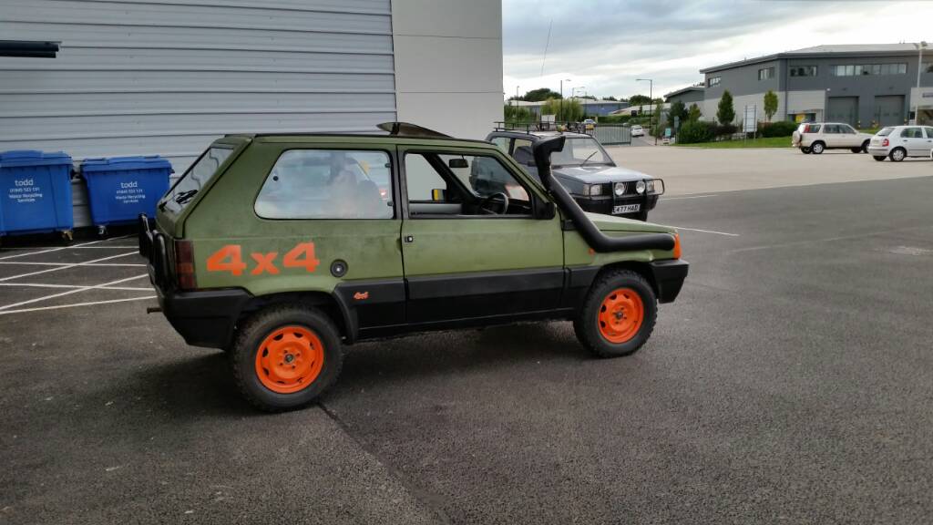

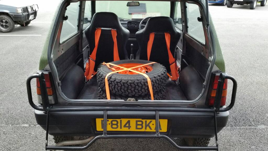

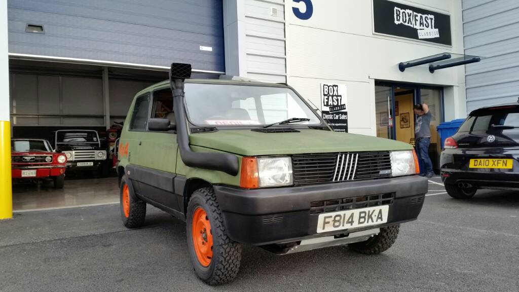

Most of you will have seen this car to death now, but yesterday evening I booked in with the dealers to go and view the car. Here it is in all it's glory...
A description of my findings is to follow shortly (it will be an essay so be patient!)

So, in my opinion...

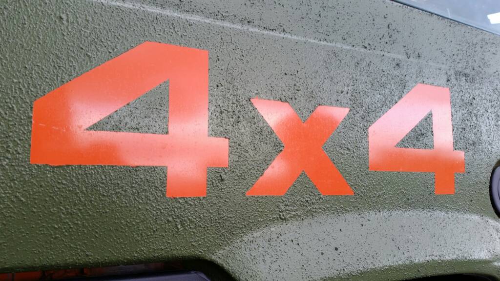

The look of the car from a distance is very good, to be honest the more I see it the better it is starting to look. The only thing I dislike as a whole, barring the size of the snorkel, is the font used for the 4x4 badge. I think the colour scheme is bold and does work well.

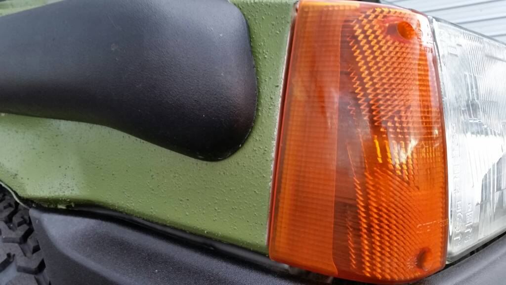

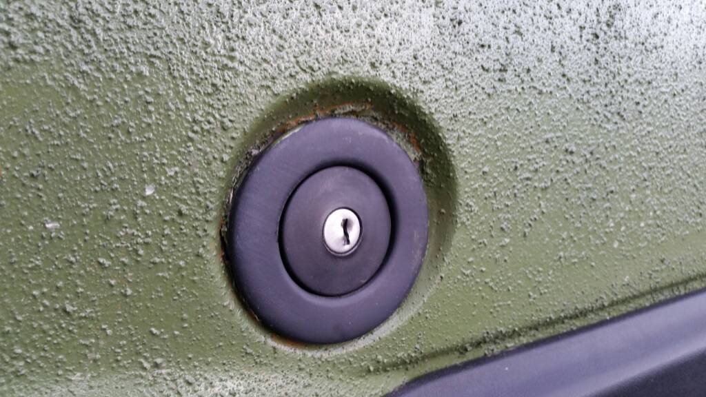

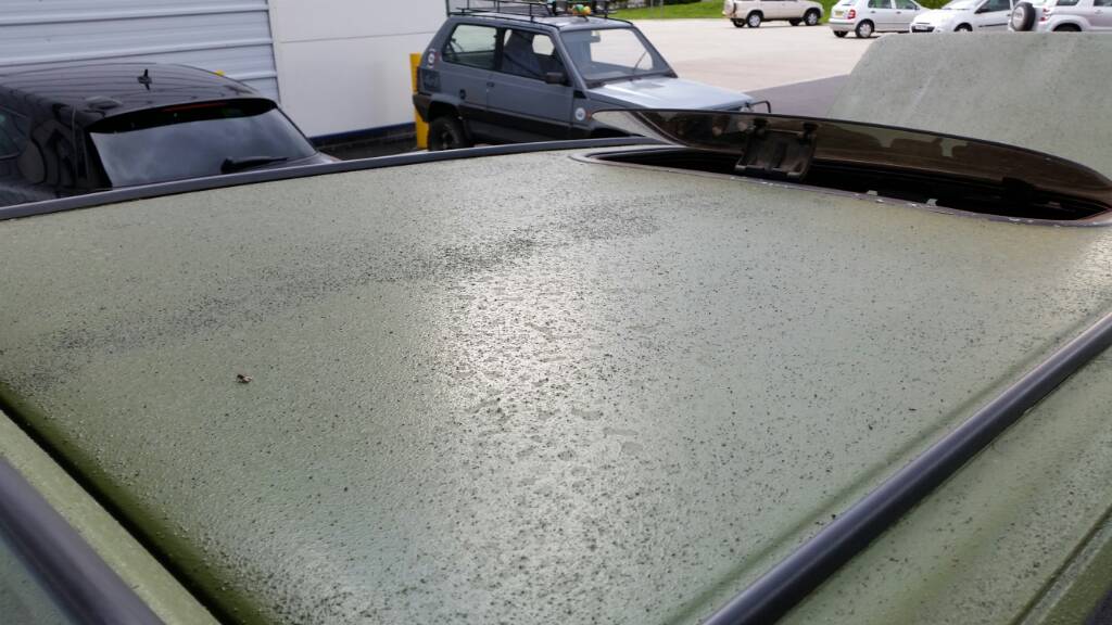

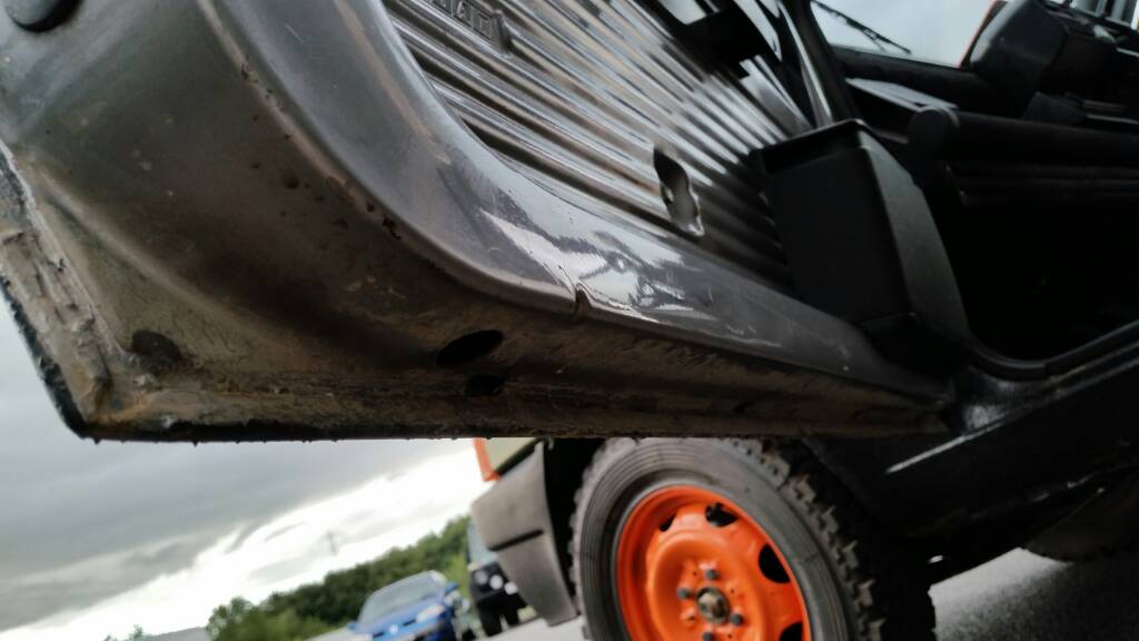

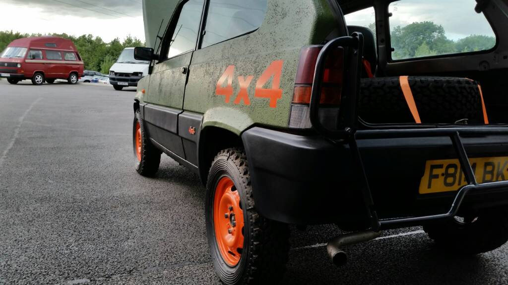

The paint finish is frankly terrible, the idea is bold and was a risk but the finish is not great at all, just uneven and very patchy (see attached pics below). It is good however for the eczema on my hands, nice and rough!
The coverage of the green finish is not good it needs another coat, also the passenger door is slightly darker than the rest (for reasons explained later, but you will already know!)
There is visible over spray on the rear quarters, in the bumper and light gaps of the orange paint which I thought should have been rectified better. The paint finish on the edges and lines is a bit rough really, more time with the masking tape in future!

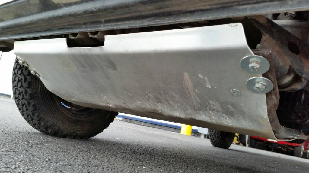

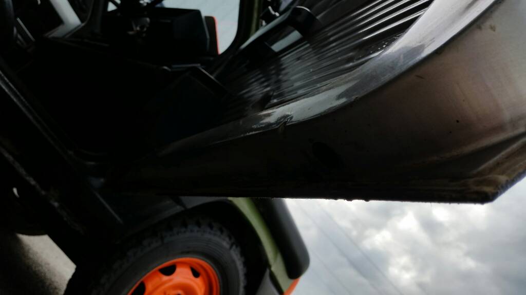

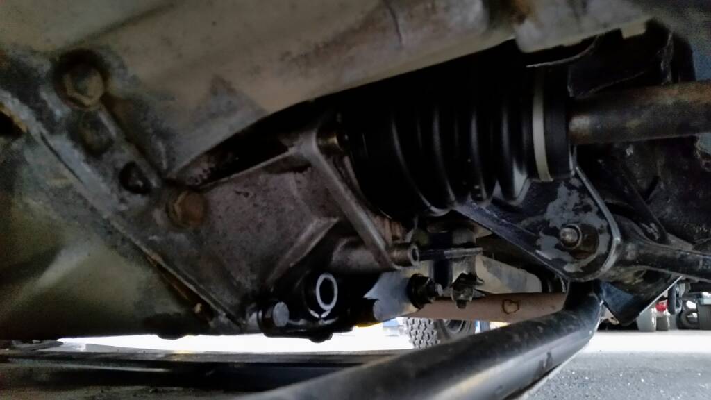

The body of the vehicle is very straight and fairly rust-free. I found a few scabs on the rear panel and underside of the bonnet. The chassis is in VERY good order though. To me it looks to have only a few patches of welding here and there which had been done to a high standard. It's on original outer sills with one or two patches on the inside, all of which appears to be metal - no silicone or fibreglass in sight. The inside boot floor is good, as well as underneath where it meets the rear panel. All parts of the underside are stone chip sealed and waxoyl'd. The fuel tank is in very good condition as is the back axel, new brake pipes and cable as well. Prop shaft support bushes are warn but not badly, CV boots are intact. I was very impressed all things considered with the underside of the car apart from the sump guard, which was rubbish to start with and is now well dented due to no proper support behind it (see pictures).
The engine as discussed, is different to the one seen in the show. I was told it has done 45,000 miles but with no paperwork shown to back it up. The engine number has been correctly changed on the V5 and matches up, as has the colour change by the way. The gearbox drain plug was the only leaking part I could find, all new drive shaft boots along with a tidy clean block. I was never a fan of the snorkel idea, I told them it was pointless but it was done anyway, I'd just be worried about rust getting into that wing really - mainly due to the drilling :eek:

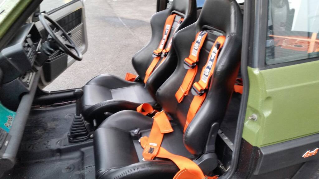

The interior looks very tidy and finished to a fairly good standard in my eyes, I like the look of the spare wheels in the back along with the colour scheme. The dash inlay looks to have been dyed from the original. The passenger door on the inside is grey whereas the drivers side is the original car colour, but both doors are very solid (I had a long look) and I can't see filler anywhere. The tailgate is also solid with hardly any rust on the bottom seam. There is no headliner in the car so it'll be loud when it rains! There are no visible signs of welding on the floor pan or inner rear arches either.
Right, to drive...
The seating position is terrible, far too low down (probably done like this because Edd is massive). I'm 6'2" and there was a lot of room above my head! Especially as it's for off-roading I would have required more height so you don't have to "sit up" to see what's right in front of you. I don't think the seats are as comfy as the standard ones either, sorry! I had comfier bucket seats in both my Astras!
The engine is very fit though, I would probably say the best FIRE engine I've ever driven. It has a lot of power, and feels tight. But, it doesn't run great on a cold start and you have to drive with the choke out a tiny bit, d'oh!
The gearbox is bad news and spoils the drive of this car. First and second are fine, third is hard to find but when it turns up it's VERY close the first, fourth does not appear to be in line with third and fifth is miles away from them all. The thrust bearing is also very noisy indeed, although the clutch feels good to me. The engine sounds good as well, a bit of a top end knock when starting from cold but this soon clears up (Pictures of the engine bay below too).

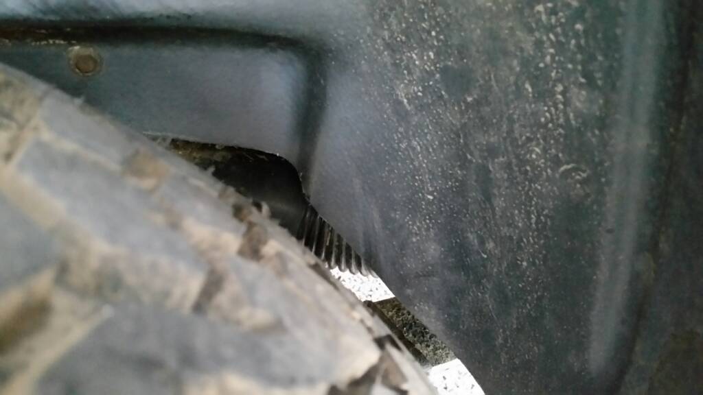

The tyres, although they look great are bad news. I liked the part of the episode which showed the making of them, fab idea but in reality they are too big for the standard vehicle. Tell-tale signs include damaged rear arches, front bumper corners, ripped tread and marked inner arch next to the filler pipe (see pictures). They are not very loud on the road, nowhere near the Trac 4x4 noise. These tyres will require spacers on the rims and rear arch trimming the run correctly.

The rough bits...

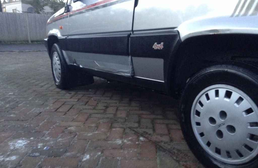

No mention of the passenger door made out of tape!
