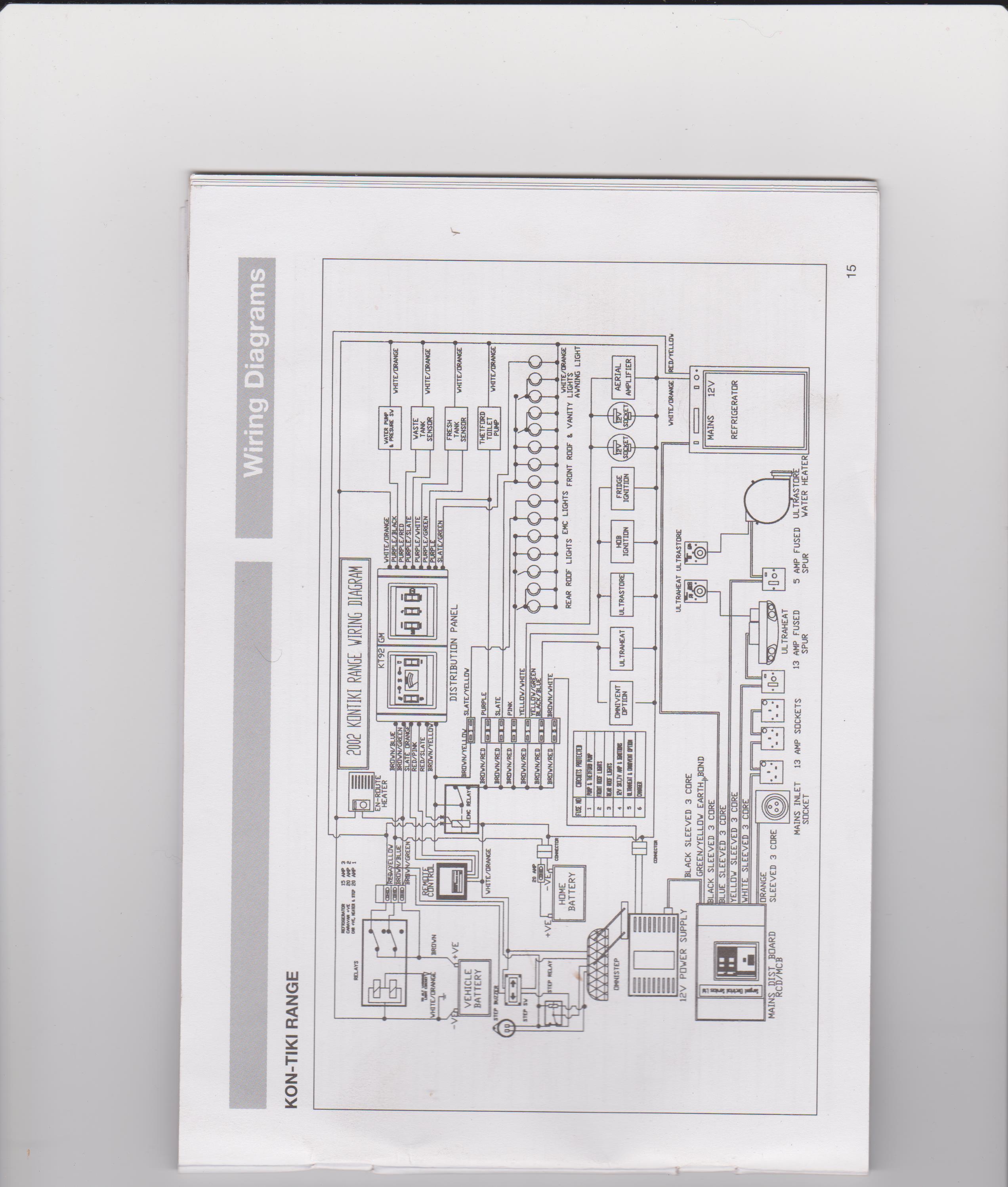

I thought someone had already posted a link to the Sargent Schematics, but it would appear I was mistaken.
They seem to have removed anything earlier than 2004, but there will (IMO) have been little change from your 2002 vehicle.
The 2004 schematic can be downloaded from:
https://www.sargentltd.co.uk/tech-support/article/25/download/265
...and should help you with the circuitry, if not the geography. (It makes obvious what the relays and fuses you've now exposed are).
I think quite a bit of the wiring from the engine compartment entered the 'van below and behind the vehicle battery and tray, but I certainly wouldn't want to stake a lot on it!
Yes thanks Hugh, I've still to put a 2002 Schematic on here when I can eventually get it copied from book. Will try tomorrow.
This schematic from Swift booklet that came with camper. Theirs also a Gazelle, Sundance and Mondial one if anyone wants it. Got to compare it with the Sargent one.
Doesn't look too good, need to work out how to get it blown to A4 size and turned. Then Laminate it.
