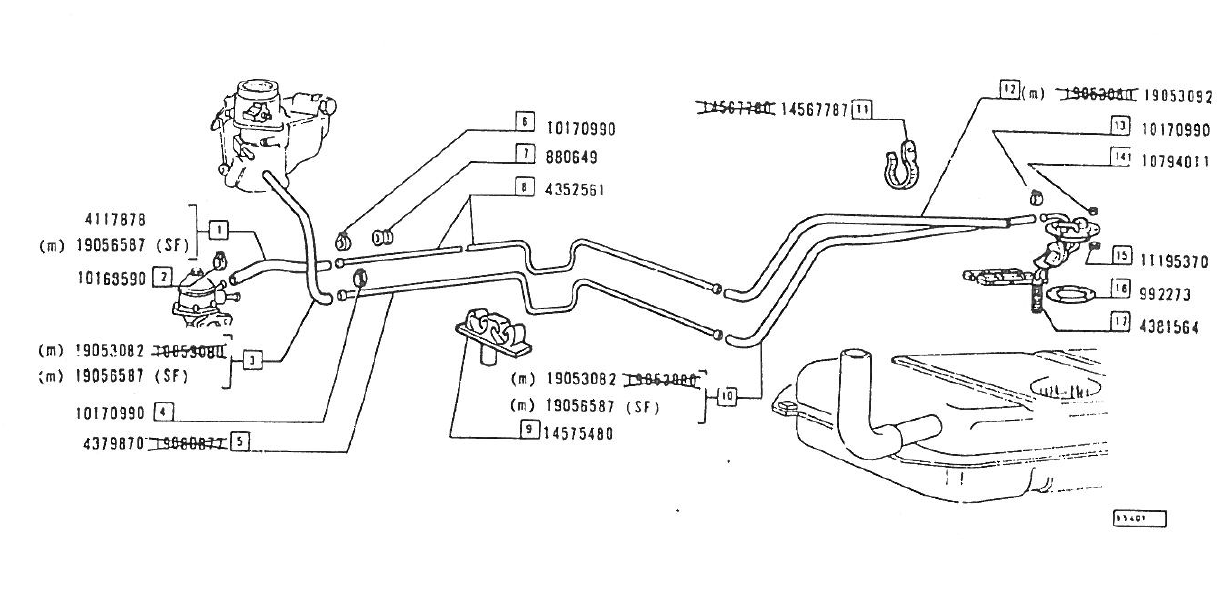

Hi Guys
Does anyone have a diagram of the fuel system and how it works please I dont have a Haynes manual and cant seem to find one, I wanted to upgrade the fuel pump for something a bit more modern and reliable
Thanks
Andy

Yes. :)

Further to the fuel pipe diagram from Peter here's a photo showing the fuel lines under the middle of the van.
I can't remember the pipe size but is was slightly larger bore than the brake lines.
The fuel lines (the two running side by side) connect to flexible hoses in the middle of the van and then run over to the top of the fuel tank (seen on the left in the photo) and then connect to the fuel sender unit - make sure you get them the right way round (otherwise you will just suck air).
Thanks Gary the diagram is just what I was looking for
