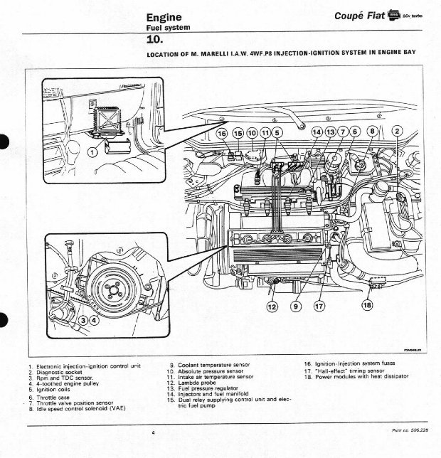

OP OP M mattkh New member Joined Dec 18, 2008 Messages 45 Points 10 Jan 3, 2009 #3 hmallett said: I believe that is correct. Click to expand... Hi Thanks. Do you know the color/number written on the relay for the fuel pump. Cheers.

Davren Moderator Staff member Uploaded 10+ resources/downloads Joined Jul 6, 2008 Messages 16,423 Points 3,886 Location London, UK. Jan 3, 2009 #4 Number 15 in this diagram from the Fiat Coupe workshop manual. This is for a 16v Turbo. Others may be different. Dave. Attachments 16v Turbo.jpg 95.7 KB · Views: 172 Last edited: Jan 3, 2009
