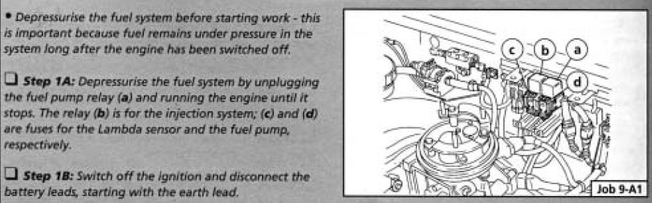

I have a fiat tipo 1.4 ie "m" reg. I need to change the fuel pump relay but don't know where is is. Can anyone help
Hi, Welcome to the FF.
According to the manual, it's (a) in this diagram.
Dave.
Thankyou so much for that.
I had problems about a week ago and with help from a friend a tested the fuel pump by putting a live 12v onto the pumb and it worked. I am guessing that it must be the relay switch and brought a new one today but was not sure where it was to replace it. Not had the car that long and did not have a manuel for the car. This is a great help and I well have a look 1st thing tomorrow after work:)
