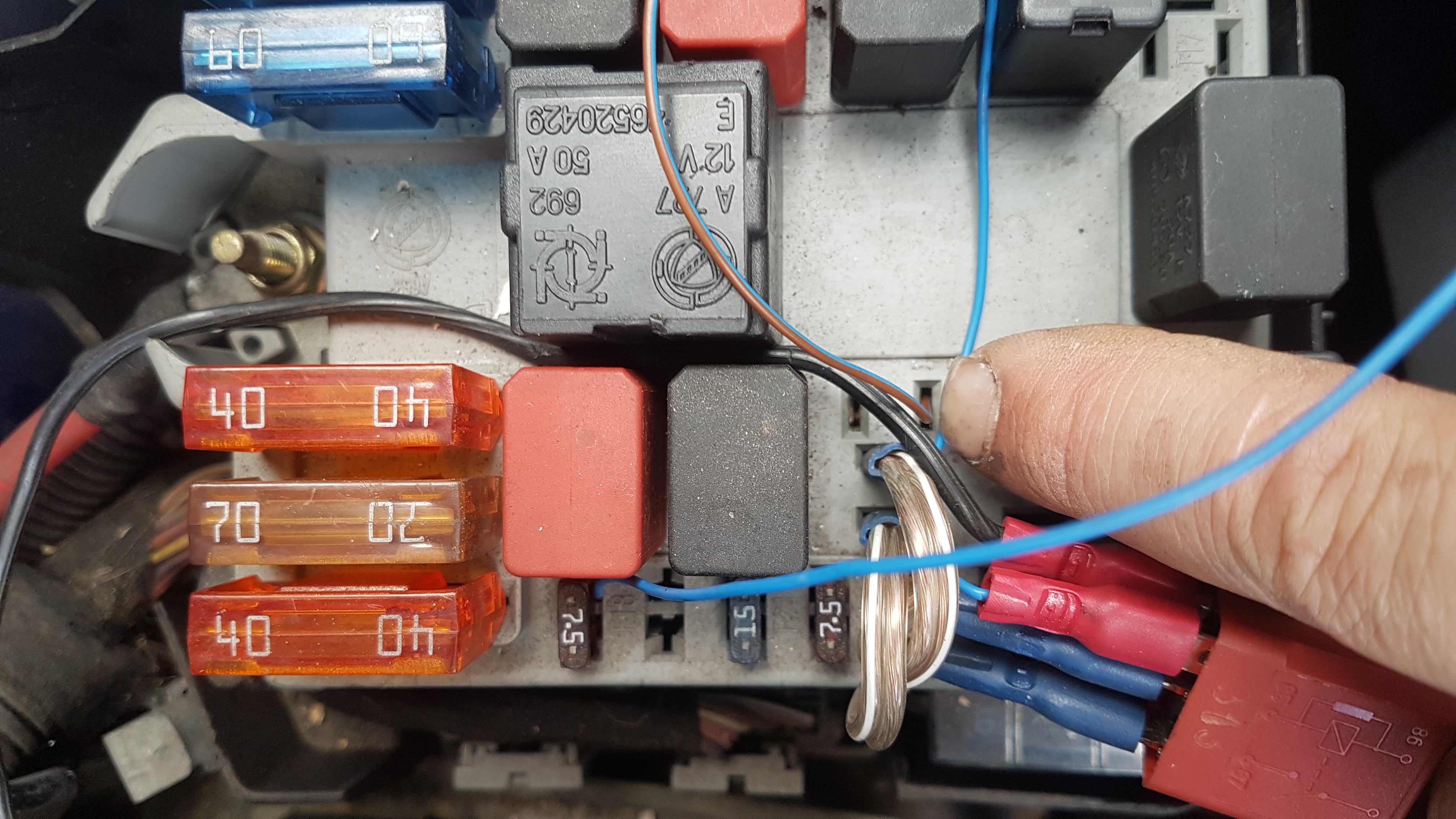

it has an issue where the fuel pump only runs if I take out the relay and loop a bit of wire in the relays switched pins. the engine starts and runs fine after I do this.
the issue is if I leave this tempory fix as it is, is that the fuel pump stays running constantly.
so my question is, where does the fuel pump relays signal wire come from? I have pulled checked and swapped around all fuses to see if that was the cause. I have also swapped the relays around. like I say however I am never getting the 12v signal to power the relay on.

so I have done a bit of a fix and wired in the relay (T09) to an ignition live. no more battery drain.

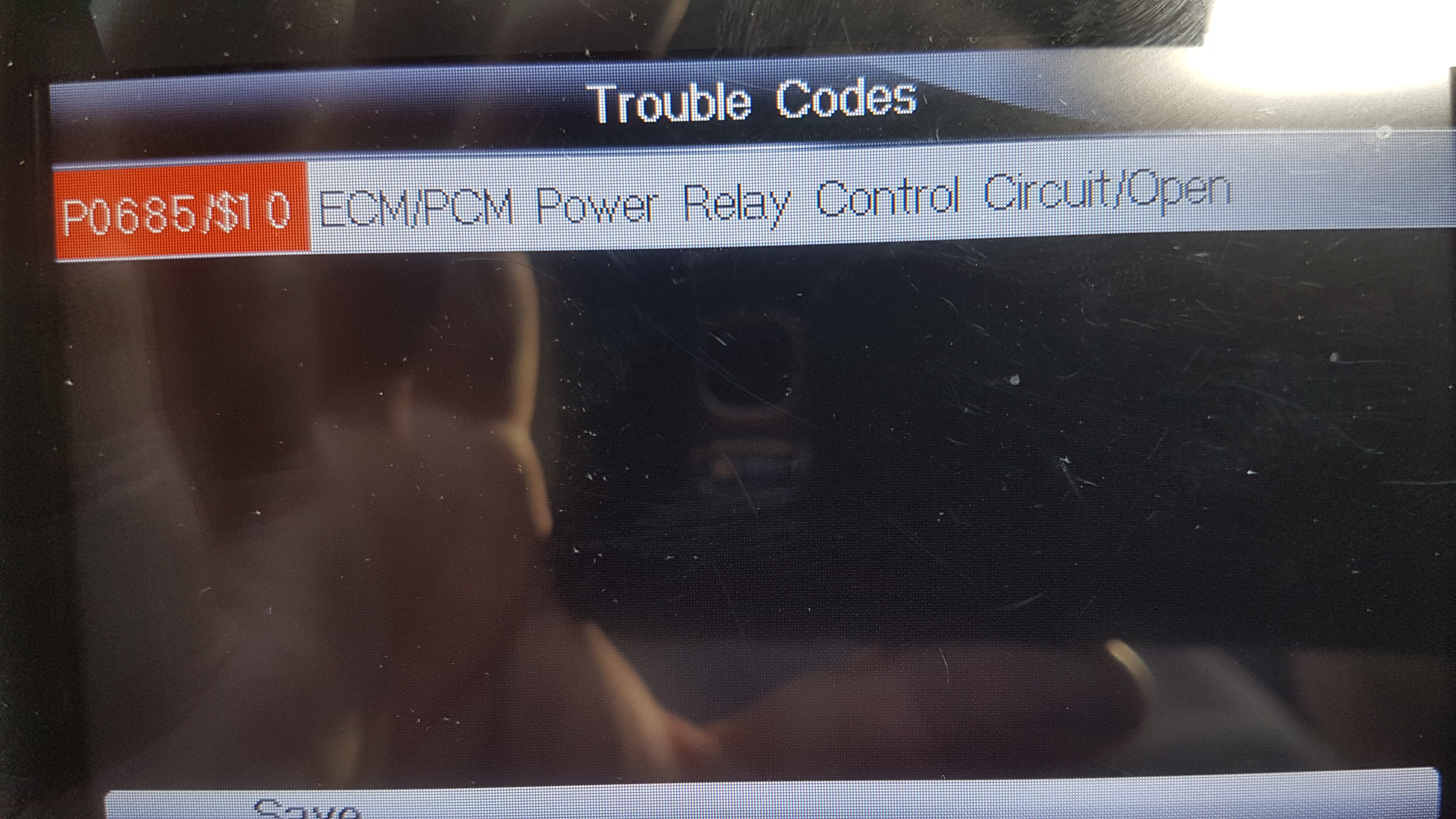

however i have a permanent engine management light. after hooking up diagnostics it's coming back with one stored code which is the power relay control circuit. code P0685.

fuse F18 gives power directly to relay T09 (the one now wired to an ignition live)
need to find where this pin on relay T09 goes to.
attachment.php
this should be earthed to enable the relay to power on.
but what earths this pin? where does it go to?
bypassed fuel cut out trip switch in footwell. no luck.
tried earthing the earth pin on relay T09 to try to fool ecu.. no luck.
tried earthing a load through earth pin on relay T09 to try to fool ecu.. no luck
fuel trip switch in footwell is a different system/curcit to the relay T09.
tried bridging the pins with of relay T09 with different resistance values with no luck.
the wire must be damaged between the relay and ecu or ecu failure. wonder if water can get into the ecu connector.... ecu pins look fine.
check ecu grounding.... perfect continuity to ground and battery - post.
attempting to follow wire connected to ground pin on relay T09... pin 12 on brown connector under fuse box connects to earth pin on relay T09. pins and connectors in fantastic condition. pin 16 turns into a grey and red wire..attempting to locate in ecu plugs..
attachment.php
fuel trip switch in footwell is a different system/circuit to the relay T09.
attempting to follow wire connected to ground pin on relay T09... pin 12 on brown connector under fuse box connects to earth pin on relay T09. pins and connectors in fantastic condition. pin 12 turns into a grey and red wire.. attempting to locate in ecu plugs.. generic Bosch 223 ecu. no continuity to any pins on ECU. checking inside car for immobiliser box... grey and red wire located in the internal fuse box in front blue plug next to OBD port pin 9. grey and red wire has continuity between both fuse boxes and handles a load.. removing fuse box and body control module.. checking for damage to internal circuitry of the BCM. no visual issues with bcm.. however in checking the fixed surface mounted relays i have managed to damage them :doh:(had it before where relay contacts have burned out suspected the same issue)
