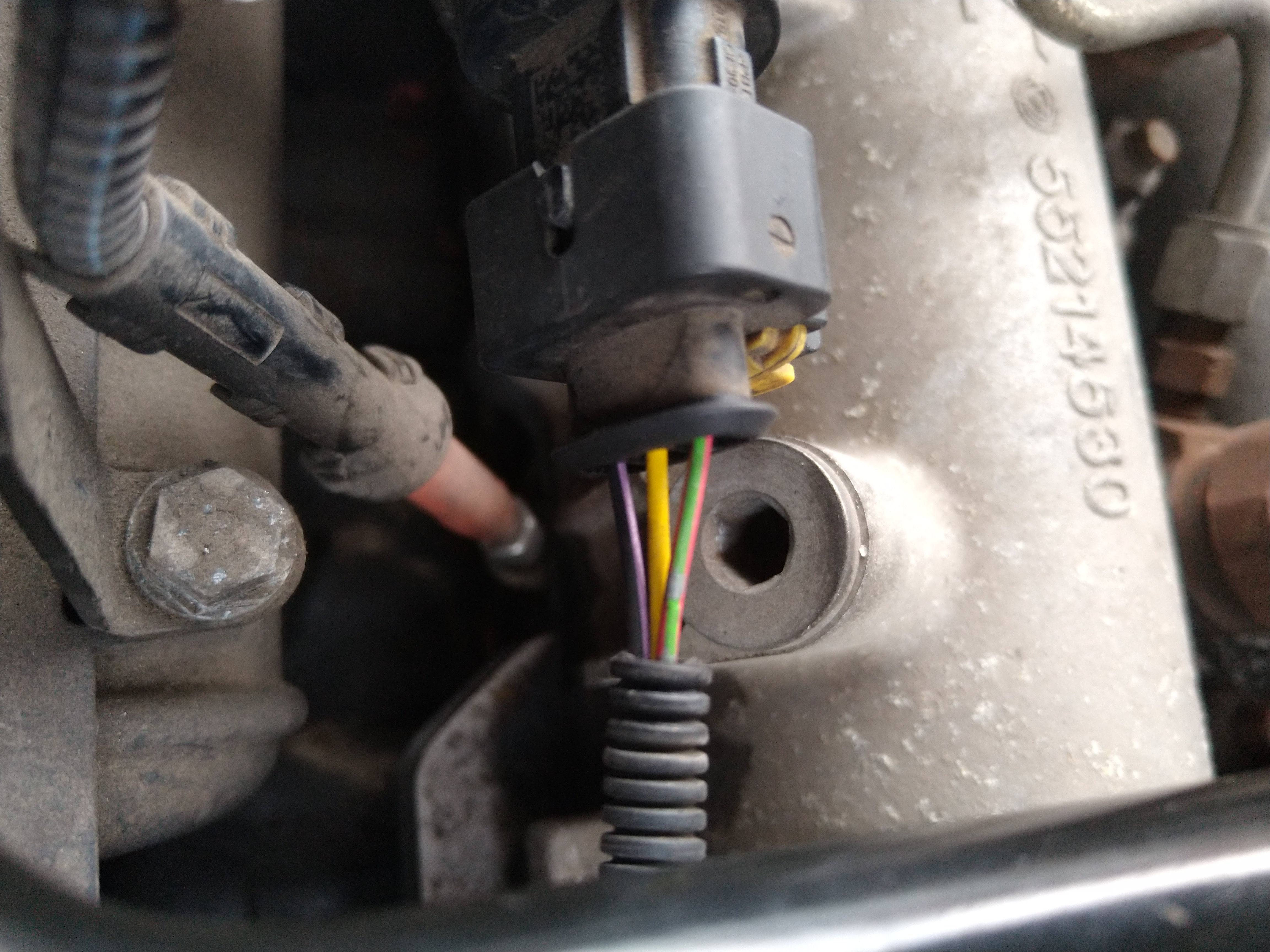

I measured the new switch and when the ignition is on I am actually getting a tiny voltage on the red and green wire, about 0.018v. although its small its definitely different to when the ignition is off making me think the sensor is picking something up and from watching a how to video for a similar sensor the voltage seems in the right range. Can anyone else who's had the issue or knows more about it verify if my numbers are right or wrong?
Thanks for having a look, this shows the plug close up and a wider view of the fuel rail with the plug on the left end of it. I got a friend to come round with an OBD reader but unfortunately it was just a basic one so couldn't tell me the pressure at the sensor :/ I'm going to try another one tomorrow that supposedly goes more in depth and hopefully that will give me the answer.
