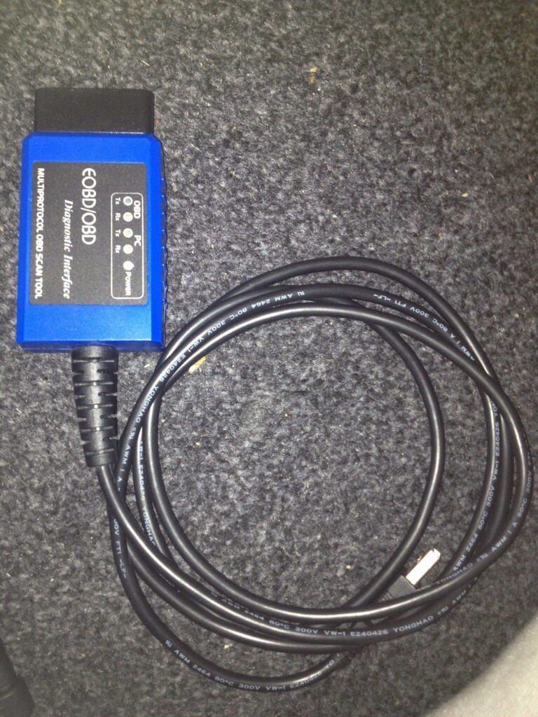

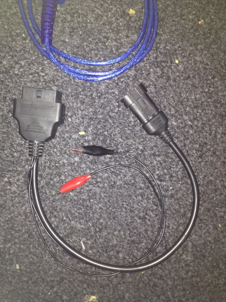

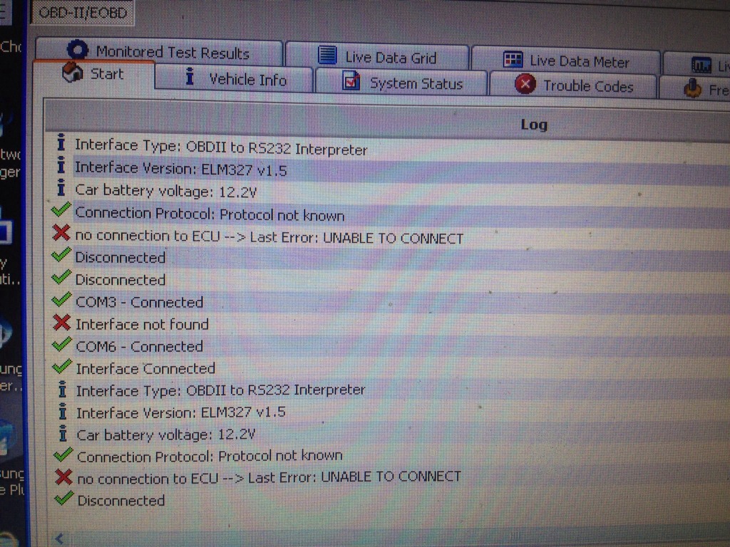

ImageUploadedByFIAT Forum1385026389.958005.jpgImageUploadedByFIAT Forum1385026419.968404.jpgImageUploadedByFIAT Forum1385026445.341898.jpgImageUploadedByFIAT Forum1385026467.048126.jpg
These are the leads I have and this is all I get on the screen I've tried different ecu diag programs and still no luck
what program is that? Don't look like IAW Scan, try that - http://sourceforge.net/projects/iaw-scan2/
I would be using the 3pin adpator connected to the Vagcom cable. I just use the car battery terminals for the power wires on the 3pin jobby. Connect that to the laptop before opening IAW Scan. My Vagcom doesn't have that switch thing on it so dunno what that should set to.
If that don't work i dunno what to suggest other than clean the diagnostic plug on the car and/or try a different vagcom cable :confused:
Yeah its a great bit of software, MES is good too (think thats what your screenshot is of) but you need to purchase a licence really before you can do anything but read codes with it - I have both as i need MES for the alfa but i have never tried using it with the punto or cinq or sei as IAW Scan is brilliant simple software for them...
So you use vag com and 3 pin connector can't you access on the elm 327 at all
never tried, i had the vagcom cable way before i had an elm - i had to buy the elm for my alfa more recently.
Looking at the MultiEcuScan website though, there is a supported vehicle list and what cables are required, on there it doesn't have elm against a Punto 75 so i would have thought that means that one won't work on that car period. Says you use the 3 pin and either vagcom or obdkey (not ever dealt with obdkey before myself so can't comment there)
http://www.multiecuscan.net/SupportedVehiclesList.aspx
Will I just need a standard vagcom lead with no switch on it as this switch is supposed to change pin settings instead of buying seperate leads also my 3 pin connector has a red and a black wire with crocodile clips on for a power source
oops sorry, well thats 3 rows down and says exactly same thing.. No actually sure if IAWScan does the 90 or not tbh. MultiEcuScan should connect and read codes, can't remember if it lets you clear them or not without licence (i have registered copy and can't remember what is and isn't allowed on free version but says on the site).
But i think we can safely say if you were trying with the elm then thats why it doesn't work.

Ok I might just buy a normal vagcom without switch on it and see if that works
You should be able to use the vagcom cable you have. I think from memory you need the switch set to 1 (left side). The other 3 posistions are for reading codes on newer cars you may need to look at the settings for you usb port. I now have a dedicated laptop that only has USB1 ports.
So I don't need to buy the coloured cables then also does it support 3 pin connector as this is what I have in engine bay going to ecu
