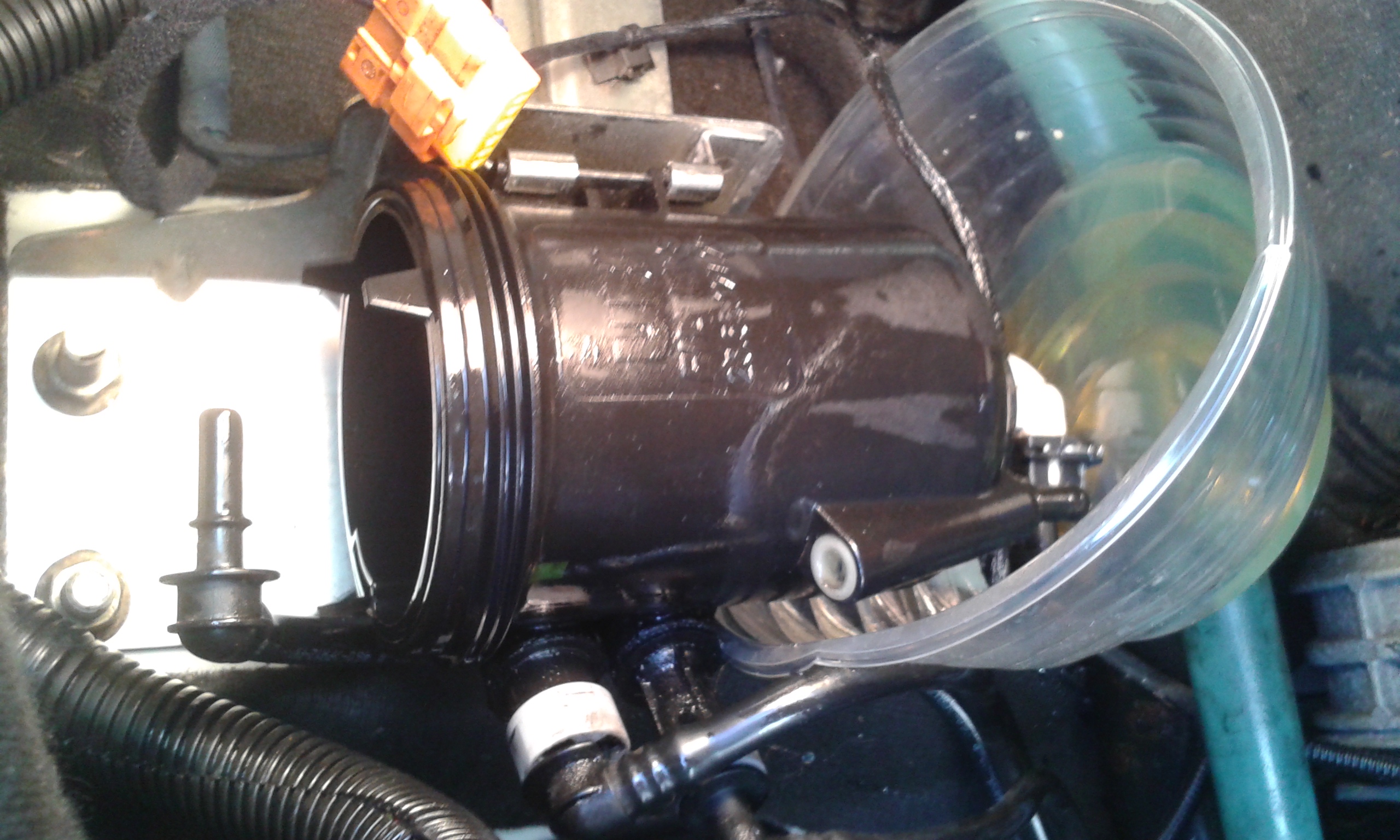

hi it dose not sound the same on 05 plate 2.8 jtd take air fillter out and housing
then the fillter is on the backk wall pipes are like the q fix push and pull
sorry about on the side
