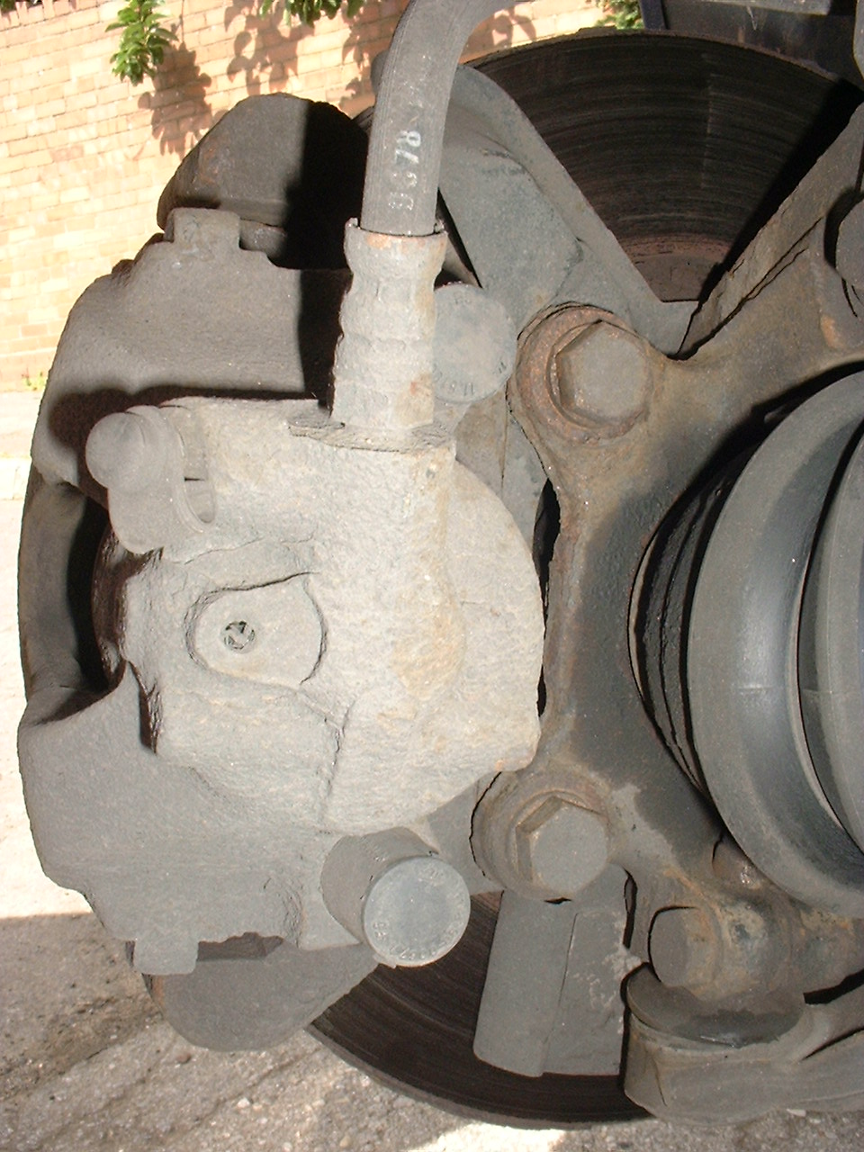

Can some kind soul tell me which type of front brake caliper I've got (Bosch or ATE)?:
Thanks chr1s. Knowing where to look once I'd seen your pics, I managed to slide a bit of plastic mirror twixt caliper and alloy and shine a torch on it; Bosch it is.

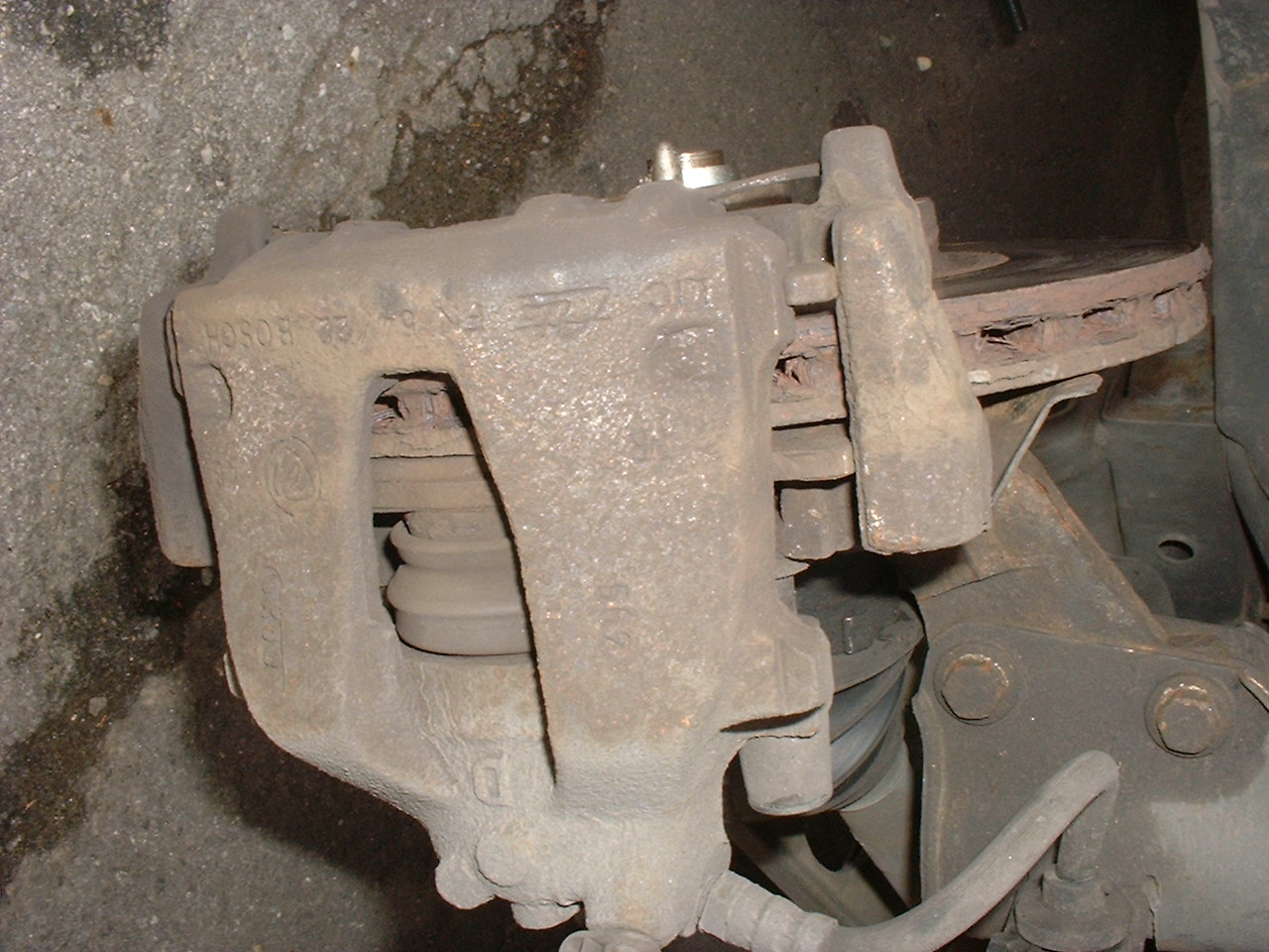

BTW, these are my (ATE) calipers after they had been refurbed. Note the confusing markings!:
Fair enough. But I am still confused why ATE include the name BOSCH on their calipers.

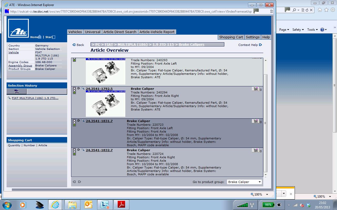

From their website http://outcat-cs.tecdoc.net/ows/en/7707C590D44DF6433B2B80447BA7DBC0.ows_cs4.srv;jsessionid=7707C590D44DF6433B2B80447BA7DBC0.ows_cs4?view=VIndexFramesetJsp , it appears that they supply calipers for both the ATE brake system (up to 09/2004) and the Bosch brake system (10/2004 to 02/2008). I'm not too sure which system mine uses, as it is a nosejob but registered 12/2004.
Do they include Bosch on their calipers just for the, later, Bosch brake system ?

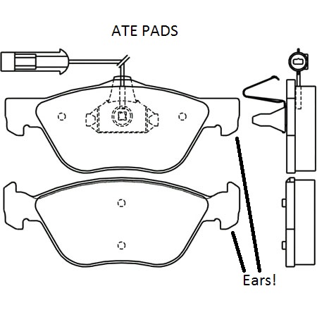

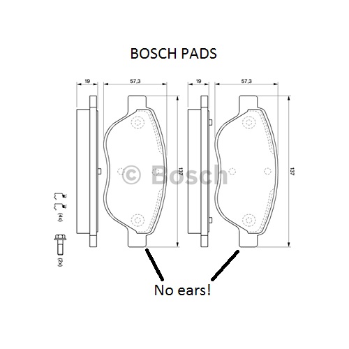

It doesn't seem to follow any date order. Like you, I got very confused by the names on the calipers - bought a set of Bosch pads (anyone want a set of Mintex pads, still in the box?) as I saw 'BOSCH' cast into the caliper, only to find that I needed the ATE ones . As photoboy says, the giveaway is that the ATE pads have 'ears' on them, the Bosch ones don't, so rather than looking at the caliper, it's best to look at the pads you want to replace (you can see them from under the car without having to remove anything):

The picture to me of the bosch pads, look like rear pads, as rear pads mostly have stubby locaters.
They're definitely the front pads. I can't get a direct link to the destination page to work, but if you go here:
http://de.bosch-automotive.com/part...rakes_1/disk_brakes/brake_pads_1/brake_pads_1
then click on 'eCAT' and fill out the search page (tick the 'enlarge vehicle fleet to all countries' box), it will show all Bosch parts available for the Multipla, including pictures of the front and rear pads. The rear ones are similar in appearance but quite a bit smaller.
