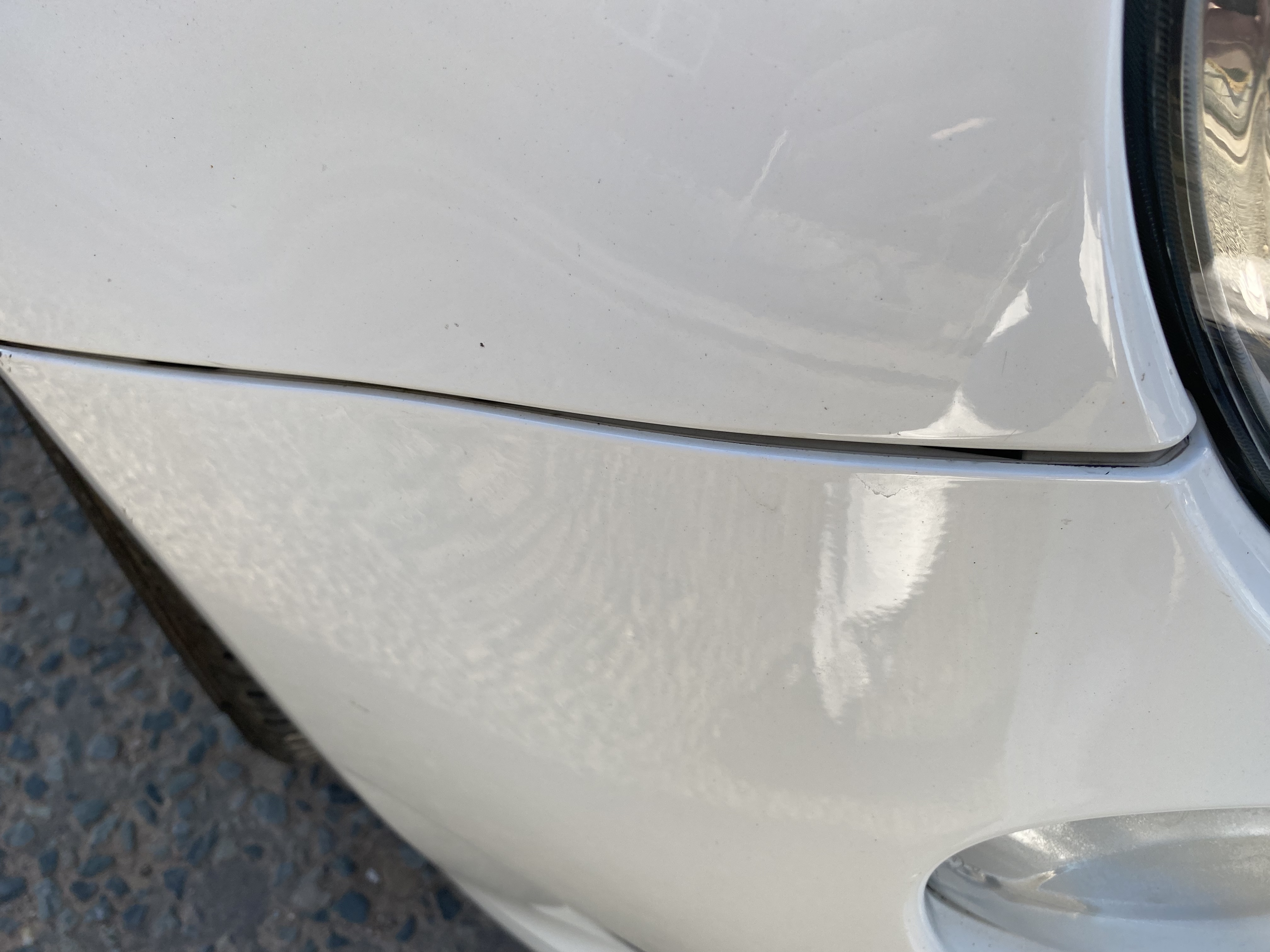

Hi guys.. I’ve just had wish bones and cvboot done at a local garage. This cost me a small fortune. I’ve only just collected the car and it’s an absolute mess. The front bumper isn’t on properly with gaps both sides where it attaches to black wing clips.. but I can’t see these clips.
I’ve had my bumper off plenty of times, but do I just take it off and fit it again, or take it back and tell them it’s not right. I’m confused how it’s pulling away from the wings when they should ‘clip’ in a fixed position
My problem is I’m autistic and this is beyond my comfort zone.. going back and suggesting they’ve broken my bumper clips
Thanks steve
The other side isn’t as bad, but this side is hanging and pushing out, I can push it in with my finger and it just pushes back out. The is a m6 10mm nut and bolt on the other side and I can see that just needs a loser and tightened when in correct position

Personally I’d say it’s either not fitted correctly or the original bracket that’s riveted to the wing: one of the tabs has snapped off!
It’s not uncommon as it’s plastic but hopefully they just didn’t fit it correctly!
If the bracket is broken and you need new steer clear of the aftermarket brackets .. they are rather stiff and trying to re fit the bumper after replacing is not fun!!!! As I know! I bought the genuine ones and they take the bumper perfectly

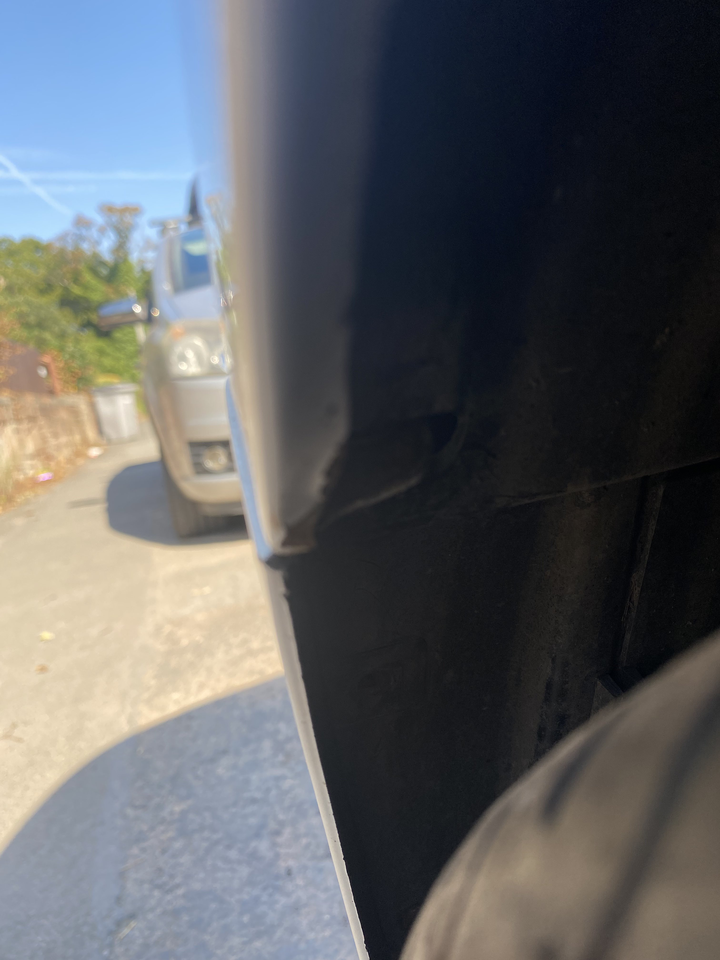

Right, I will work bottom up… left side 2 correct bolts, next bolt m6 and the washer has bored a hole.. next has a screw.
Drivers side wing to bumper has a m6 forced in. Other side has a m6 nut/bolt.
Slam panel has the rusty bolts that are meant for under the car as the new slam panel was tapped with a m6.
They’ve snapped the click clip mounts.
They garage telling me that’s how it came in. I’ve owned this car 4yrs and understand how to fit and remove my bumper in 10mins… oh my how can somebody do this to my car..
Where they’ve forced the m6 into the wing, they’ve bent a lip outwards on both sides because they’ve used a spanner and not a socket.

That lip should gently bend back but could break the paint! As for the bolts .. do what you can some grease may help lubricate I just hope your threads are ok!
