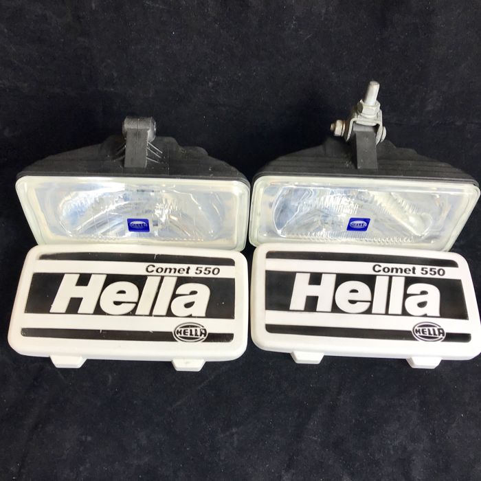

I worked on these in the early 80's when they were new and from memory the driving lights that we fitted [HELLA] only came on with main beam and were fitted with 55watt bulbs
The HELLA lights were made of steel painted black in a crackle finish paint and had stainless steel lens surround with a HELLA lens cover which you removed prior to use and helped protect the lens from stone damage
Luigi
Here you go
Luigi

Grazie mille Luigi!
Is that Still using the main beam 10A fuse? Using 65W main beam and 55W auxiliary lamps takes that to 10A exactly, using a 15A fuse gives a little overhead but will the cables and connections take it?

Hi
Im pretty sure there was a switch for the driving lights on the switch panel so as to NOT have them on on main beam
I'm also positive that we fitted a relay for the driving lights on that connector you have and then picked up a live from the fuse box to power the lights on a 8amp fuse [I think] this would then not put any more load on the wiring to the main beam circuit
