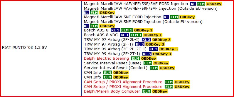

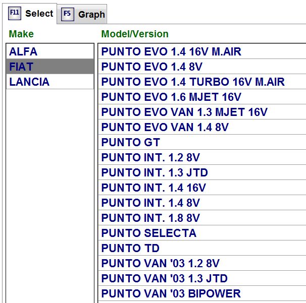

no leads for 3 pin like mk1 puntos then? i see they are listed in the soft ware.
it has no punto mk2b listed, it has....
punto '03
punto INT
Is Punto mk2b the INT? :confused:

These are the Puntos listed in the FES program.
Re: FREE Fiat diagnostic software
Generaly when something says, for example, Punto 03, it means the 03 model, ie 03 on.
Whether FES connects or not depends on what ECUs the car has. If you try connecting to a different car than the one selected it shows a message something like "Wrong ISO code, do you want to continue anyway? Y or N"
You could try working through the list of Puntos pressing "N" until you don't get the message, then you would know which one you have.

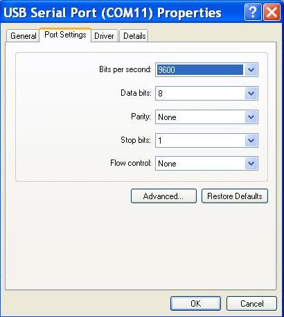

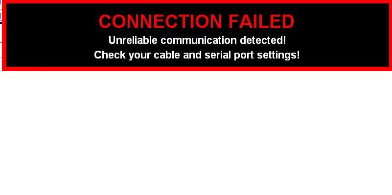

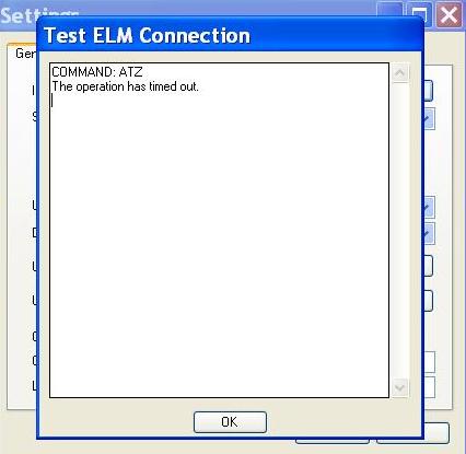

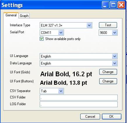

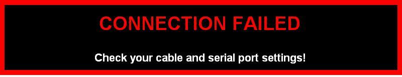

what am i doing wrong? i have the gendan set ( eventually found it delivered to under car in garden, but thats another story), i plug in the elm set port same as in device manager set speed same as in device manager, did test and it was ok, then whent to do proxy alinement and it kept saying error check lead and port setting, dont think it needs adapter i tred them anyway got same message.
whent back to setting doubled checked them they seem right, tried to run the test again and it says timed out.
think i am using right lead
only 1 light is on on the blue box and that is power light, and ignition is on
edit car is punto mk2b 2005 1.2 8v
but if i click scan, it says scanning for modules, then done!

I have exactly the same problem Dave let me know if you work it out im using the gendan kit but it wont connect to our multipla cannot try it on any of my other five fiats as they all too old!
ah i posted on yannis site and he says
You have to set the port speed (under Test button in FiatECUScan settings) to 38400.
I have set port speed under the test button to 38400

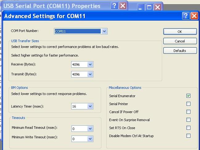

I have set latency to 1
test elm connection now works
i am still getting error check cable and port settings when trying to do proxi alignment:(
the error message is slightly different to yesterday
and all the lights on blue box flashed like a disco

I charged battery for problem car it read 13.9 volts after i let it settle after charging, put it back in the car and dash display stopped flashing so i didn't need proxi after all :bang:
Your Battery Stopped you proxy-aligning the dash? sounds odd
But the Battery Recharged realigned it all? :S
Very Weird Dave.....
At that you have a bigger battery in yours lol
Ziggy
Ah right :) - Still seems weird how a low battery stops the system been updated?
Or is it a failsafe feature to prevent the battery dying while an ""update"" is been applied? like you get on the Sony PSP?
ziggy
i dunno but yanni said it would be battery and it was, maybe the elm needs full power?
ah battery fixed dash flashing but not elm connection, yanni reckons could be bad earth some where or noise on can line
