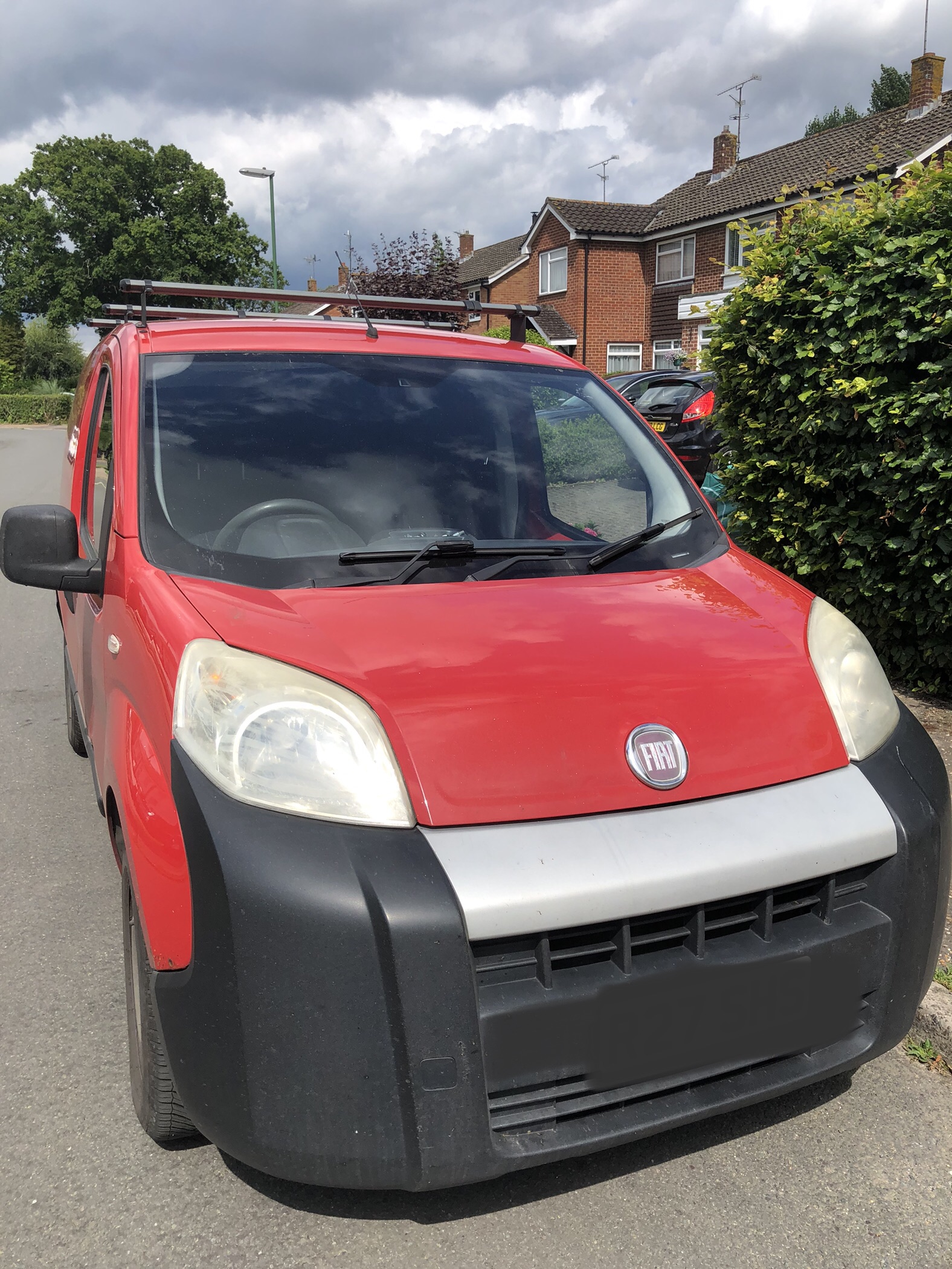

I have this little red Fiorino 1.4 Van MY2009. Does this share its chassis with other cars where I can fit something very naughty under the bonnet or is it doomed to me thashing it to death on a daily basis ? I’be taken note of you lot dropping sexy names like Corsa VXR and Arbarth, which sound promising, but unsure what’s possible yet ?
Awaiting your knowledge and expertise on how to chuck money at things 👌
See abs stunning (not) pic of “Pat the Van “ who’s waiting to debut at The Pod anytime soon.

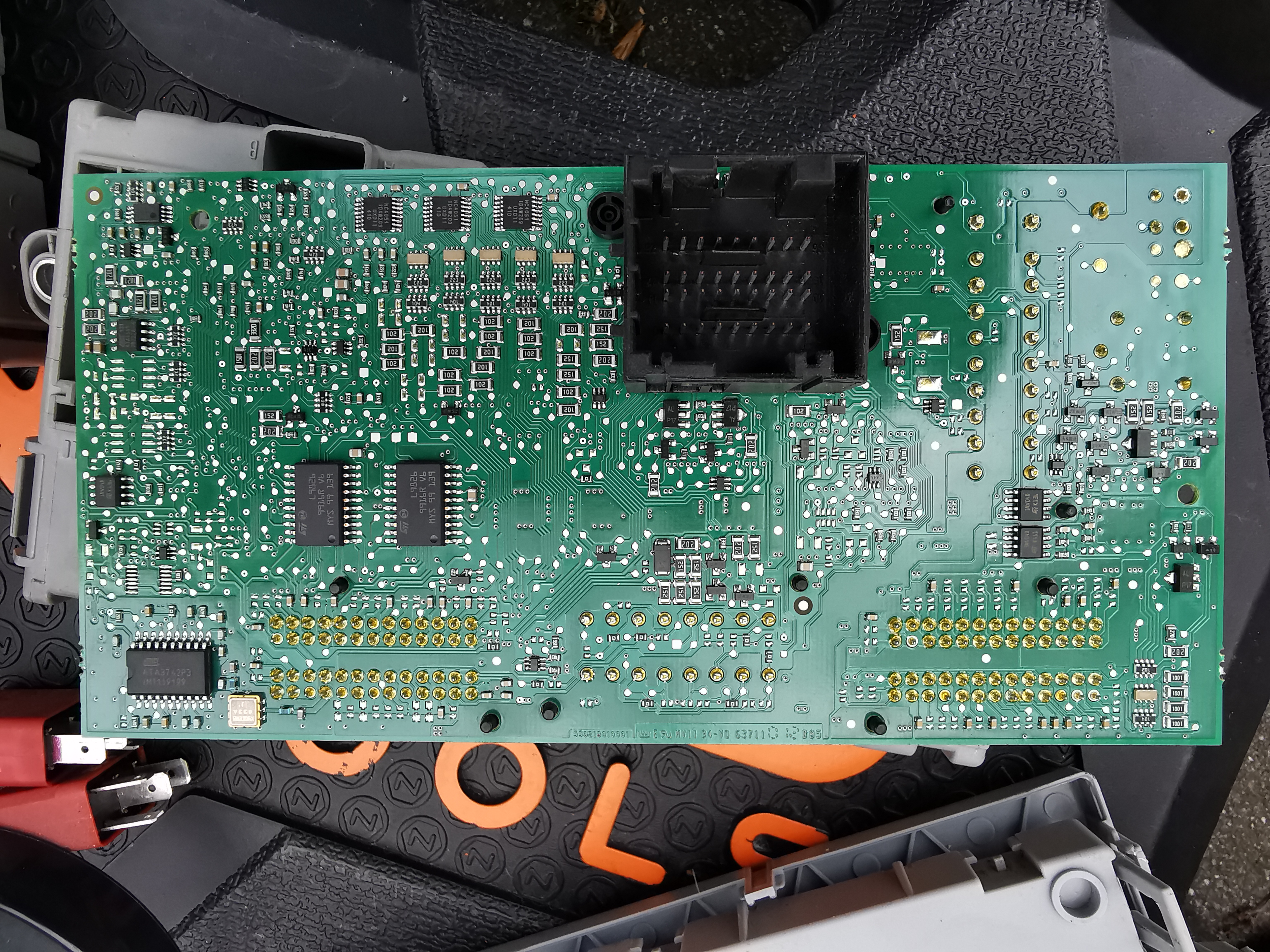

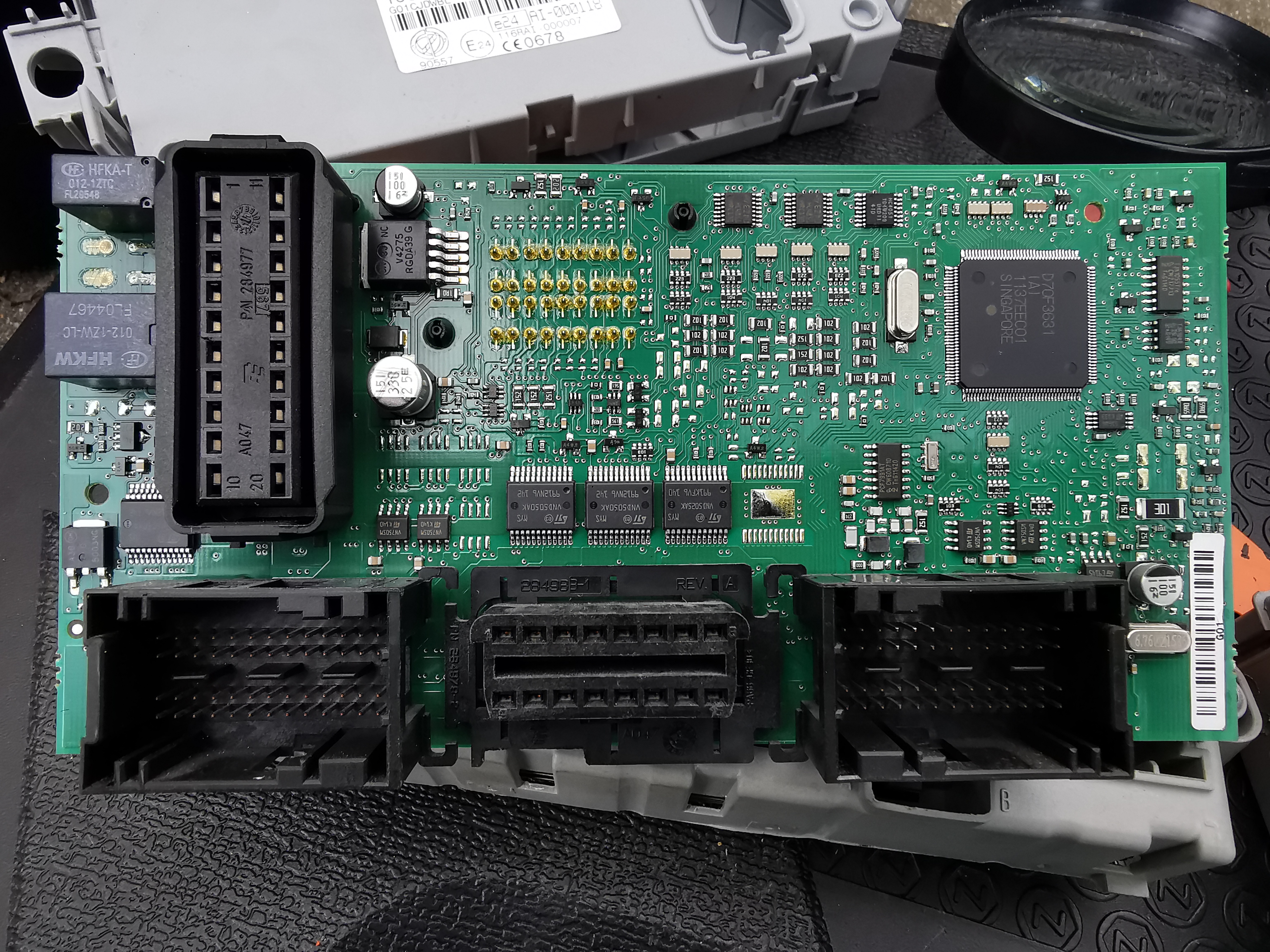

Just to let you have an idea, those are photos of the motherboard of the body module of my 2011 Ducato x250 (model launched in 2006):
