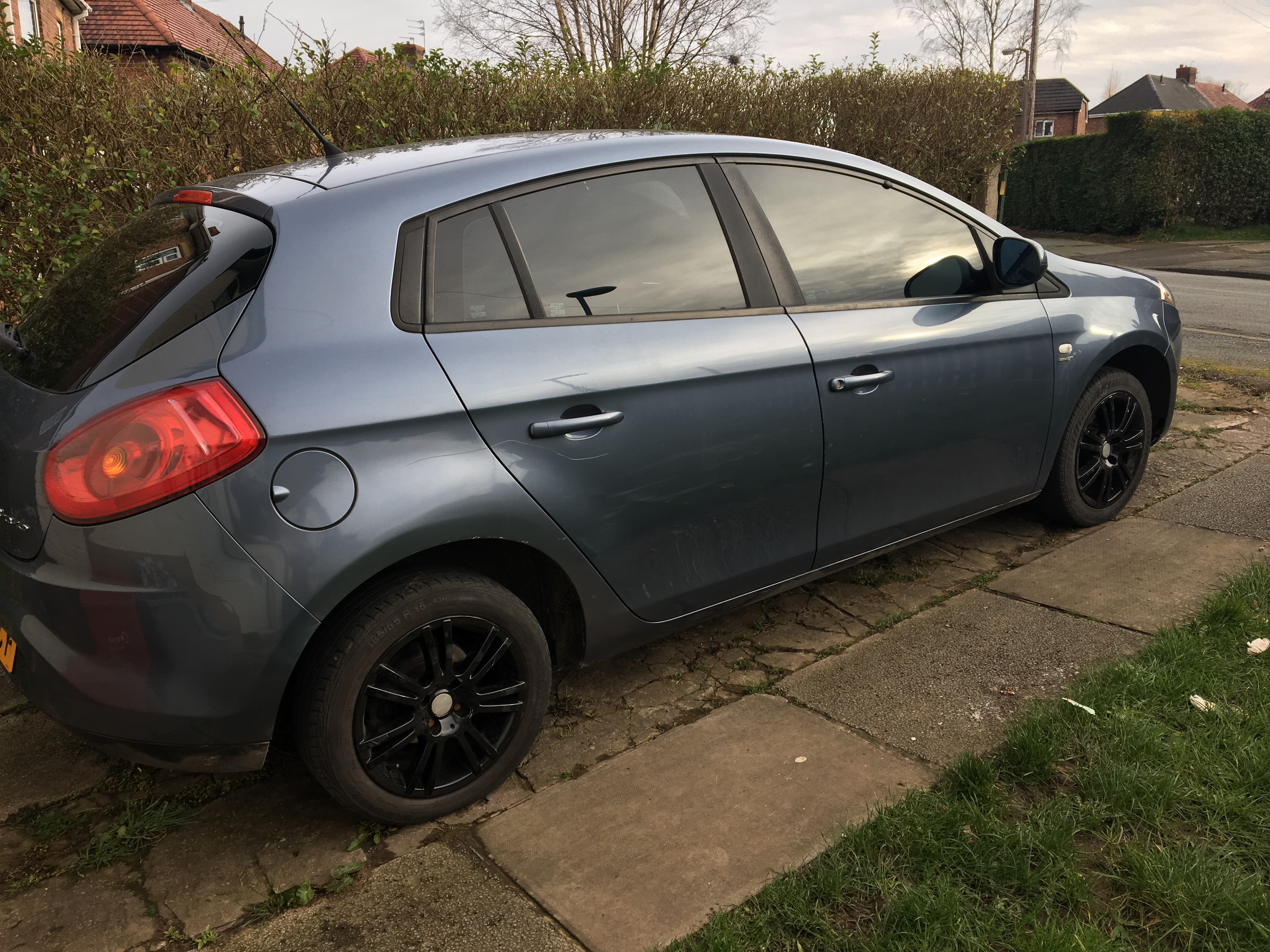

Thanks for your reply aurick86 I went to get them and they were 15's anyways. I still got them and they look fine for me although my mechanic mate that came with me said they look like clown wheelbarrow wheels as I've gone smaller.

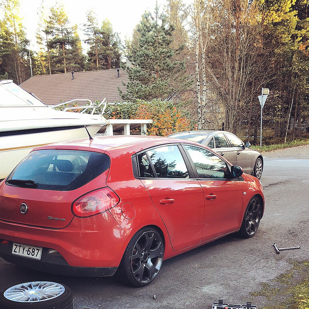

in my view, 16 is good for the winter. 17-19 wheels for the summer
(my winter wheels 16x7.5 et33)
my summer wheels 17x9 et 33
new summer wheels 19x9/10 et44/50 + 25mm spacer
