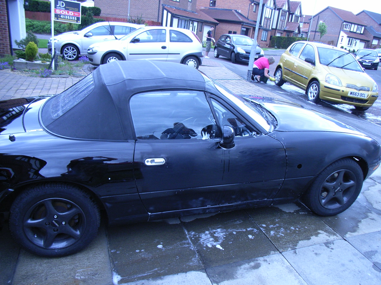

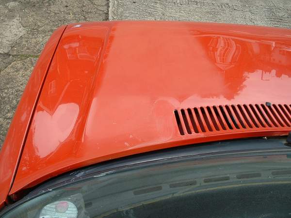

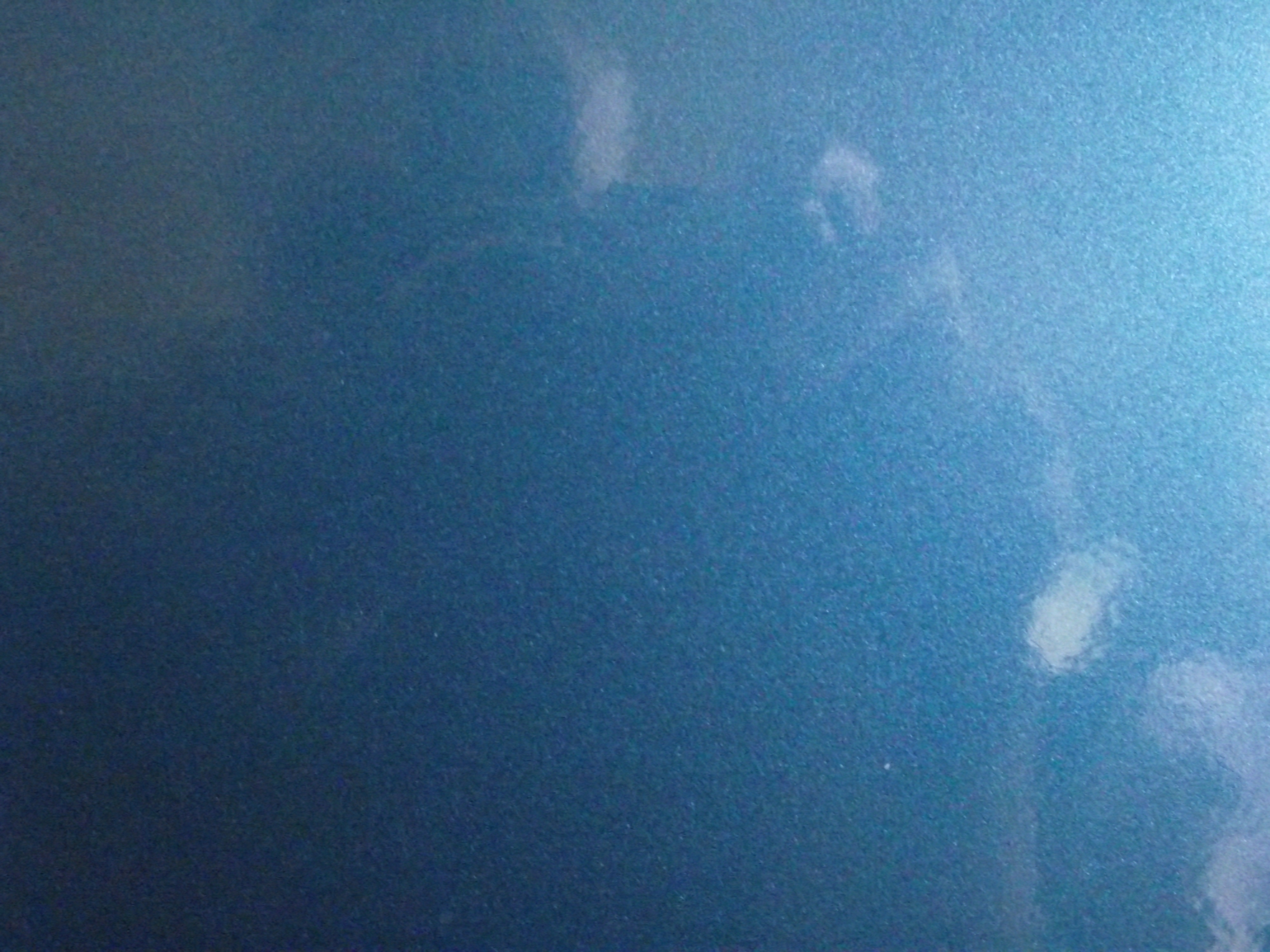

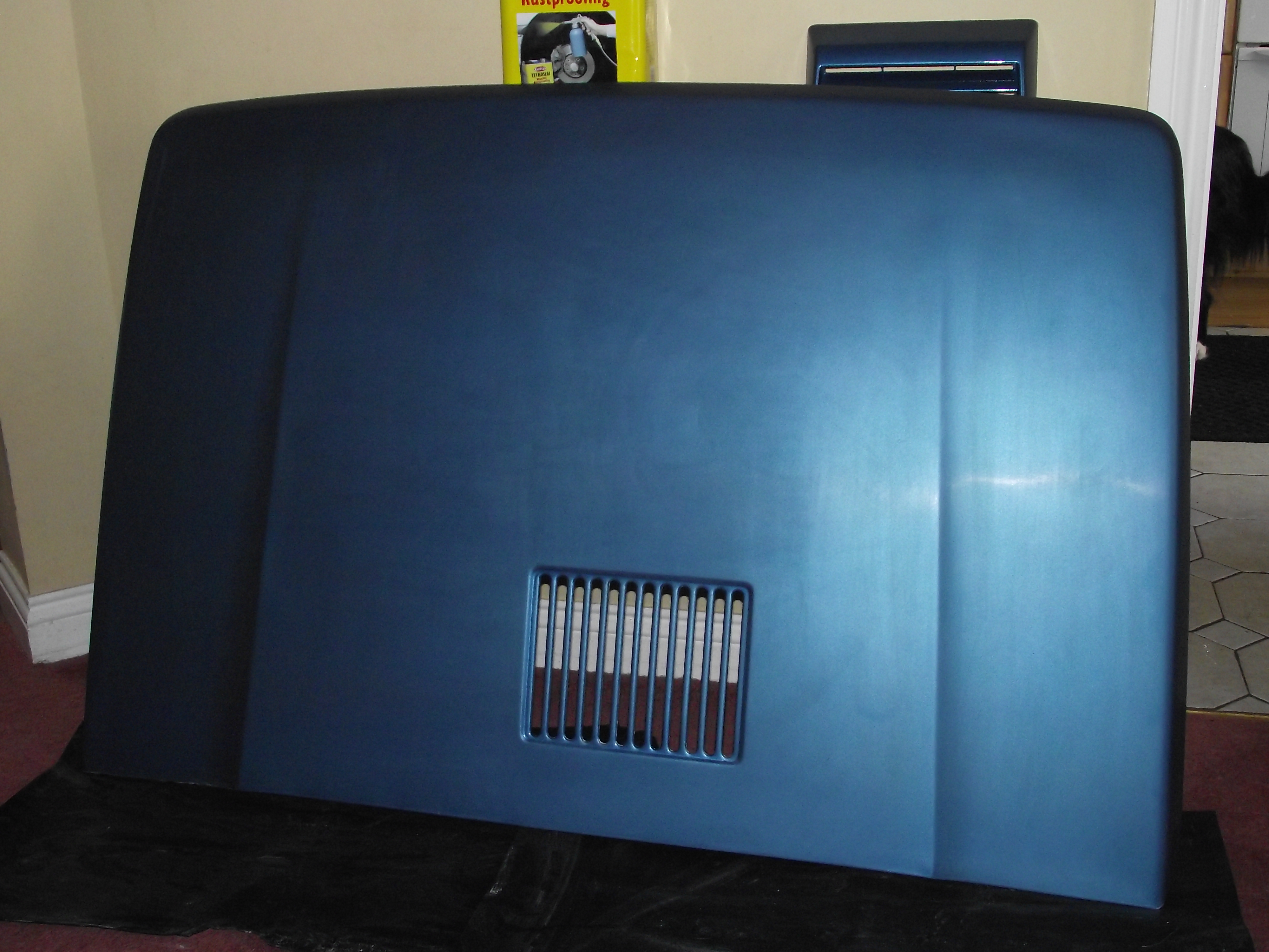

Anyway here are some pics of a friends MX5. It would not hold a shine at all, he had tried T-Cut and the Maguire’s polish but it still looked crap. So we set too one day and this was what we did, I'm afraid I don’t have any pics of the before, but I have some of the during and after.
The first pic shows the rear already done and us moving onto the door and front wing.
Second Pic is of the bonnet being done.
Third is the bonnet finished.
Last pic is the boot lid showing the reflection of our house.

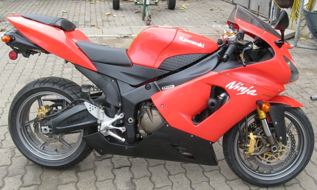

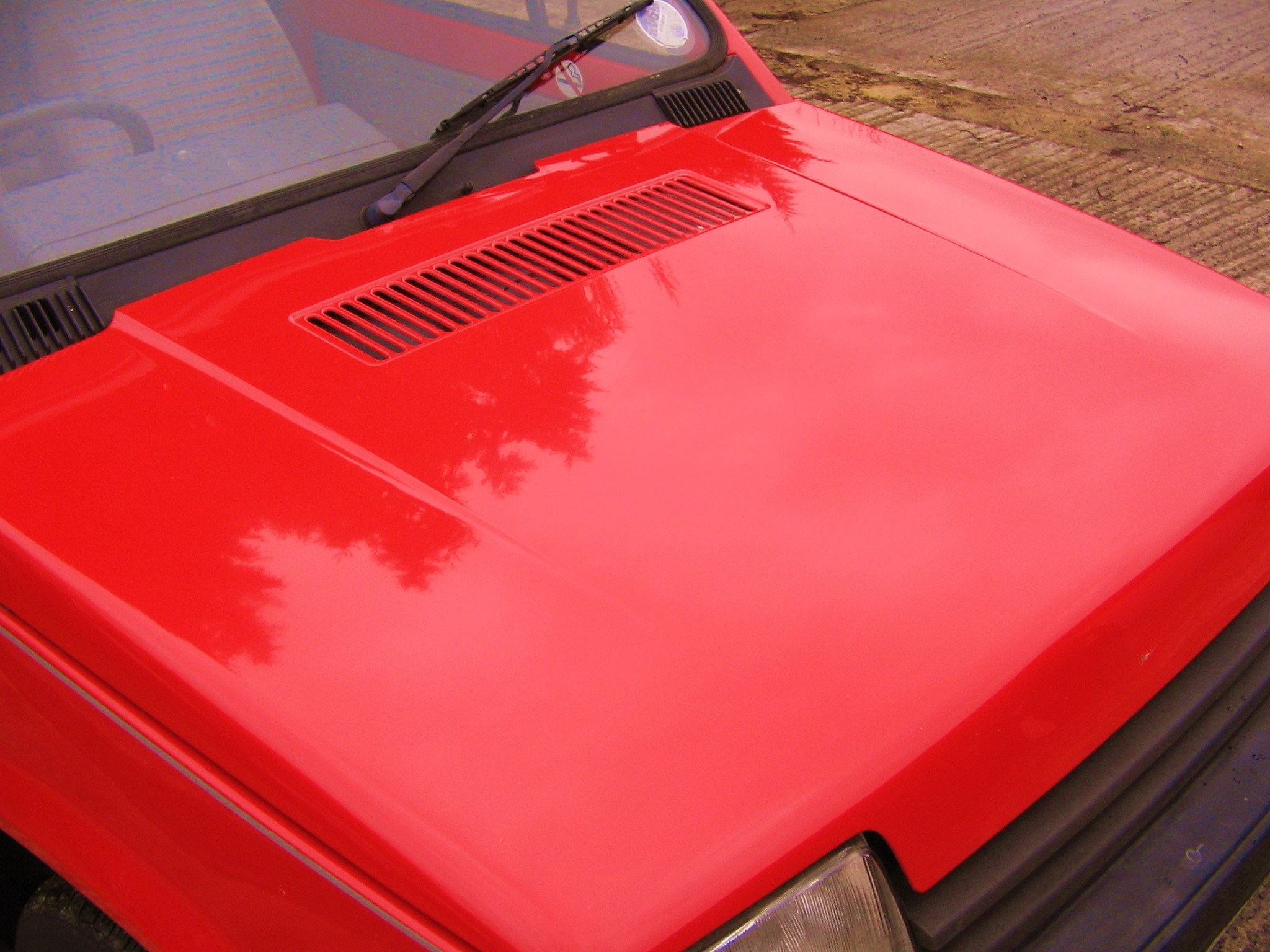

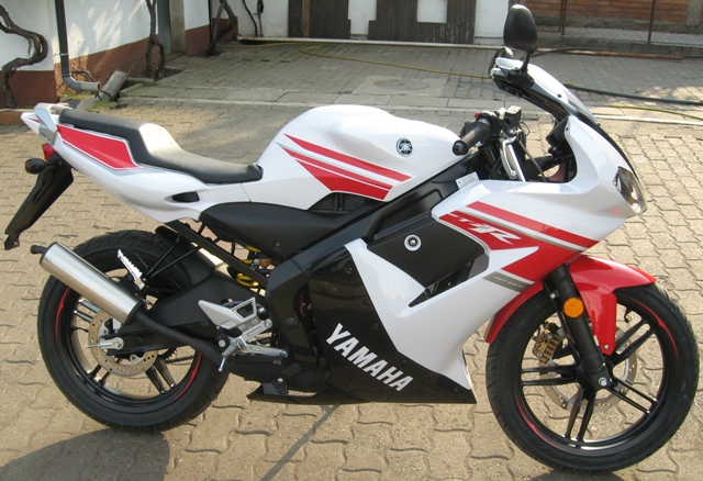

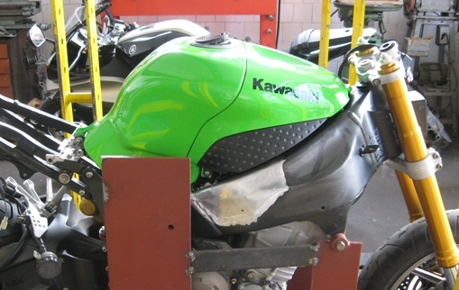

Hi all.I have alot experiencein polishing and painting.I use farecla compaund( G6-G3-G10 in that order) for less demanding stuff.For the real good polish I use 3M paste's.I have 2 variable speed polisher's,bigger for cars and smaller for bike's. I use 2000 wet sanding,for 3M I have 2 rounds for each compaund.
Here are some pics.All wet sended(2000) and then polished with 3M.

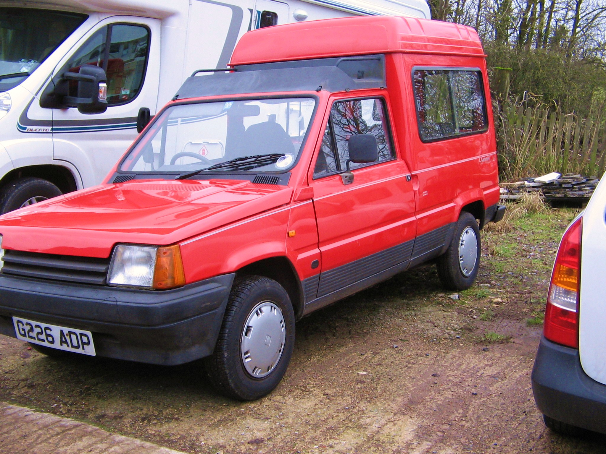

I've been polishing up my new Terra this weekend so thought I'd show you the results. I don't have a professional polisher yet so had to use cutting compound and elbow grease. It's alot more surface area than a Panda so I did try an electric polisher to save time, and yes it was a £20 one from Halfords, but can only confirm that despite being cheap, they are a waste of money. The one I used gave up with worn brushes half way through the first side. It is a couple of years old but the owner I borrowed it from said that it hadn't had a great deal of use. Plus, when I was using it it was only any good for large flat areas due to it's size.
Before...........
And after..........
It did come out quite well considering, but it would have been even better and more easily achieved with the right kit.

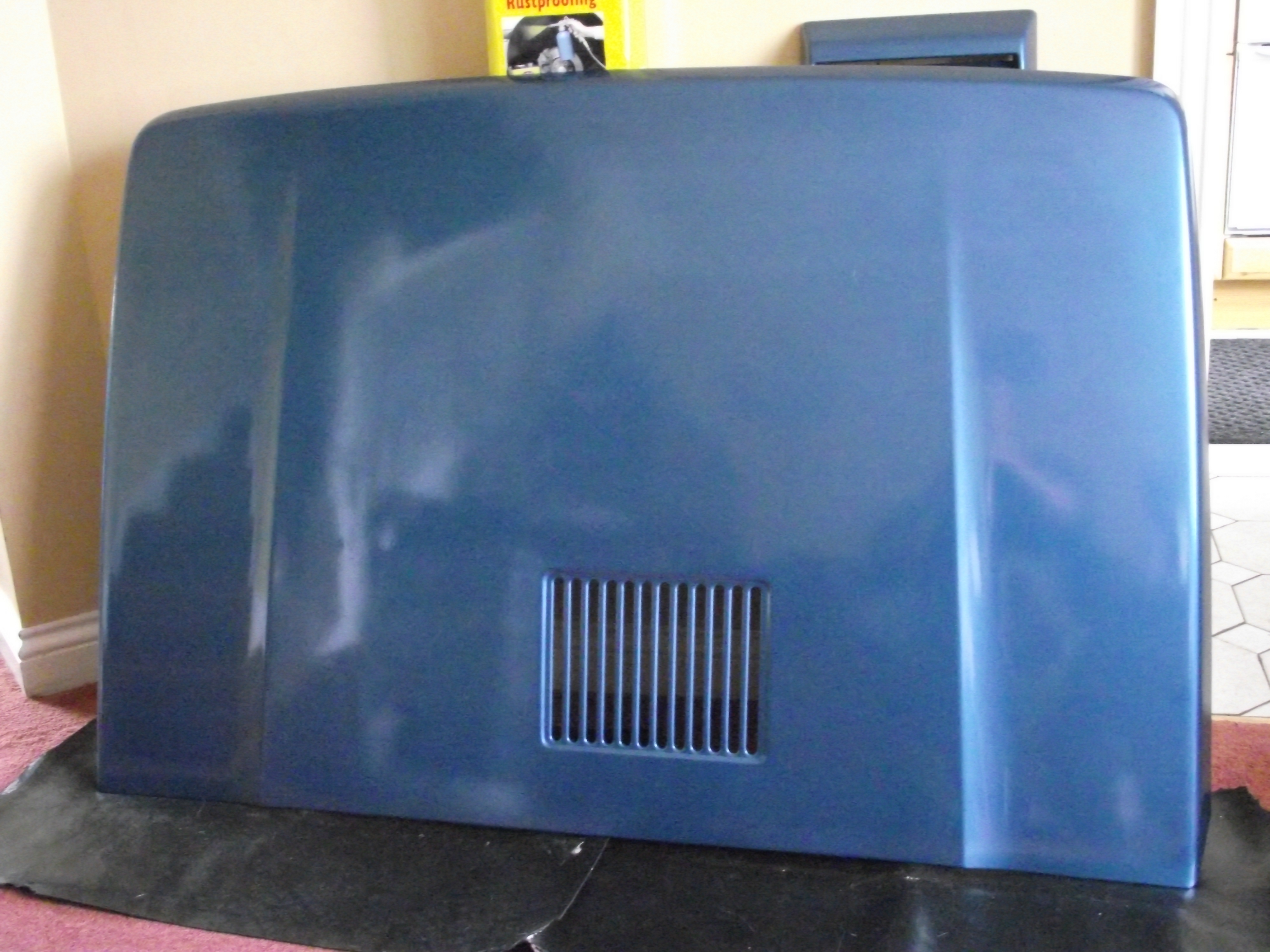

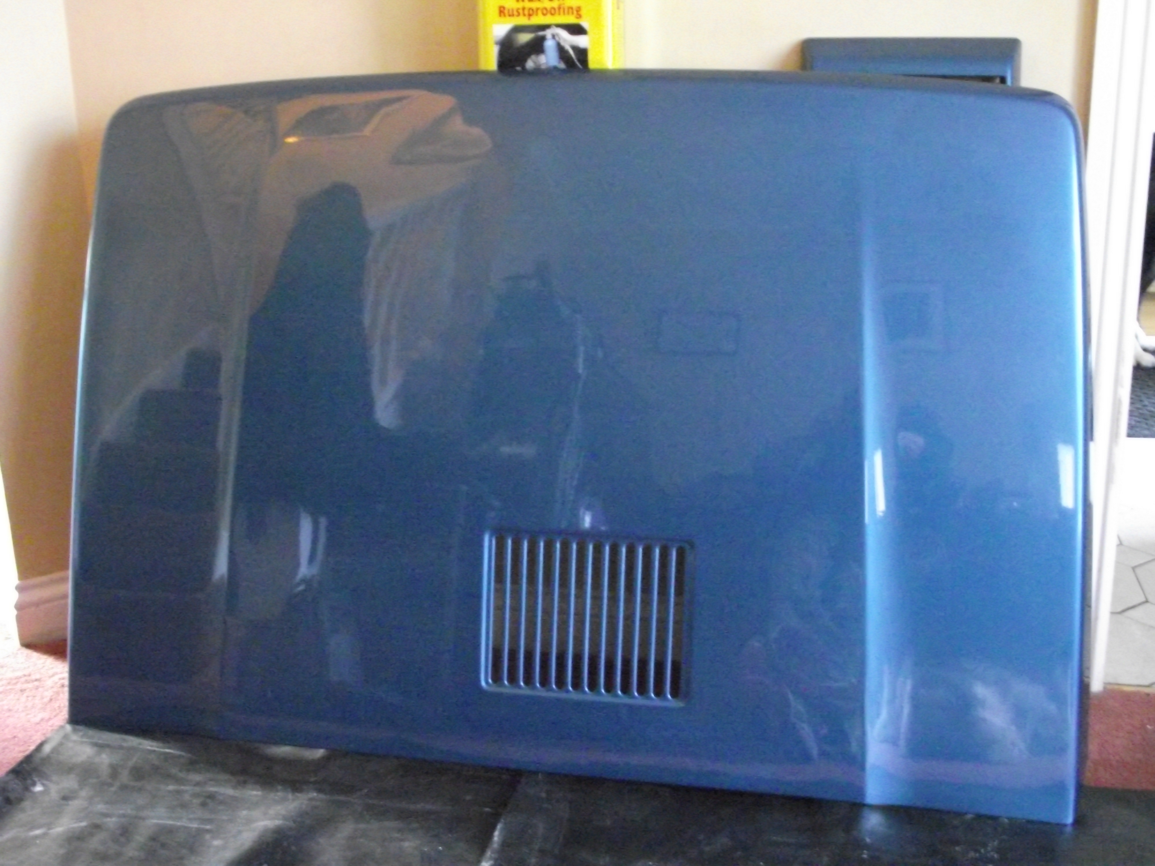

This is a re post of pics but its a shame not to finish off this post.
Pics are painted, sanded polished :)
