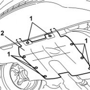

Yeah its on Elearn mate (7055b54 if you're interested), it shows it on all versions though I've only took one off a multijet 150 so far.
Two 10mms at front and two at rear, with screws along the side.
