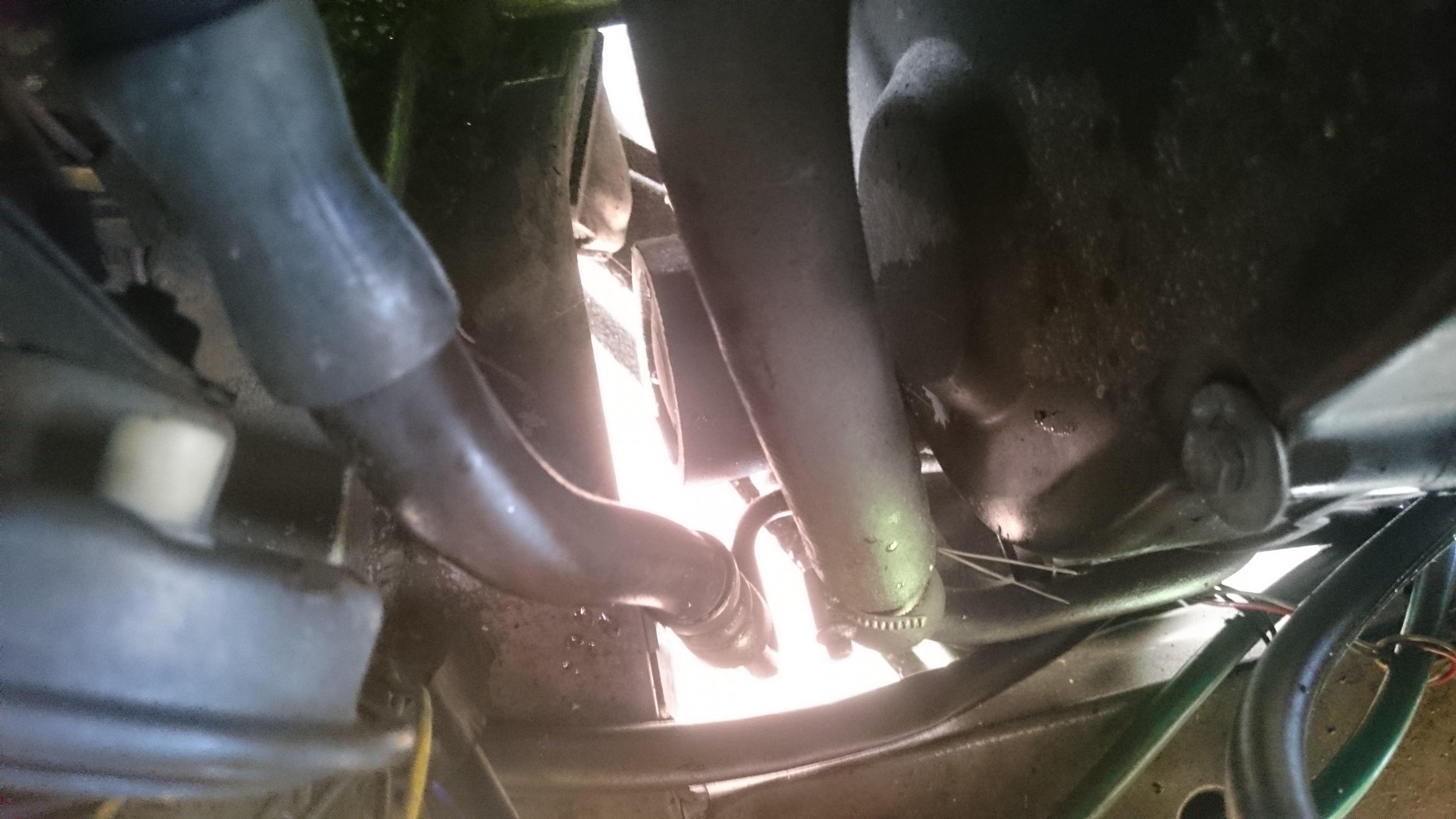

Here is a photo. It seems to be coming from the right hand side of the engine bay.

So it looks like a section of the pipe has been replaced by a previous owner and it's now leaking at the lower metal join.left hand rubber hose

Best bet is find a place that does hydraulic hoses for diggers etc, they will have the fittings to make up a new one,
