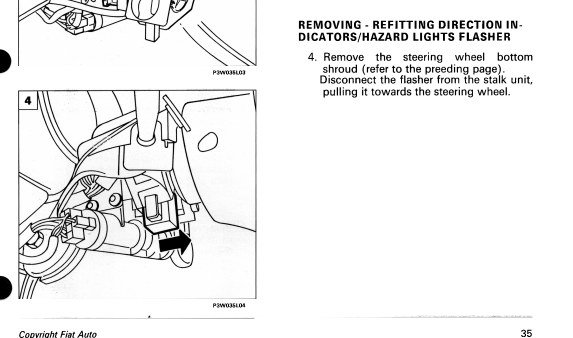

Hi all. Does anyone have knowledge where 1999 Barchettas flasher relay is located. I have found nothing from the service manual nor the web. I need to replace the relay.
Not looked at my car but page 35 of section 55 of the service manual indicates that it is on the end of the indicator stalk revealed by removing the steering wheel bottom shroud.
Yep, under the bottom shroud. Easy to access and remove. Try a squirt of WD40 on the contacts before you bin the old one. It worked on mine, and I've not had any trouble from it since.
When mine stopped working I found that pushing and holding with a finger it would work, So I just squeezed the two connection slightly to give a tighter fix and its continued to work for 4 years without any problems.
