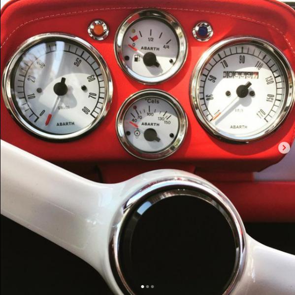

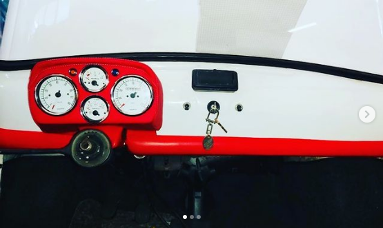

Ronstox; I have never had any success at putting pictures on to the Forum--if you contact me directly-- [email protected] I will send you some pictures of my instrument cluster. On the 'L'model with the big instrument cluster, they are a real P.I.T.A. to fit--you have to cut quite a bit of the dash away, and where you do have to cut makes it impossiblt to refit the original instrument cluster-- the 'D', 'F' and 'R' models with the small instrument cluster make it much easier to fit an "Abarth" style cluster. My cluster has a tacho, electronic speedo, oil temp gauge and oil pressure gauge along with various warning lights. 'Mechanical' speedos are available, it is just that my kit came with an electronic speedo in it.

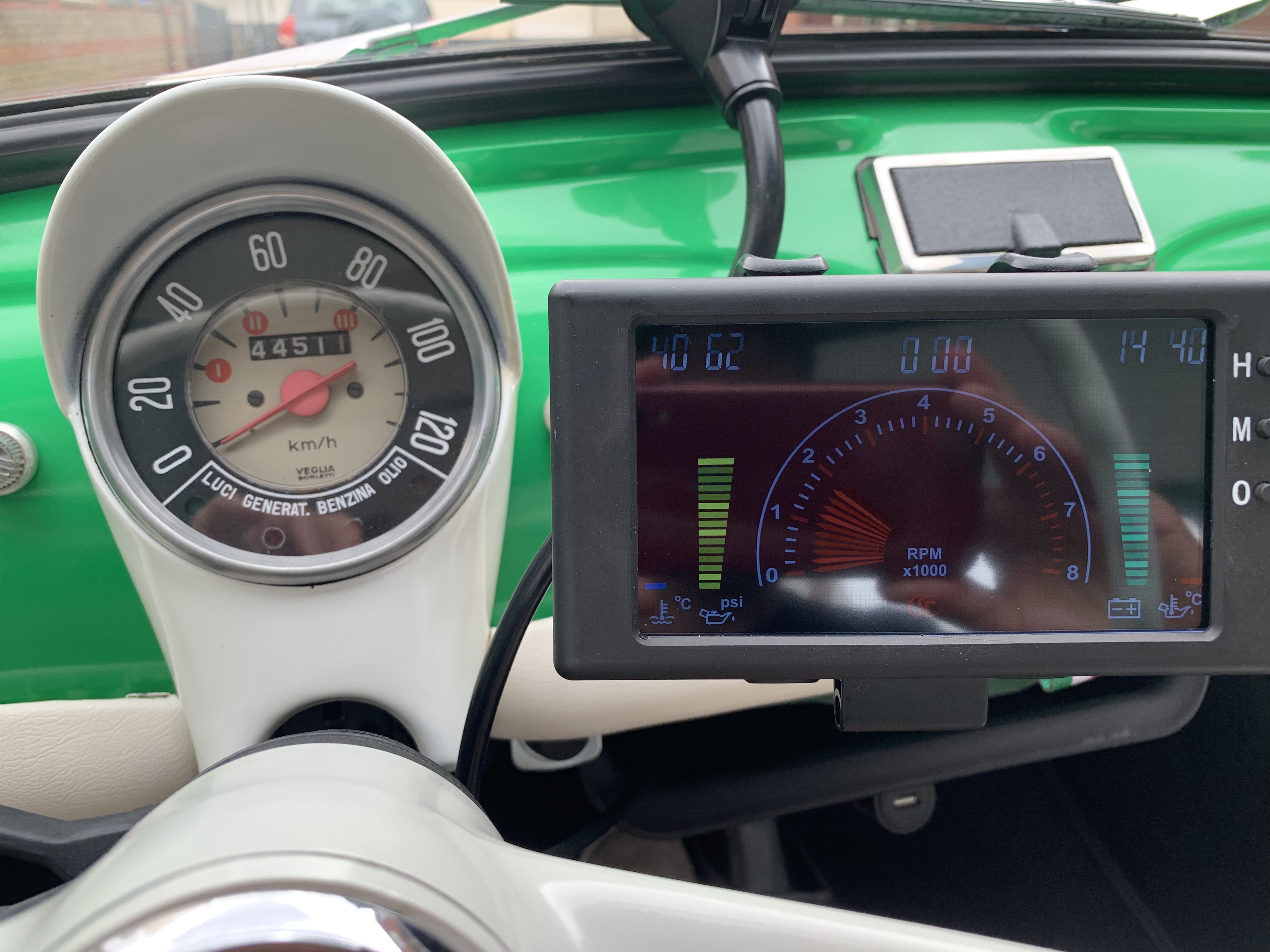

Picture from a friend of mine and his during build.

Oh, that looks nice. Thanks hobbler & lazylobster. I have a 500F and I really like the original instrument cluster, but I would also like more information about the engine in real time. I'll probably go with something like evmaniac's or lazylobster's solution
HI Ronstox, for my LCD display, all in parts around £110. Mostly electical wiring.t-piece for the oil pressure sensor to keep orginal working on the round speedo. Had to tap the oil pan for the oil temp sensor. What I like about it is, that you can unplug it and remove the suction mount and revert back to original look in approx 1 min.
