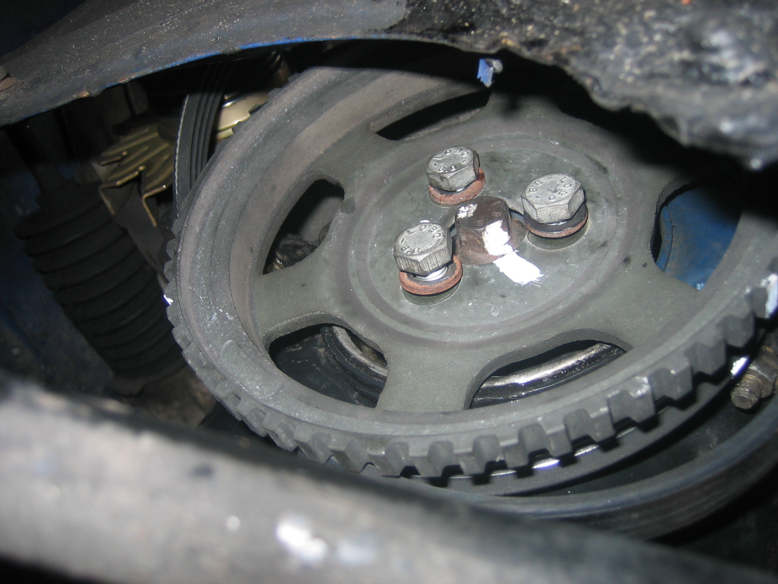

Yes you right...fiting alternator is not very easy....there is not enought room because of "injection" equipment:)
...back to belt...
Unfortunately there is a sensor in Magnetti injections (system with twin coil)
so you've got 2 option...take sensor out, but I couldn't...it sticked and didn't want to go out so I decided to take that timing/alternator wheel and fit belt...it's quite easy - just 3 bolts and done...
See picture

it's not so bad...
try to drive (driver front site wheel) on some brick (or stand if you have)
then put some cardboard on the floor...right tool (if remember it's 13)and take that wheel off...put belt and fit it back...make sure that you put in back into right place (there is smal "sign") You can't do it wrong :)
make sure that you tidy bolts !!
and done:)

that small metal wheel for alternator belt can be fitted in only one possition (there is some inset)
