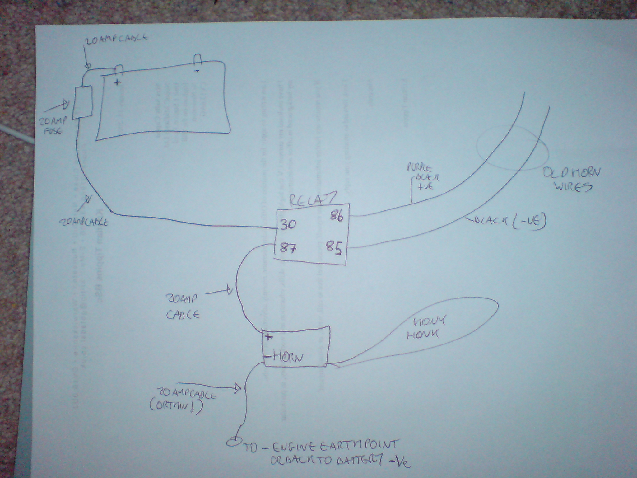

right, can someone please do me a SIMPLE diagram !
im not hot on electrical terms etc. There has been a lot written here and a little confusion too.
A simpe diagram would be great. Also, where do the 2 currect red and black wires on the horn-push go to? Is one + and one - ?
a SIMPLE diagram PLEEZ!
many thanks
Mikey
my drawing skills are to be feared :eek: :D :slayer:
That should see you good :)

brilliant, cheers the 2 of you ! exactly what i was after !!
makes it much easier now.
One final question.......the 2 wires at the steering wheel horn push, presently one red, one black, these ok? i note from your diagram that one is black the other purple?
what will the red be and the black be?
I'm not going anywhere near the steering wheel with my thinking.
I am on about using the two wires that currently connect to the current horn in the engine bay. That way the relay can be placed next to the horn, and you have to do far less fiddling. with routing lots of wires.

ok i get ya there.
But can someone tell me what the 2 present wires are/lead to from the horn-push. 1 black, 1 red. Does one go to ignition? What should i do with these?
