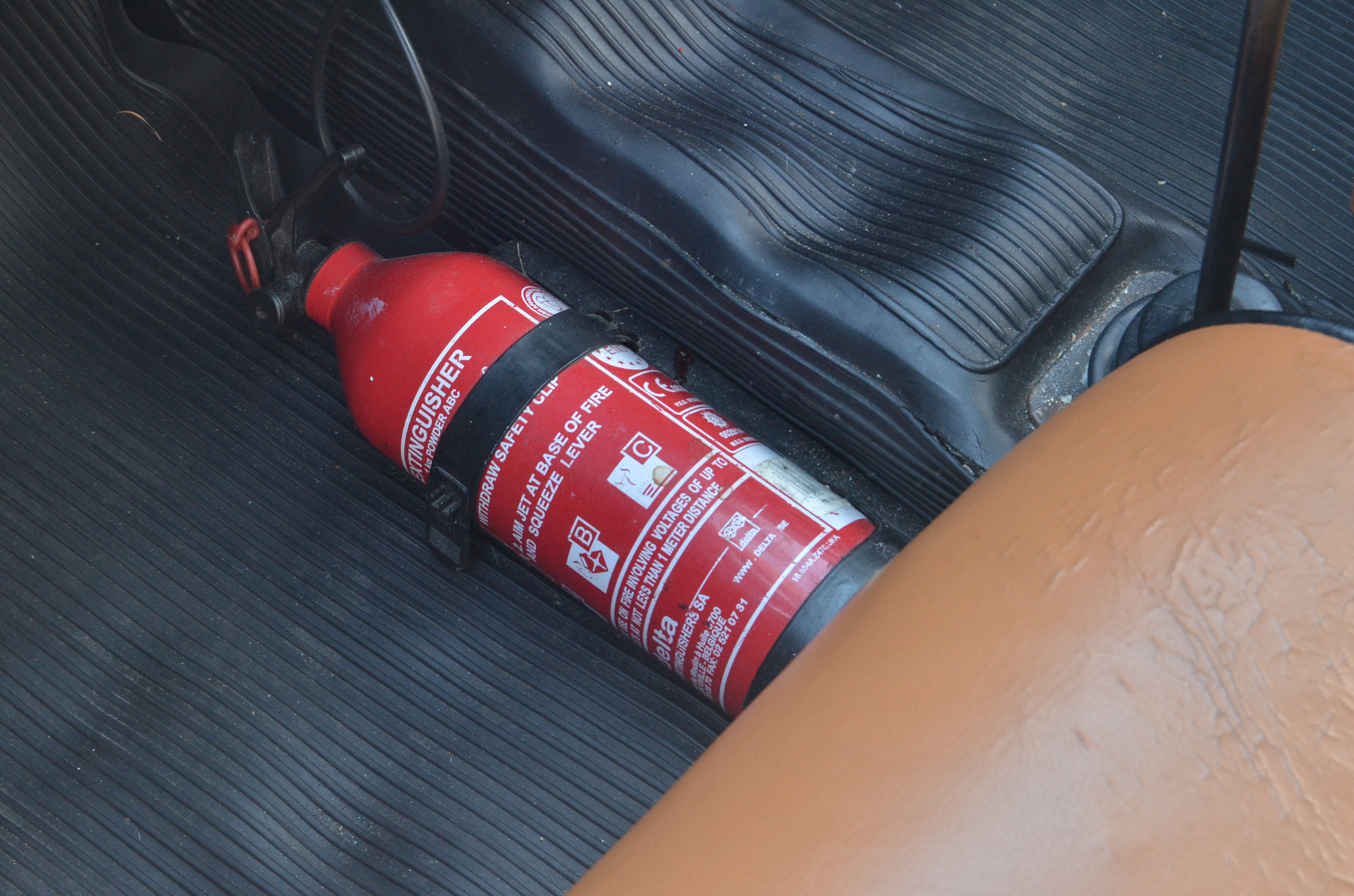

It's about time I fitted Barry with a fire extinguisher and I have purchased a small 1kg model. If you have one fitted, where exactly do you have it located?
IMG_0688.JPGas per image...

I've seen a lot sited across in front of the passenger seat. Few people put their legs there, and it does not get knocked as much as on the tunnel. But, does not work well with tilting seats. Horizontal seems better than vertical, as the powder will settle harder if vertical.

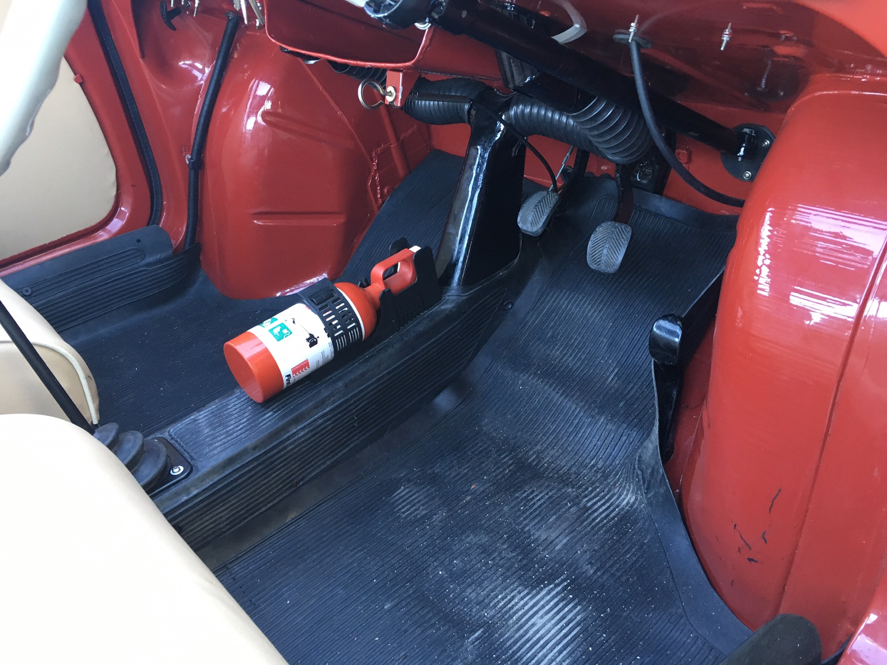

I welded two M6 nuts to the side of the tunnel at the correct centres for the bracket, and then screwed it on like this. It's not too much in the way for those rare times when I have a passenger.

Thanks Peter. I ended up mounting it under the passenger seat (nobody will ride with me for some reason) so I can easily flip the seat forward and grab it. I plan to have some fire drills too
