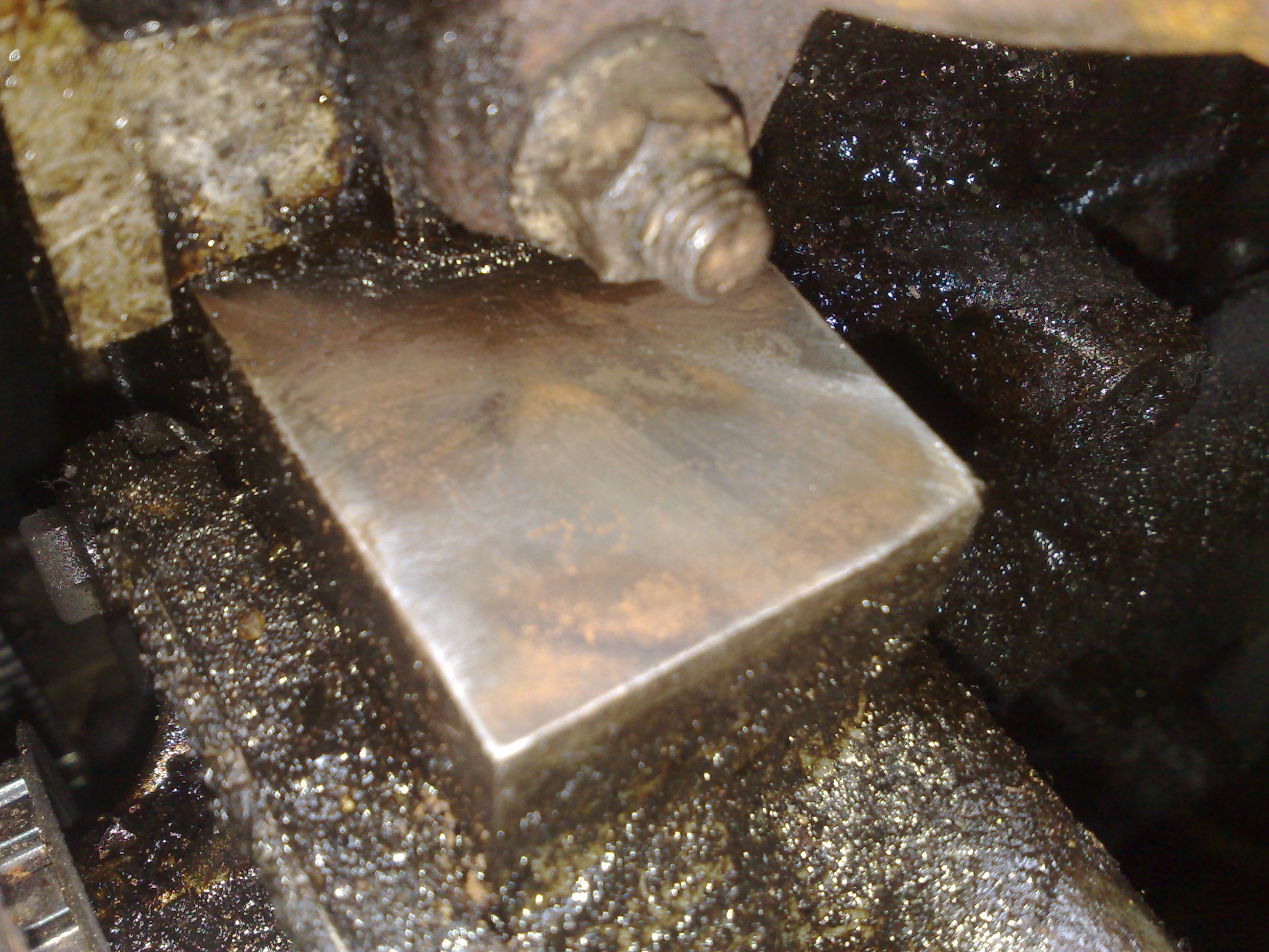

Right just got back from the scrappy.
I managed to forget to pick up the sheets I printed but found the numbers and took a photo of them.
Right the engine i had hopes for was a 176.B4.000. which according to the info i have is a Punto 60, from 1997 : 176.B4.000 (SPI) but this had MPI. (first pic)
now the second engine it was hard to make out but im 95% sure it said: 176.A8.000 (second pic) which is Punto 75, all years : 176.A8.000 (MPI)
The thing that made me doubtful on the second one is on the top of the head they have wrote (good engine 1.1)... maybe there wrong?
This had a hatch pattern on the head but i never took no photos becuase i was doubtful.

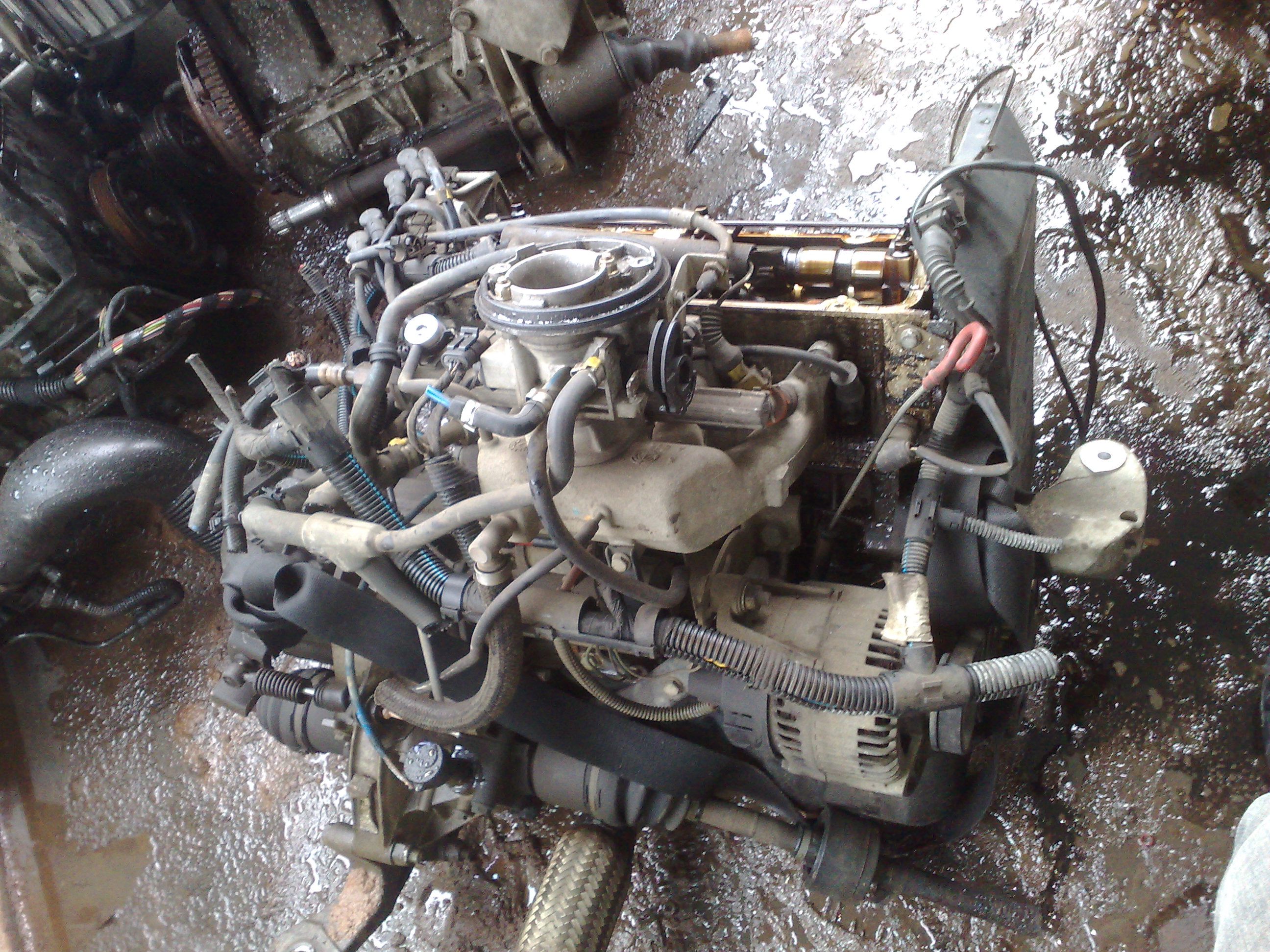

Right guys... just got back from the scrappy again.
I asked to remove the cover and it looks like the cam is a sexy 866! (see pic)
The mileage on the documents they make says the car it was from had only 9K on it! he said it seems stange but he can only say its right (engine dont look like its done 90k)
he said its mine for £100. worth it?

thats def an MPI engine. Punto 75 Engine.
it also looks like a different engine to the one in the first picture. looking a the exhaust manifold anway.
