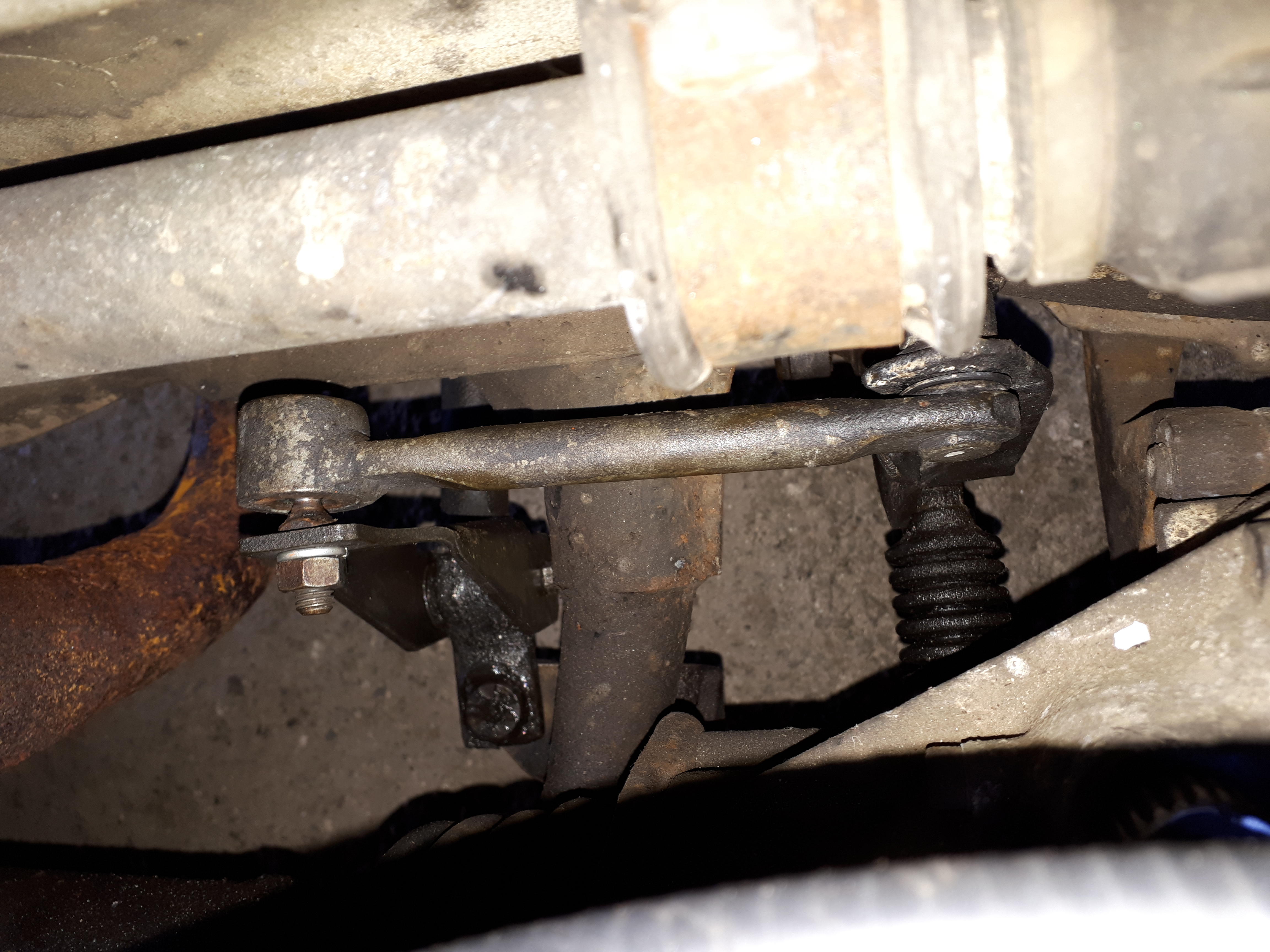

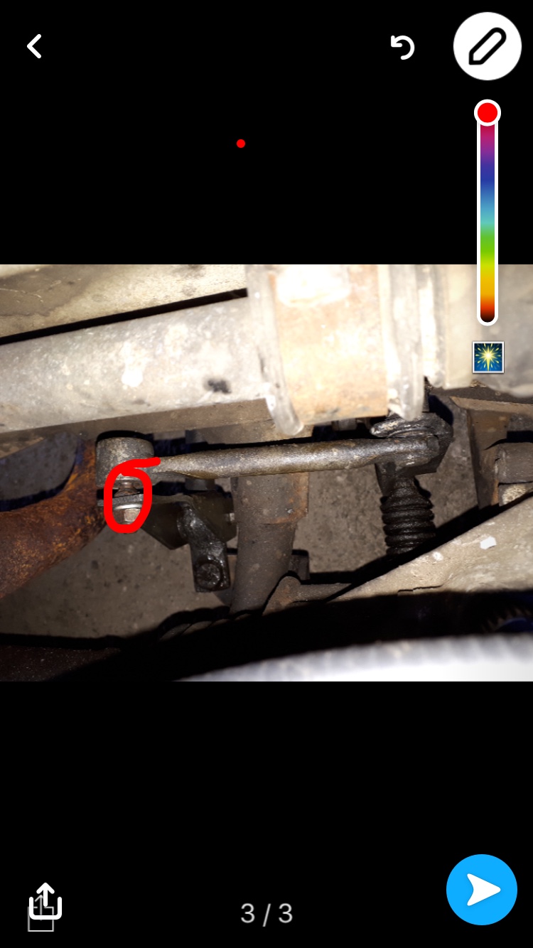

Does the gear box look like this.check where the gear cables fit ! IMG_7012.JPG
It's a 1990 diesel model...no gear cables...it's lever. I think the linkage might be shot...but finding another is a nightmare...spent hours searching the net but can't find one!!!

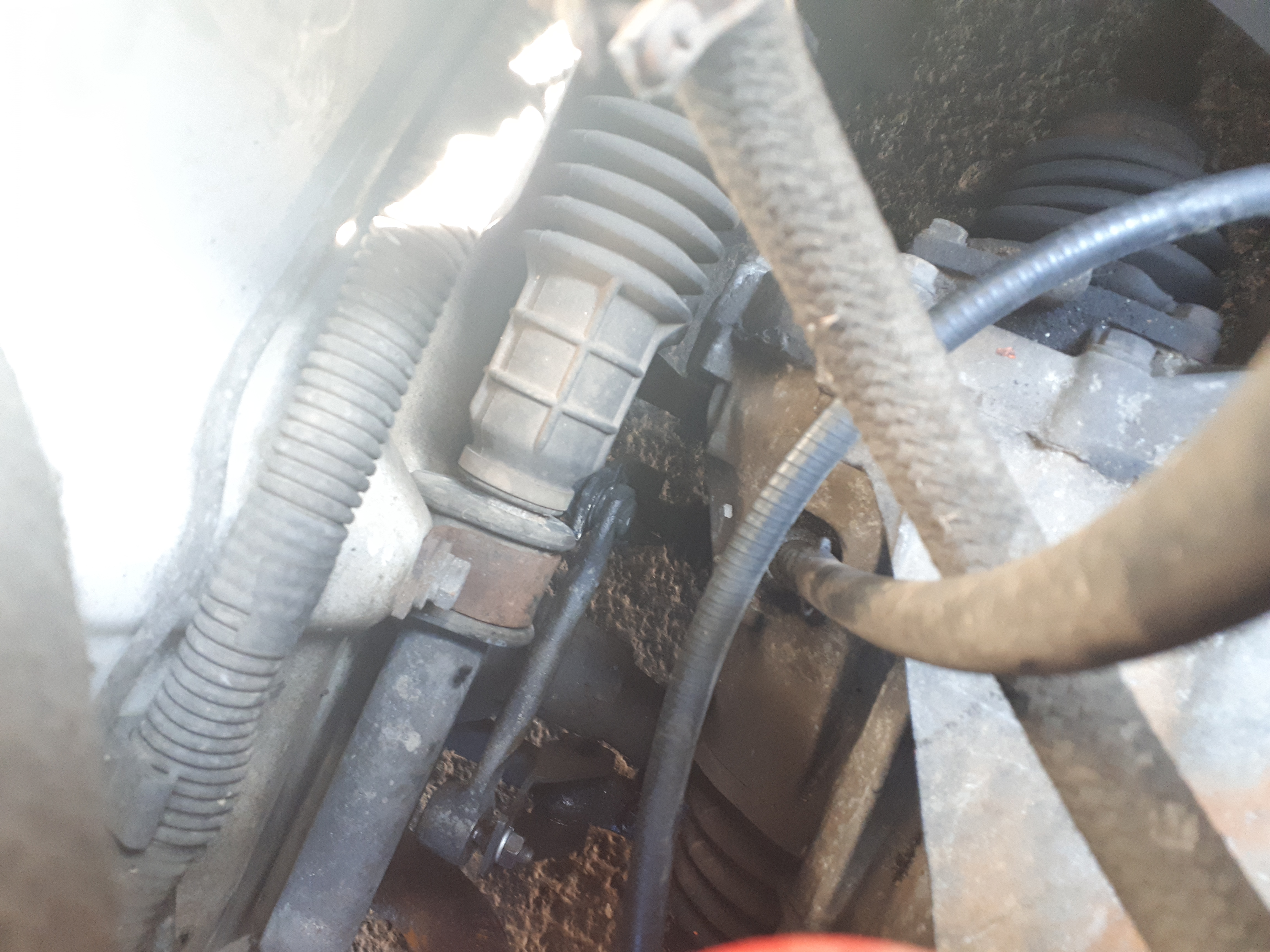

I suspect that too as it's both gears to the right of the stick. I'll try and get a picture but it's loose at the top left as you look under the bonnet...I'll go see if I can get a decent photo now.
The bit on the left is massively loose...I'm trying source a replacement now...but any ideas on how to bridge it on the mean time would be greatfully received!!!

The circled point yes...no mine's is more of a 3 piece part that creates a kind of n shape if that makes sense?
Item circled on your picture is a ball and socket. Remove the bar and check the bush.it may come out to renew. Can you take more pics of linkage and top of gear box.
Will do mate, I'll do it shortly...I can't find a refurb kit for it...don't suppose you know any suppliers?

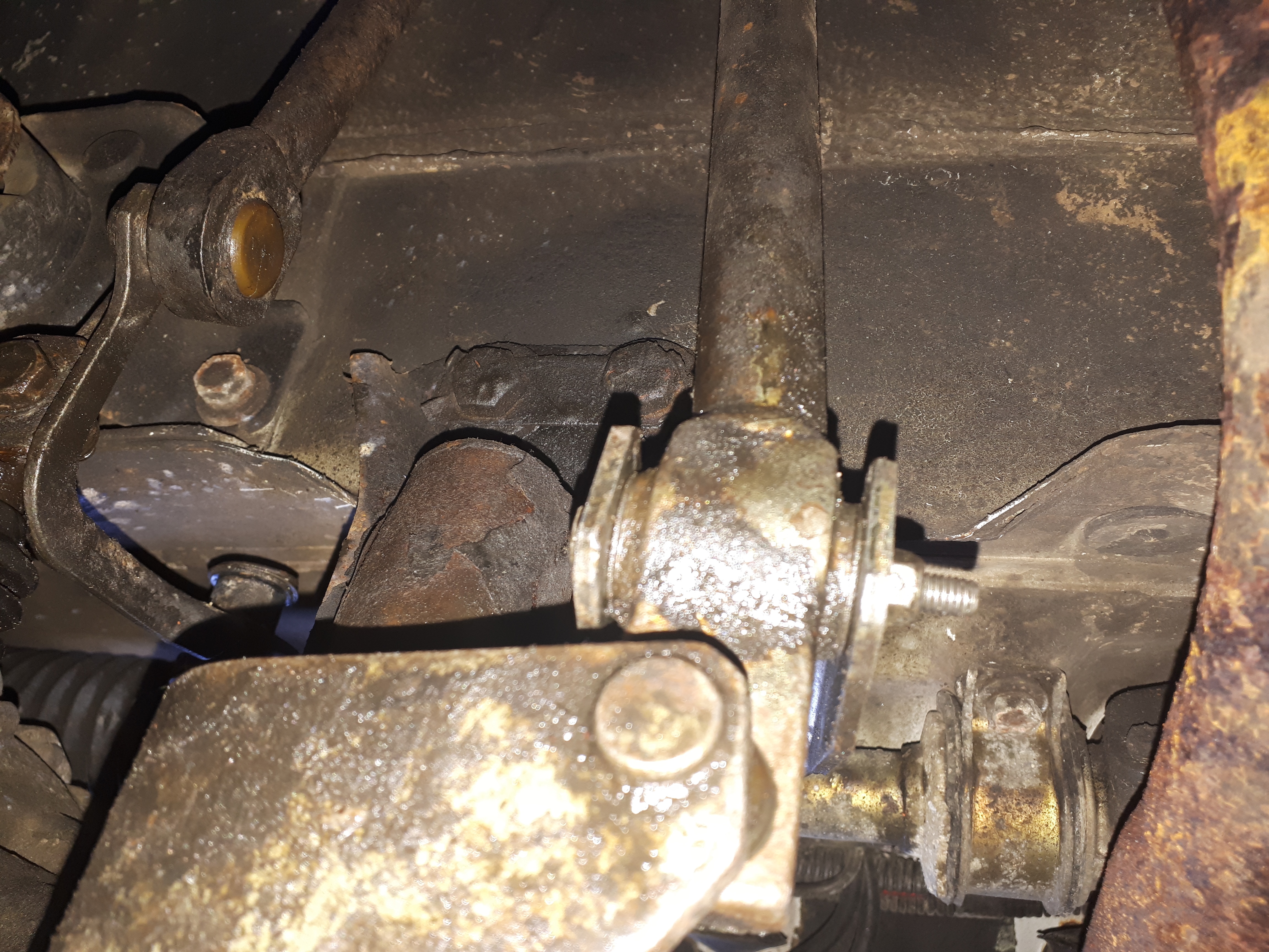

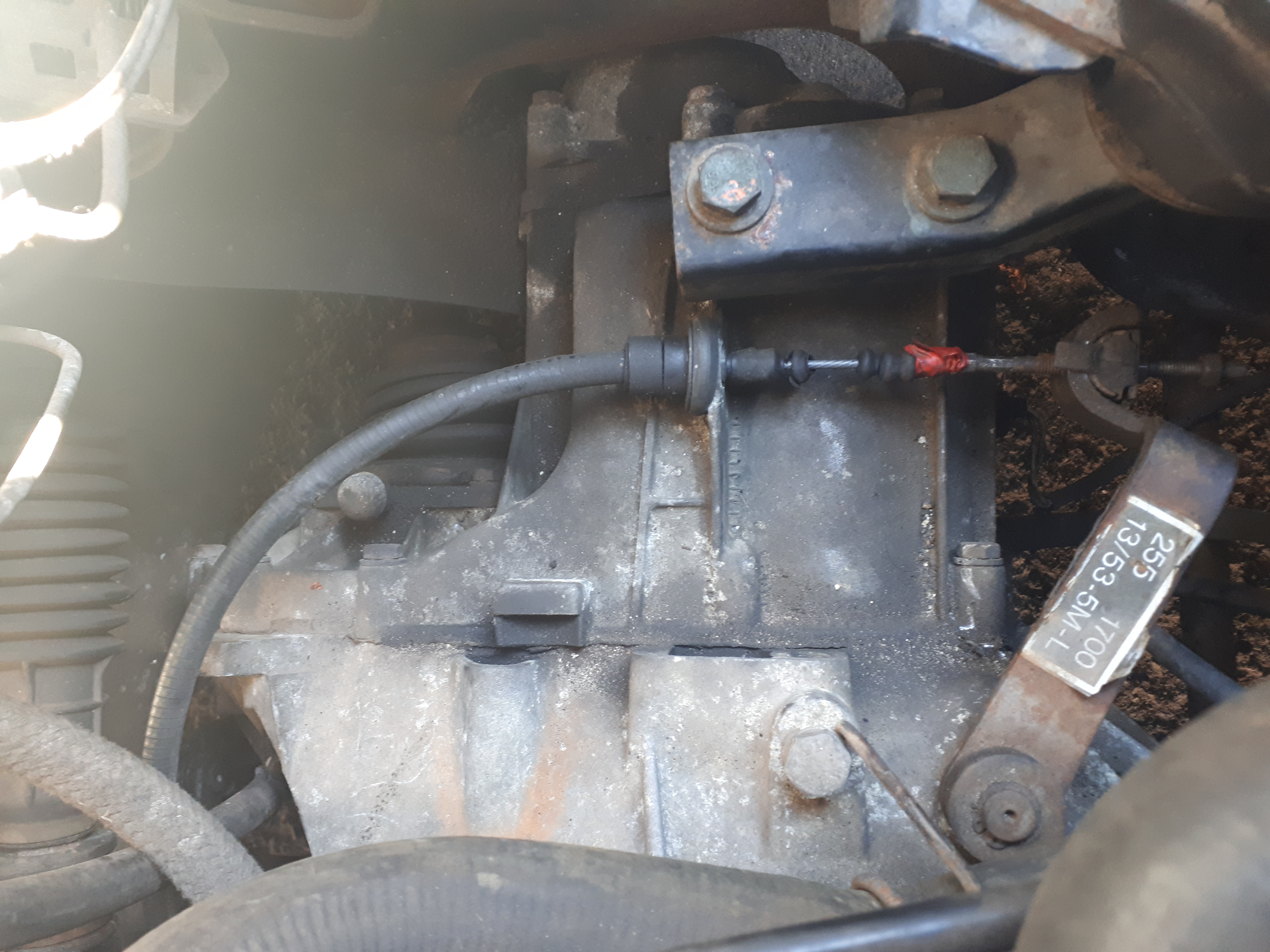

These any better!

Don't know any suppliers,but maybe disconnect rod and place a cut to size (inch by inch square)strong plastic bag/sack over the ball,and refit rod so plastic takes the play out. May last a while,worth a try.

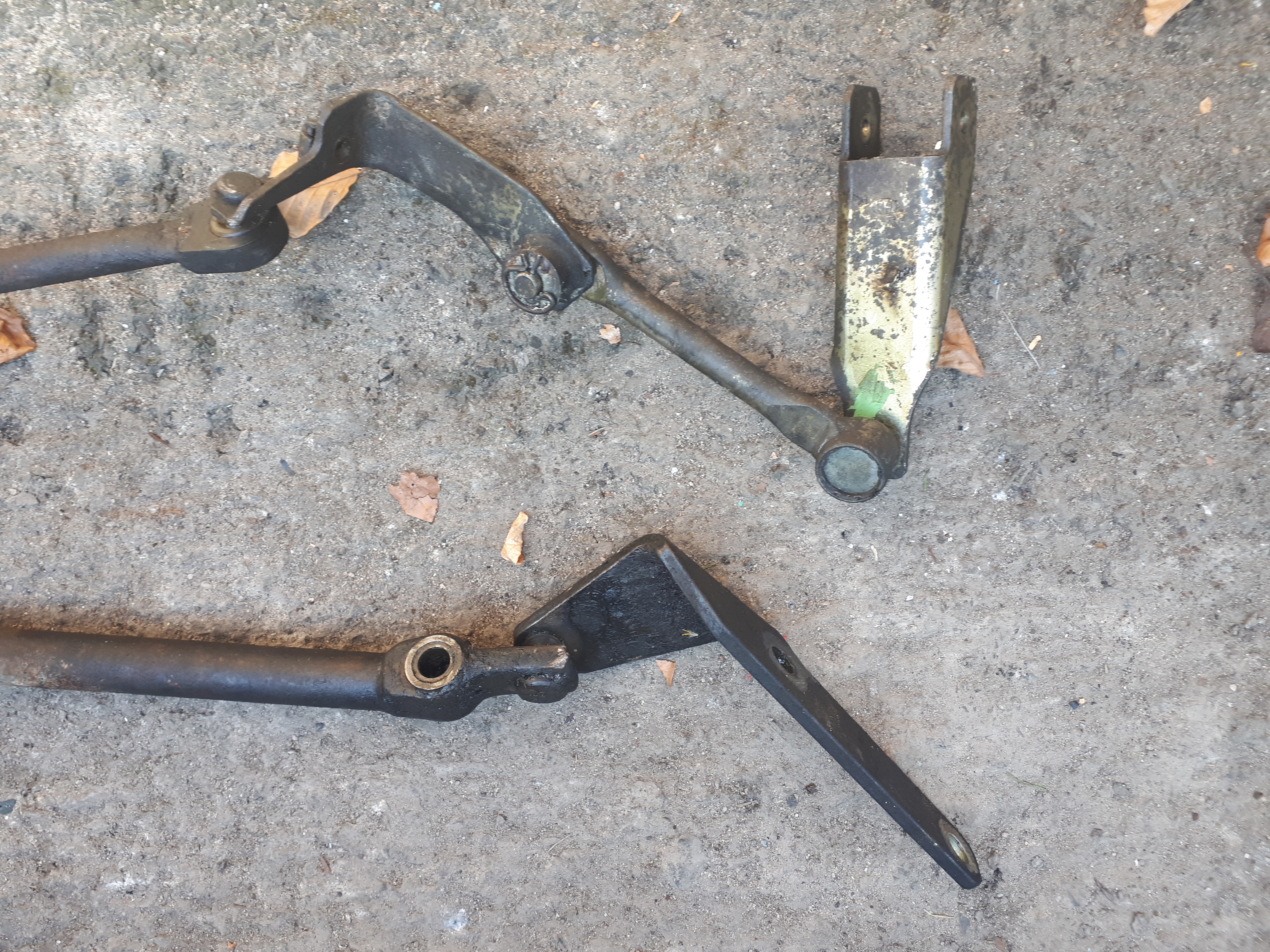

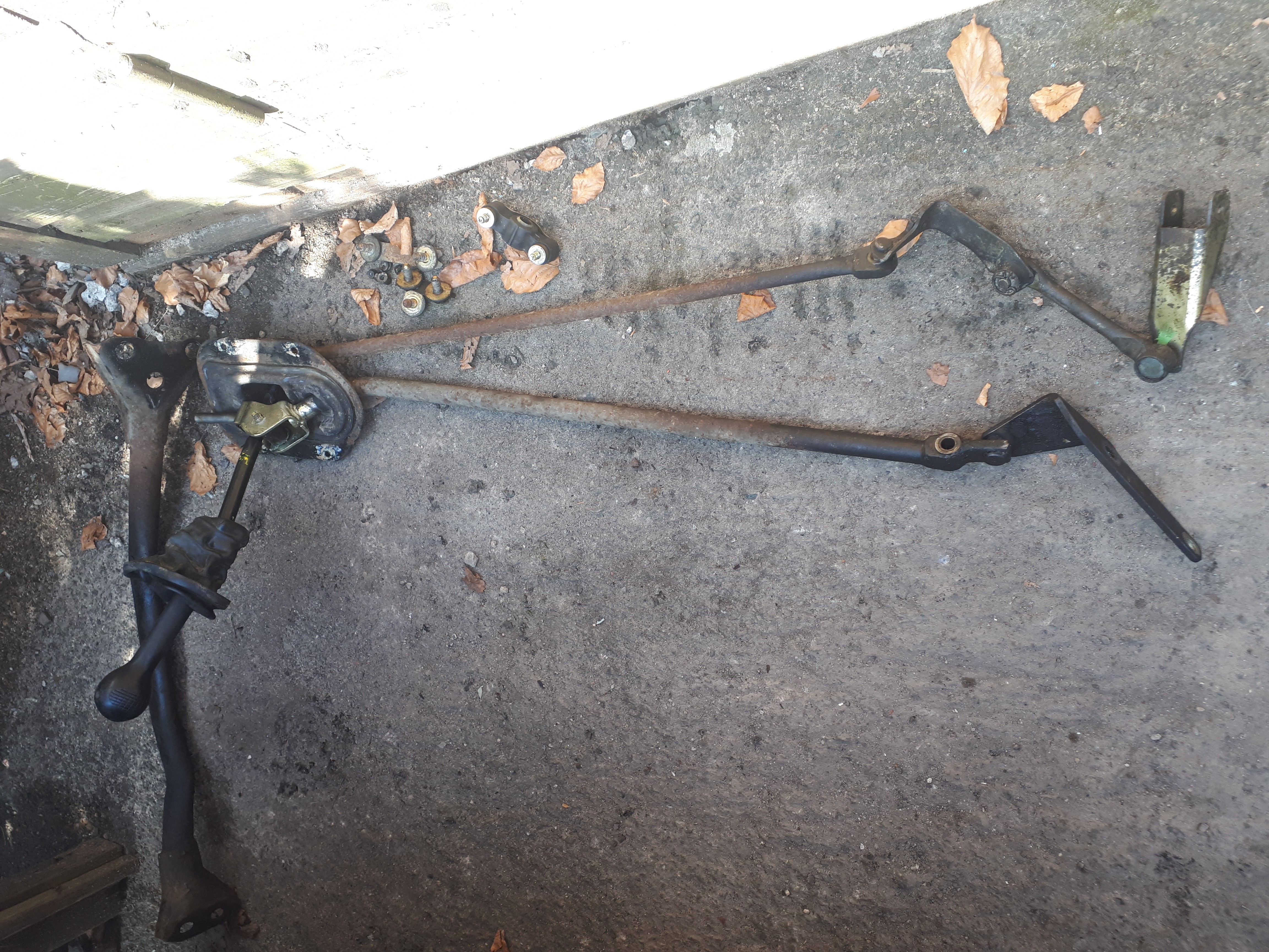

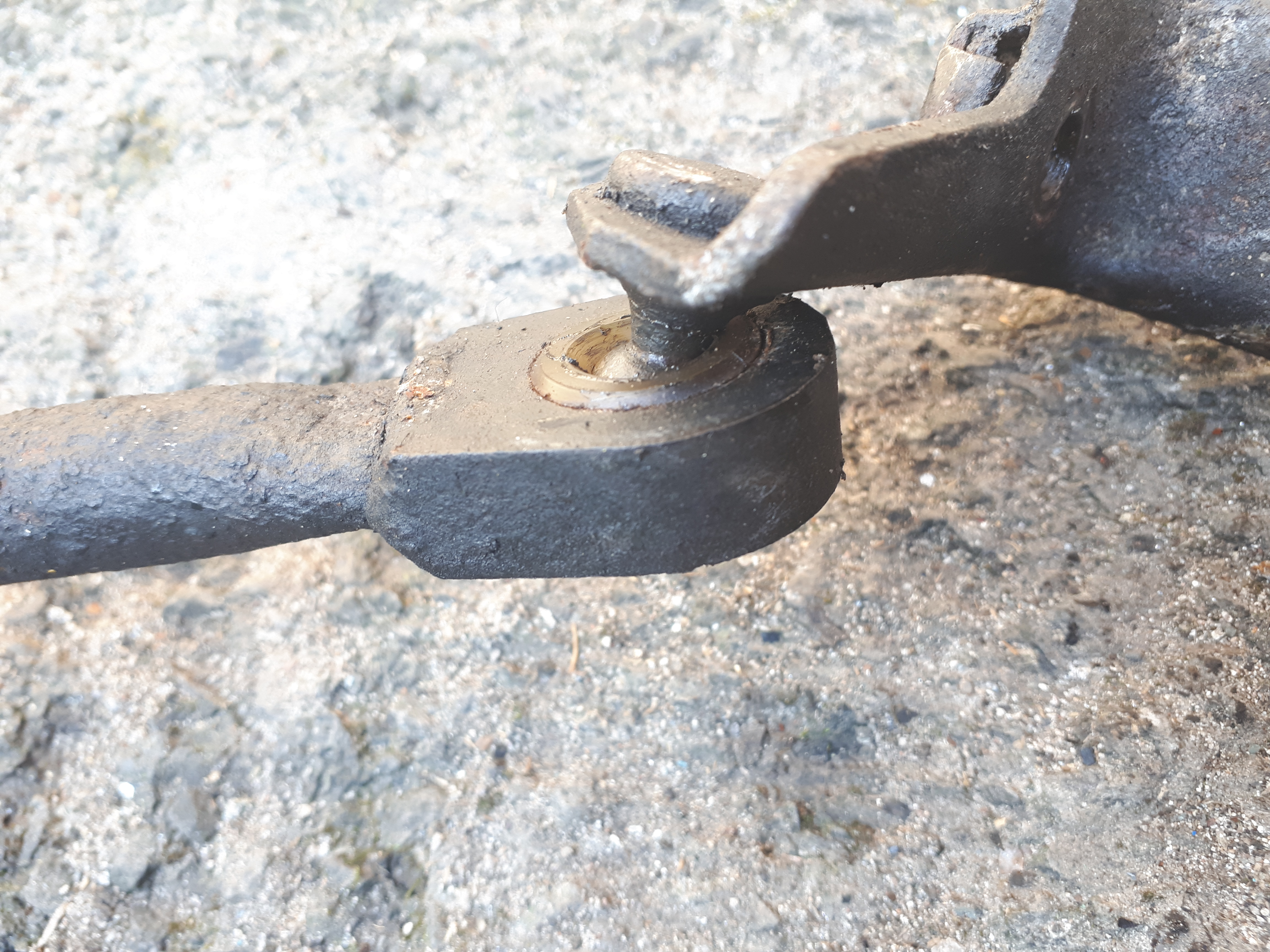

Here's some better pics now I've removed it! The last pic is where it's worn out...all the ball and socket type joints are perished...how the heck do you get replacement parts for this!!!
