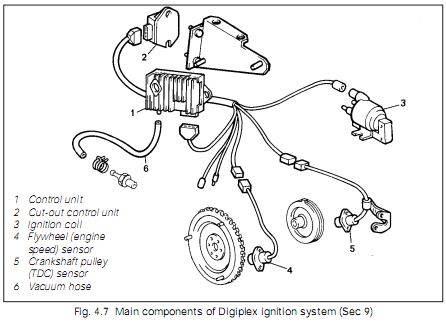

Hi and thanks for answer
But where on this diagram is this "module" you refer to ?
The Distributor is mechanical breaker type on UNO 70 S I.E
Best regards
