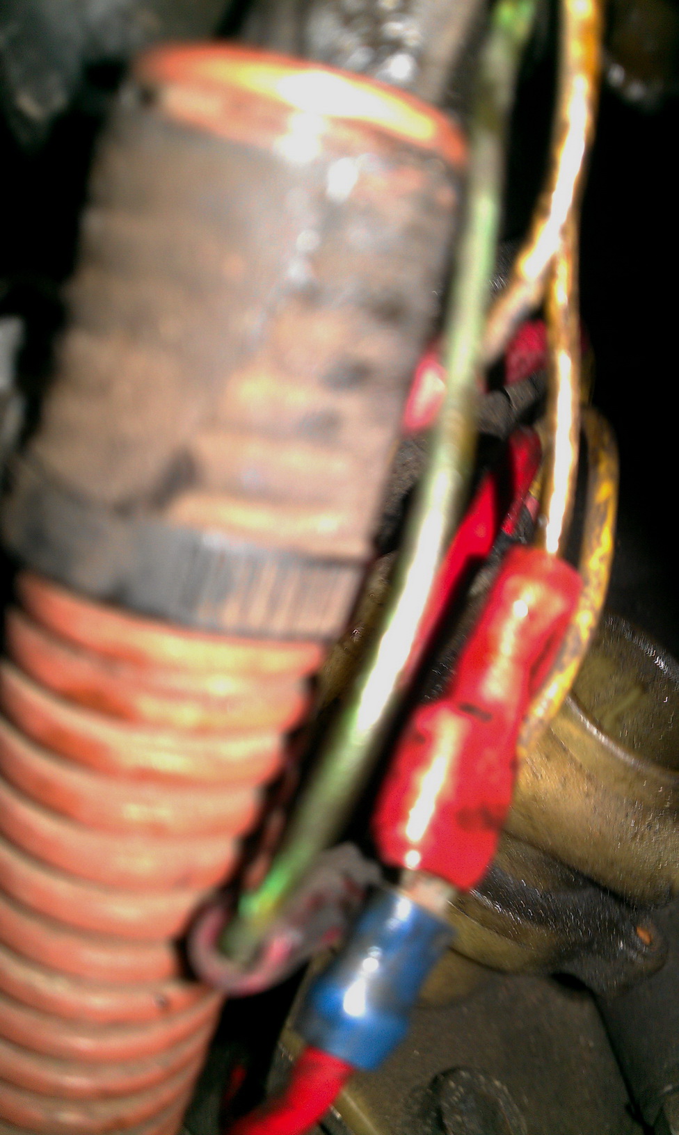

Just had the speedo cluster off and its blue electrical connector and no speedo cable into back of speedo, so I guess its electronic, just trying to find the sensor but not sure if its top or bottom of gearbox?
I managed to find the Vehicle Speed sensor and it looks as though someone has been at this before as some of the wires have been joined with bullet connectors, so I have had a fiddle about with them and will test the speedo later to see if that has done anything, failing that due to its location and accessibility I will take it into a garage and ask them to fit a new speed sensor and sort the wires out.
From your photo, it looks like your problem could be a dodgy connection. On earlier models, the speedo cable enters the gearbox through the circular hole to the right of your sensor connectors, which is blanked off on later models like yours.
