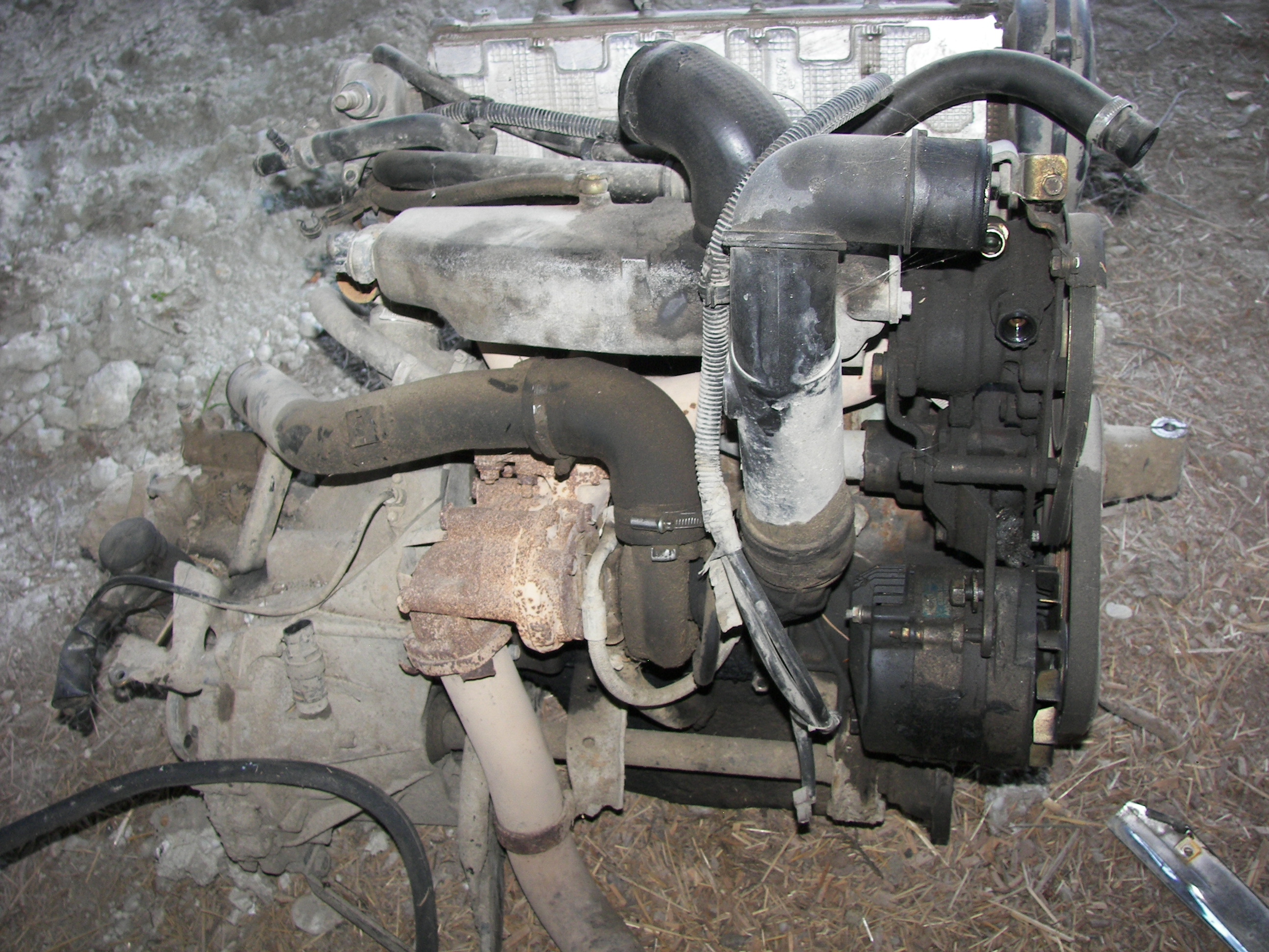

Would like to know if the 1.9 turbo diesel Tipo about 1990 era is direct injection or indirect.

Do some diesel engines have precombustion chambers?, i think this engine is one of those?.
The later Fiat diesel engine as i understand it is direct injection?.
All Diesel engines are direct injection (fuel injected into the cylinder). I think you maybe asking if the engine is a common rail diesel (EFI) which is it not. Later one are.
This diesel has a plain old mechanical injection pump.

The Tipo maunal states that the engine is indirect injection. This term relates to the use of a pre-combusion chambers, which this engine has.
I had understood that you could only use common rail etc with direct injection i.e. no precombustion changer hence modern engines are all direct.
OK so I've lernt something new. I'm no diesel mechanic.
It depends on what your definition of direct and indirect is. It appears diesels have a specific definition for "indirect" injection that I did not know of. i.e. injection into a pre combustion chamber.
In my mind (petrol mechanic) that's still "direct" injection :)
