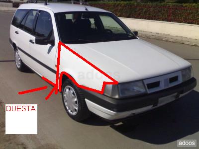

the dashboard of my temper has become sw say "chewy" as a cover?? is there any treatment that you can do or you're forced to buy it again (since the ones I found had the same defect in shambles)??
another question today we had a little accident, since I can do a little bit of body and if I wanted to chide as it is easy to remove the side cover I've attached in the message.
1000 THANKS TO ALL FOR COLLABORATION ;)
