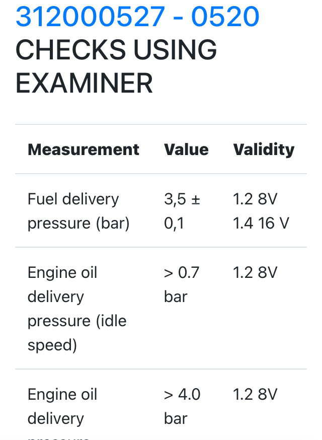

Hi everyone.... my strada 178b7 engine has a rough idle, I went through every possibility...
But I noticed my fuel pressure is at 2.5 bars. My car starts fine and drives fine. But the idling is rough. Is my fuel pressure too low or is that normal for these engines. Thanks
