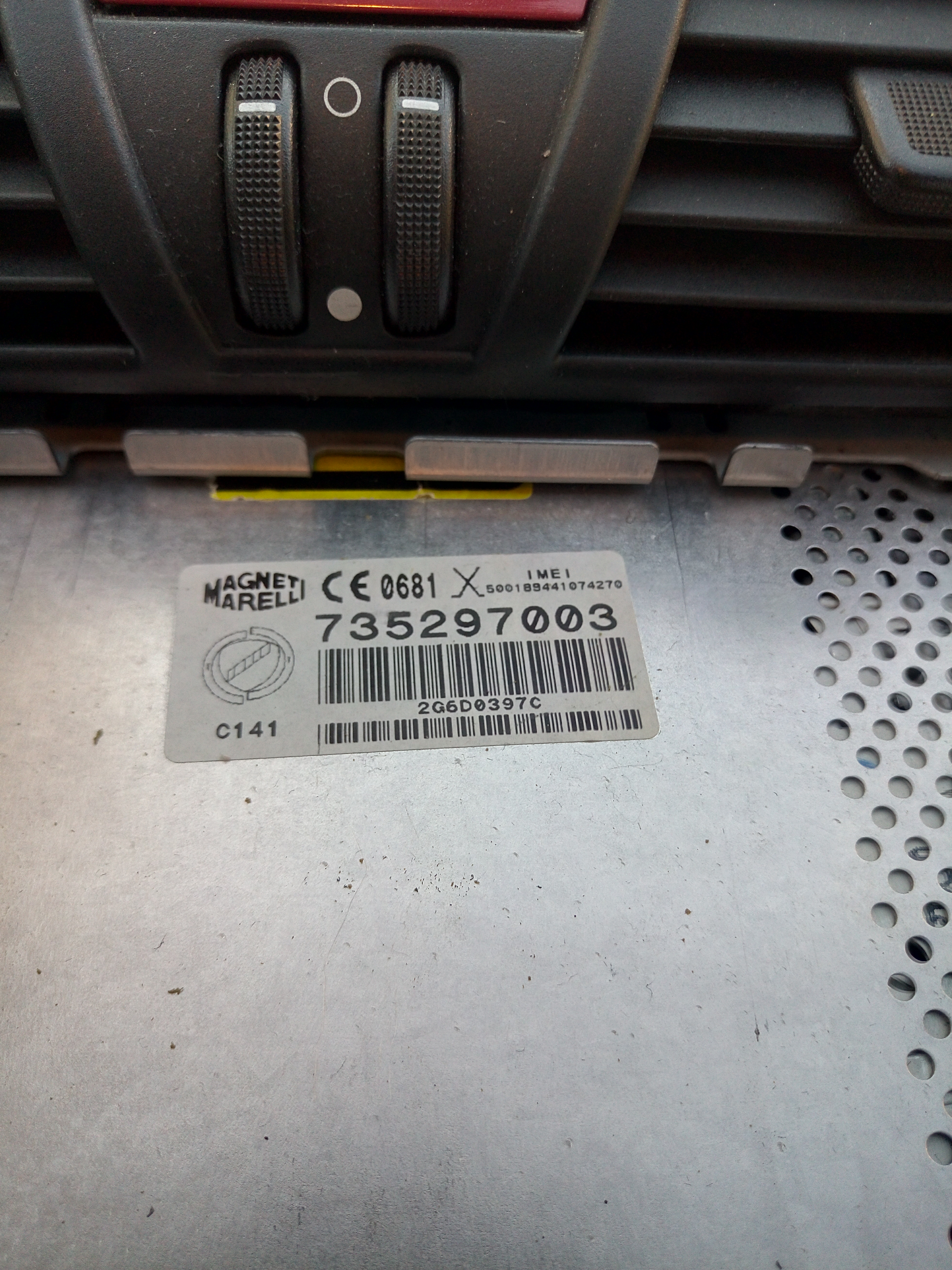

can anybody help resolving the problem.
I need master code for my radio
Magneti morelli
