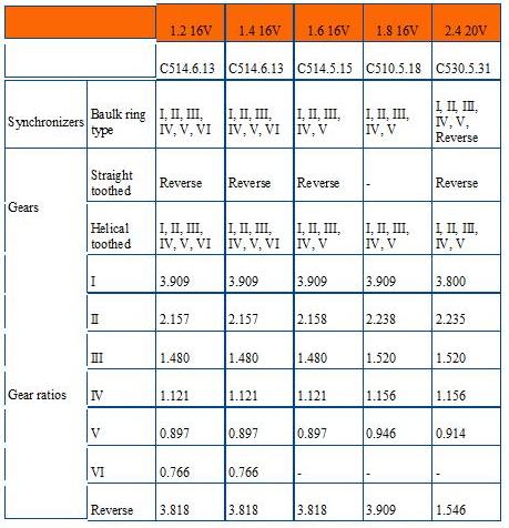

hey, i recently bought stilo 1.8 and i am curious about the gearbox, i am sorry but i don't know the word for each specific number that represent a gear .if you still can't understand me here's an example :
- first gear,second gear,third ..... 0.745-fifth and 3.667 is ***** number dunno the word as i said before..Can someone give me a link so i could see these numbers? It's really important because i am about to change my clutch and i was wandering if i could change 5th gear with a longer one .
