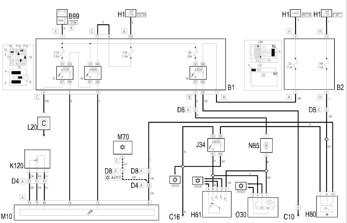

Check relays T5 (20Amp) and T9 (30Amp) in the engine compartment fuse box.
If T5 is stuck on, the air conditioning compressor could be permanently energised.
If T9 is stuck on, the compressor could be permanently energised while the ignition is switched on.

If it's been like it ever since you got the car, perhaps the previous owner bypassed it to make it appear as though it was working.
It may have been bypassed at the pressure switch (K120 in the wiring diagram above). Check for any obvious signs of wiring modification at the switch. It's at the bottom left (looking from the front of the car) side of the engine radiator. Highlighted in the diagram below.

hi mate got an guy looking at ac prob but he wants wiring diagram is the on u sent me for m model is i have the manual ac controls not the digital or is it the same diagram? or do u know where i can download the srvice and repair manual in pdf format?
The wiring diagram I posted above is for the manual controlled version.
