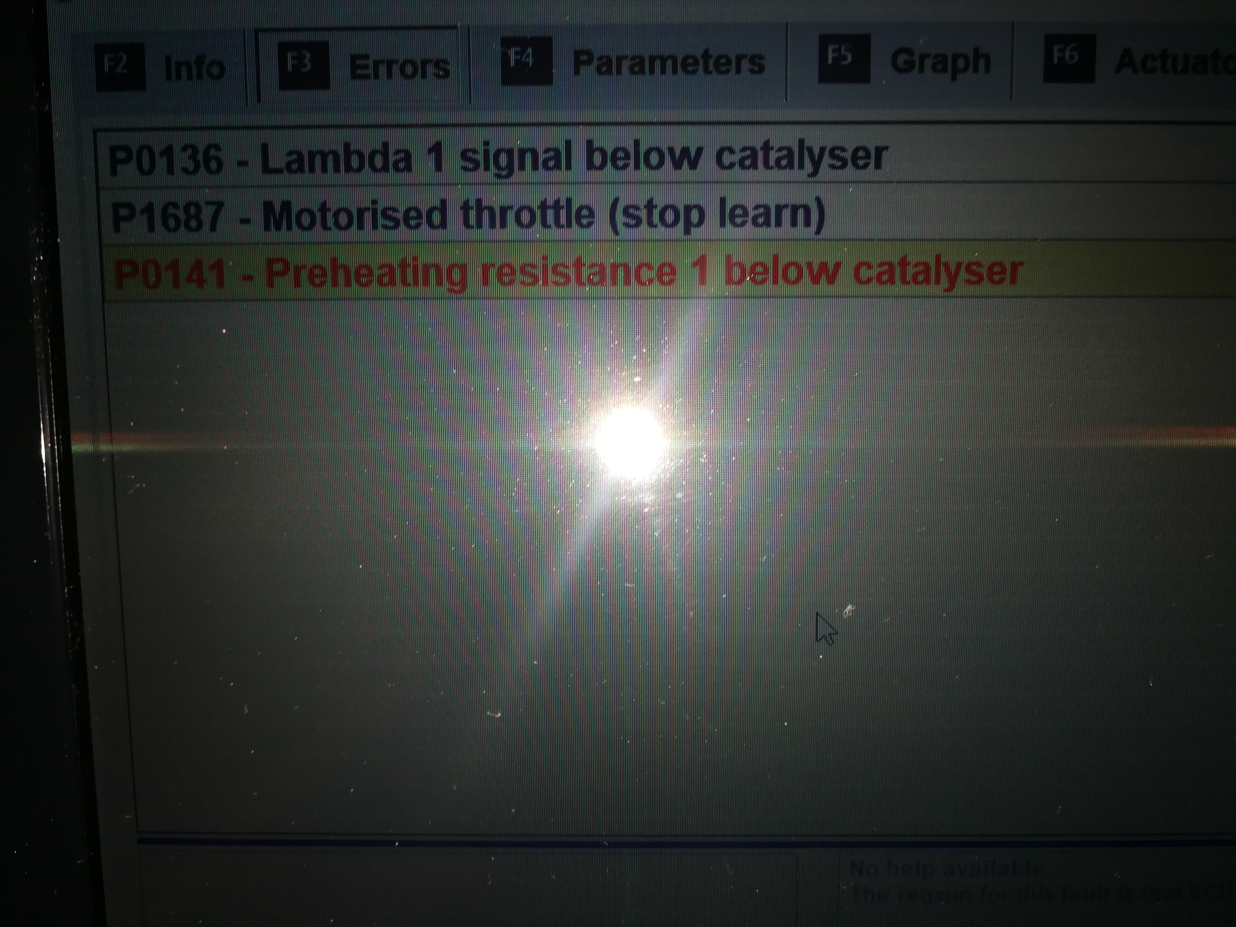

Hello friends,
the engine light is on at my Fiat Stilo 1.6 16V 2002. Just did the scan through Multiecuscan and had this new failure: Code P0141 Preheating resistance 1 below catalyser.
where is this sensor located to change it ?
Can drive tomorrow before fixing it?
please help

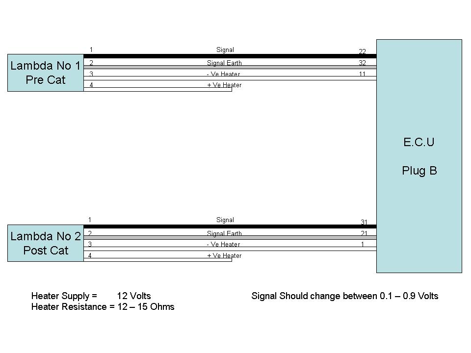

It is the second catalyst after the catalyst, the error indicates that the heating resistance of the probe does not work.
If you have a measuring device you can measure the resistance on the two white wires of the probe to be between 12-15 ohm according to the photowiring Lambda.jpg
You can safely replace it with a new one, and do not forget to clear the error.
If you have a measuring device you can measure the resistance on the two white wires of the probe to be between 12-15 ohm according to the photoView attachment 198597
